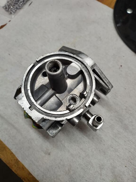

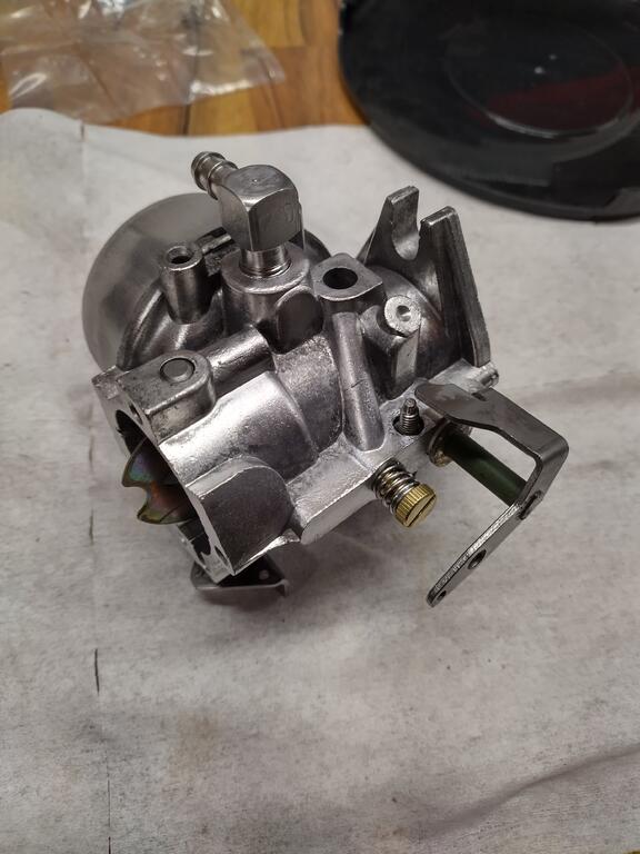

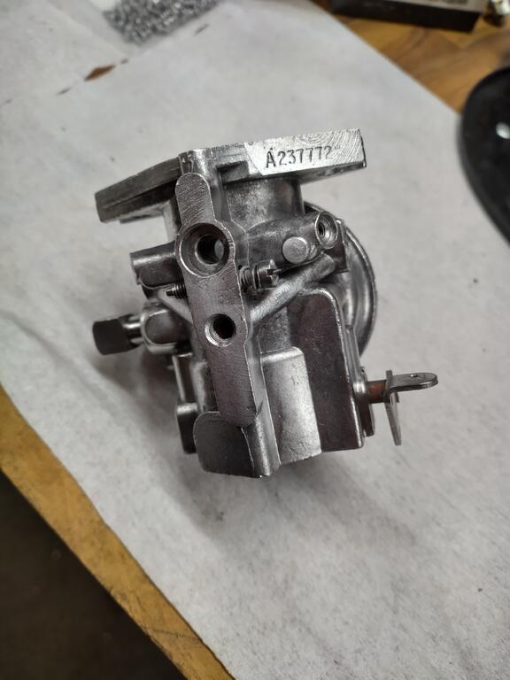

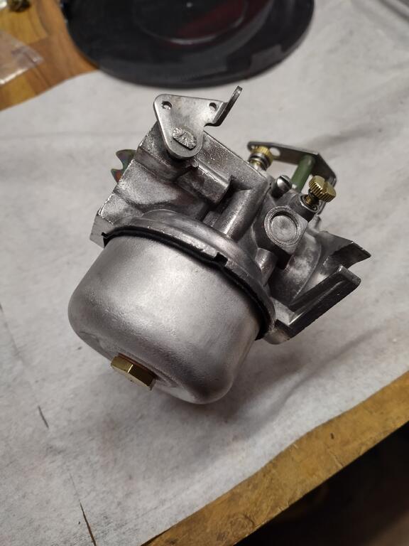

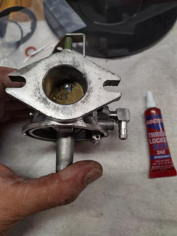

ebinmaine 79,729 #54 Posted June 20, 2023 On 5/31/2023 at 2:36 PM, ebinmaine said: Either do that or send me the ORIGINAL carb. I'll rebuild it and send it back to you. After multiple sessions in the ultrasonic cleaner this one's ready to go. 2 2 Share this post Link to post Share on other sites

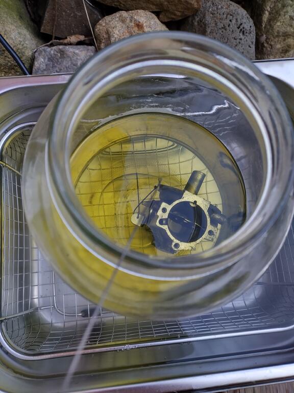

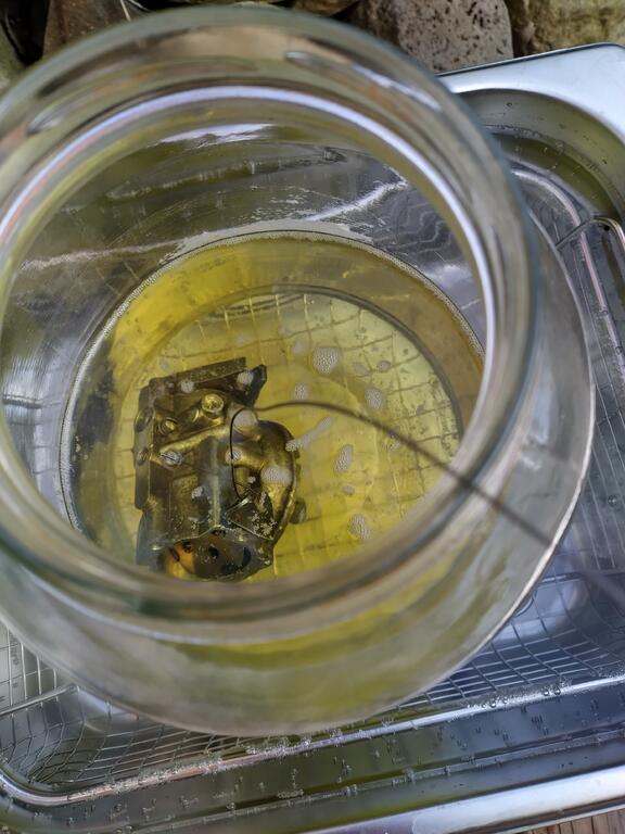

pfrederi 20,883 #58 Posted June 24, 2023 On 6/20/2023 at 7:30 PM, ebinmaine said: After multiple sessions in the ultrasonic cleaner this one's ready to go. Eric what do you use fro solvent/cleaning agent in the ultra sonic cleaner. i used purple power but it seriously discolored the carb body and every time you touched it you got gray on your fingers. 2 Share this post Link to post Share on other sites
ebinmaine 79,729 #59 Posted June 24, 2023 11 minutes ago, pfrederi said: Eric what do you use fro solvent/cleaning agent in the ultra sonic cleaner. i used purple power but it seriously discolored the carb body and every time you touched it you got gray on your fingers. I tried using a product called Incredible Pink. That worked well but left the film you speak of. The pics above are when I used gasoline. I found that to be a good solution. 1 Share this post Link to post Share on other sites
HyperPete 939 #60 Posted July 8, 2023 My $0.02: Purple power is strongly alkaline and should not be used on aluminum. Gas has a low flashpoint and terrible fumes. I like mineral spirits. Much higher flashpoint, very little odor, and works just about as well as gasoline. 1 Share this post Link to post Share on other sites
