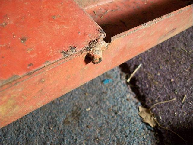

wheeledhorseman 579 #1186 Posted January 9, 2014 (edited) Ian, thought of your comments re welding while I was working on my dump cart yesterday and I think we are sometimes a little over critical of our own work. To illustrate here's a factory weld I found on the frame. The strengthening plate is supposed to lie squarely and flush on top of the main frame rail but somehow had moved when the first welds were done leaving a gap to be bridged on this one. So much for any quality control. In the same position I think I might have at least ground the excess off rather than leaving it to be painted over. Andy Edited January 9, 2014 by wheeledhorseman Share this post Link to post Share on other sites
