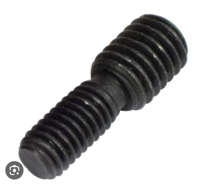

Rick3478 454 #29 Posted June 7, 2023 2 hours ago, John2189 said: If you go the next size bigger bolt route, I think I’d use fine thread I don't think I'd do fine threads in aluminum, given its tendency to gall and chew up. Insert or stud, then maybe. Share this post Link to post Share on other sites
csvt99 173 #30 Posted June 7, 2023 I can't picture what type of stud you are referring to. Below is a picture of the factory bolt, not sure if it is considered fine or course. I'm leaning towards doing the inserts on all holes just for consistency, especially if the inserts make it stronger. I would hate to get it all back together and then end up with the same issue again. Thanks! Share this post Link to post Share on other sites

John2189 594 #32 Posted June 7, 2023 This is a step stud Sounds like you are more comfortable with using the hel icoil 2 Share this post Link to post Share on other sites
csvt99 173 #33 Posted June 7, 2023 15 minutes ago, John2189 said: This is a step stud Sounds like you are more comfortable with using the hel icoil For this application I'm not sure that it would work due to clearance issues, depending on sizes available. I will try what have and go from there. Who knows I could end up going this route. Thanks for the suggestion. Share this post Link to post Share on other sites

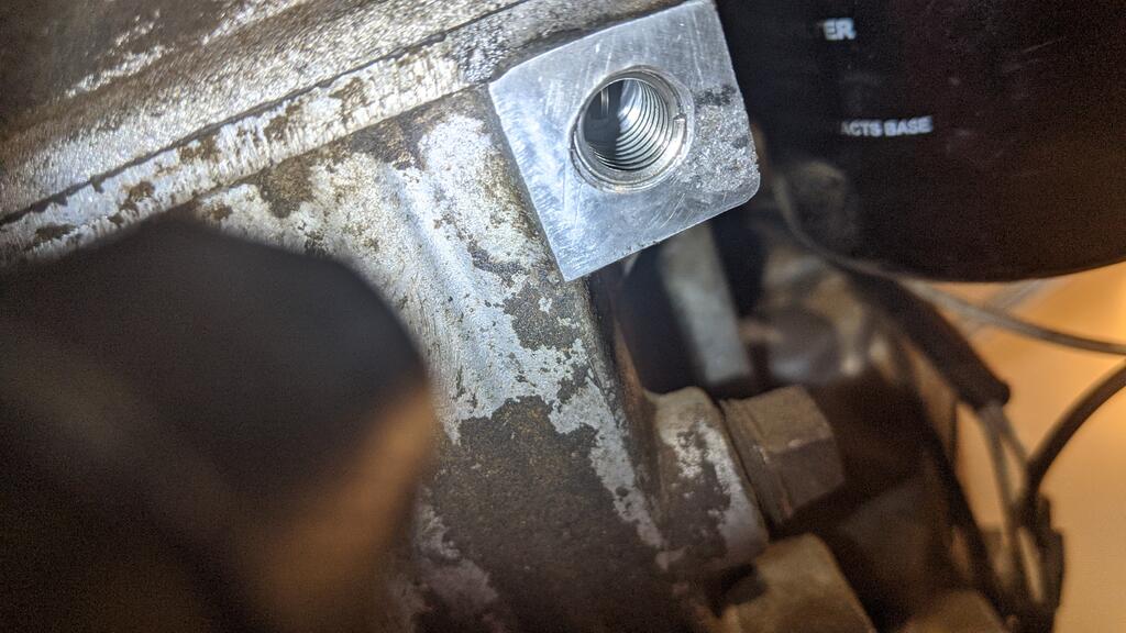

csvt99 173 #36 Posted June 9, 2023 I got the first one heli coiled and working on the second. The other two holes seem to have clean threads so I'm thinking of leaving those alone. I like the idea of the stronger heli-coils in there but don't really want to risk fixing something that isn't broken. I'll get some pics up in time. 1 Share this post Link to post Share on other sites
csvt99 173 #37 Posted June 9, 2023 I ended up heli coiling two which were catacorner to each other and salvaged the others as they still had decent threads. Put a little lok tite on and tightened down to 30 lf pounds. Hopefully this fixes it for good. 1 1 Share this post Link to post Share on other sites
csvt99 173 #38 Posted June 13, 2023 I got everything back together and mowed on Saturday. Just in time because it finally rained yesterday! Thanks for all of your help 4 1 Share this post Link to post Share on other sites
