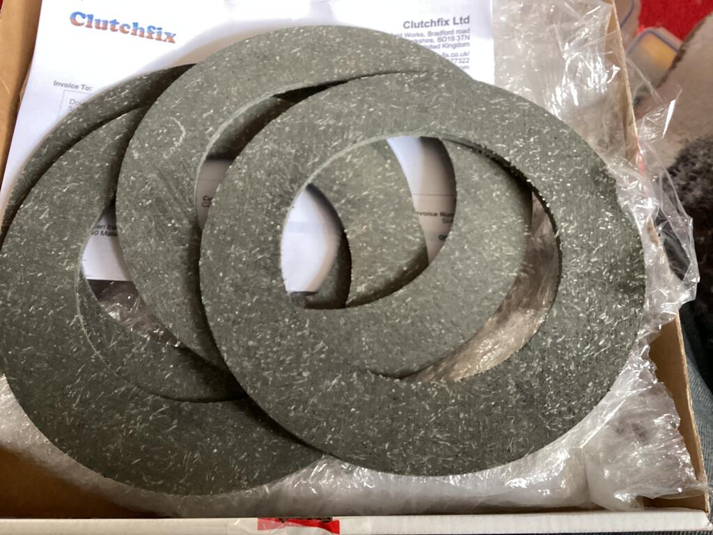

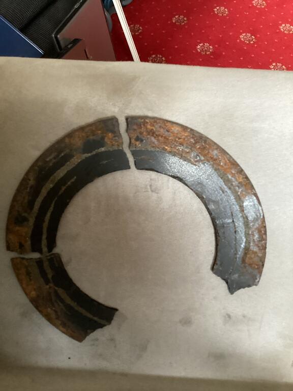

ranger 1,834 #1 Posted May 22, 2023 (edited) This post is primarily aimed at members in the UK. I’ve been on the lookout for a source of PTO clutch linings this side of the pond. I found a company that supplies all kinds of bespoke clutches etc for classic vehicles etc. I’ve just ordered some 6 3/4” linings for around $10 each + tax etc. I realise you have sources of your own over in the States, but, over here things are not quite so plentiful. For UK members the name of the company is, Clutchfix ltd. They have a website. They supply to dimensions supplied by the customer. In my case, 171x108x4mm. Material RF40, suggested adhesive Araldite. Photo = reason for requirement 🙀 Doug. Edited May 22, 2023 by ranger 4 Share this post Link to post Share on other sites
ranger 1,834 #2 Posted May 25, 2023 New linings just arrived, although yesterday I ‘re-glued’ the lining on the C161 pto, which was almost off when I bought it. Still I have some more clutch plates I can now ‘Reline’. 1 Share this post Link to post Share on other sites
