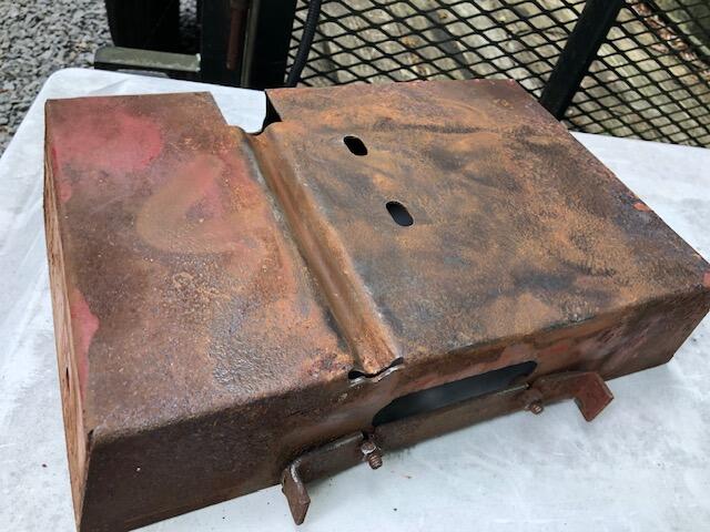

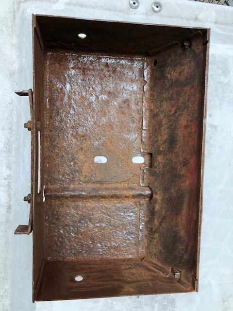

Sailman 1,305 #1 Posted May 20, 2023 So after years of no "round hoods" in my region I scored a survivor 704 that will need a lot of work. Just before Christmas I landed an "original" unmolested 701 complete with all correct belt guards. Seller said it had been a worker in his family as long as he could remember but spent the last 10 years in a storage building. While I have a tremendous respect and awe for the restorations I see folks on here do....what I want is a "preservation" on the 701. The patina is so nice I just want to keep the tractor in as original condition as possible. I have a few questions for the experts. 1. I have found taking a dab of 3M rubbing compound and very damp rag helps do the deep clean after the first cleaning. While it removes hardly any paint I find it cleans the grunge, actually brings back a bit of a shine and allows the paint to absorb the aerosol oil treatment. Anybody have comments pro or con? 2. There are some bolts that will have to be replaced. Is over the counter bolts an issue or do I need to track down OEM bolts? 3. I have a few parts (primarily the tool box and seat support that were pretty rusted. I have cleaned up the rust and they are solid underneath but what should I do to restore? New paint?...clear coat over the metal?....ideas? Pictures are of the 3M rub on one side of the fender, Gen guard belt after rub down and oil treatment and last 2 are the badly rusted parts. All suggestions appreciated! 1 3 Share this post Link to post Share on other sites

Tonytoro416 1,295 #7 Posted May 21, 2023 I’m far from an expert on anything really but my dad has done body work and paint my entire life. And personally the toolbox and that where you have pitted rust I would try to seal up with something. My dad has always described rust like cancer. If not sealed up or cut out and sealed up or killed IT WILL spread. He is one of few actual body men I know of left. Most people in body shops now are panel replacers. My dad come from the era of using lead on vehicles 1 1 Share this post Link to post Share on other sites

Sailman 1,305 #9 Posted May 21, 2023 9 hours ago, Tonytoro416 said: I’m far from an expert on anything really but my dad has done body work and paint my entire life. And personally the toolbox and that where you have pitted rust I would try to seal up with something. My dad has always described rust like cancer. If not sealed up or cut out and sealed up or killed IT WILL spread. He is one of few actual body men I know of left. Most people in body shops now are panel replacers. My dad come from the era of using lead on vehicles Good advice. Do you think a couple coats of the penetrol would do it or something more like a clear coat? I see a lot of rat rods using penetrol over rusted parts. 1 Share this post Link to post Share on other sites
