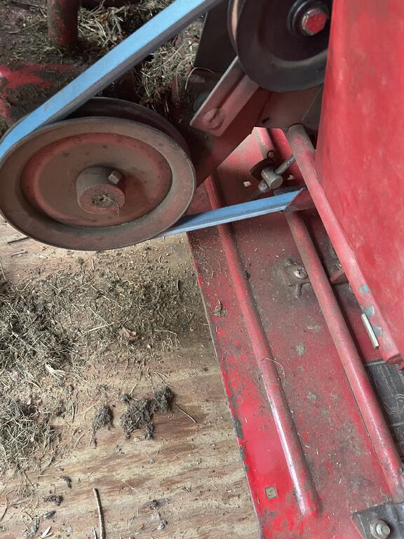

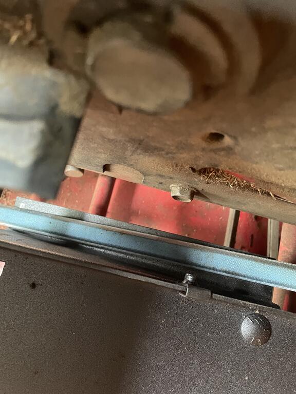

tallen4392 71 #1 Posted May 20, 2023 Does anyone know if the drive belt on a 312-8 sits on top of the foot board little piece that sticks out I can't see any way that it would not but does not look right I installed a new belt and it look like that is how it goes any idea if that is correct Share this post Link to post Share on other sites
953 nut 64,269 #2 Posted May 20, 2023 With the clutch depressed the lower portion of your drive belt should rest on the lower belt guide of your belt guard. 1 1 Share this post Link to post Share on other sites
tallen4392 71 #3 Posted May 20, 2023 when the clutch pedal is not depressed the belt sits on the inside of the floorboard just want to be sure that is correct Thanks trying to upload a picture but can’t seem to do it Share this post Link to post Share on other sites
953 nut 64,269 #4 Posted May 20, 2023 To upload a picture just click on the choose files... at the lower left of your post as it is being composed. That will take you to the photo file on your computer and you can select the photo you want to add. 1 Share this post Link to post Share on other sites
oldlineman 1,654 #6 Posted May 20, 2023 That looks correct, the belt guard lip supports the belt when clutch is pushed so the belt will slip on the engine pulley. Share this post Link to post Share on other sites
