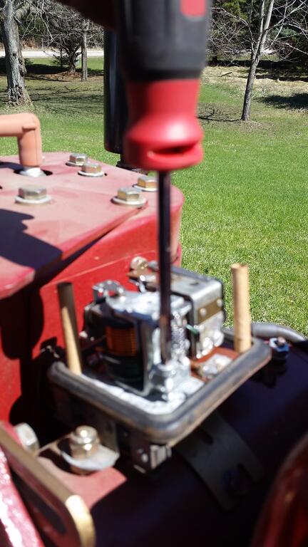

WHX?? 55,700 #3 Posted May 19, 2023 This screw here Mike. Make sure you have 1/2 to full throttle on. Use your DMM. Doesn't take much of a turn to change it. 2 3 Share this post Link to post Share on other sites
Mike'sHorseBarn 3,429 #4 Posted May 19, 2023 3 minutes ago, WHX?? said: This screw here Mike. Make sure you have 1/2 to full throttle on. Use your DMM. Doesn't take much of a turn to change it. Thank you sir! That's exactly what I wanted! Screw in or out to decrease voltage? 1 Share this post Link to post Share on other sites

Achto 31,310 #7 Posted May 19, 2023 4 hours ago, Mike'sHorseBarn said: Screw in or out to decrease voltage? I believe that it is out to decrease voltage. A little touch can move the voltage a long way. Like @Handy Don mentioned, don't trust your analog gauge on the tractor. Always use a multi-meter. 3 Share this post Link to post Share on other sites
WHX?? 55,700 #8 Posted May 19, 2023 Long as the cover is off I clean the contacts up with an ignition file, lint free rag and contact cleaner. 4 1 Share this post Link to post Share on other sites

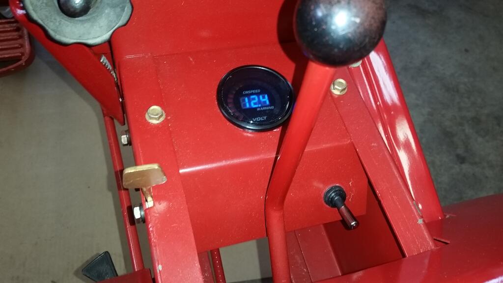

WHX?? 55,700 #9 Posted May 20, 2023 (edited) 7 hours ago, Mike'sHorseBarn said: Thank you sir! That's exactly what I wanted! Screw in or out to decrease voltage? I don't remember but Dan might be right. Play with it like Don said. Just make sure the R's are up and you monitor it over several minutes. 1055 custom has a somewhat accurate digital gauge which jives with the DMMs I have. I set on the 12.5 volt which doesn't seem to cook batteries & runs up to 13.5 once things get hot. If you have the more expensive automotive post type battery in your 1067 you want that one to last. Good reminder to check mine again since most are SG. Edited May 20, 2023 by WHX?? 4 1 Share this post Link to post Share on other sites
Mike'sHorseBarn 3,429 #10 Posted May 20, 2023 20 hours ago, WHX?? said: If you have the more expensive automotive post type battery in your 1067 you want that one to last. I do, that's why I want to get it adjusted before I burn the battery. I was planning on starting it up and running them around a bit to get them good and hot before I start my adjustment. 2 2 Share this post Link to post Share on other sites

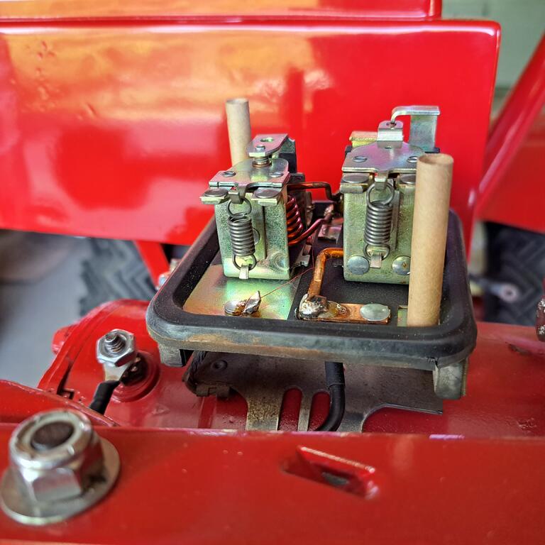

WHX?? 55,700 #16 Posted May 29, 2023 This particular reg is a Borg Warner and has no adjusting screws other than bending the spring tabs on the relays. Share this post Link to post Share on other sites
pfrederi 20,060 #17 Posted May 29, 2023 On 5/26/2023 at 9:07 AM, lynnmor said: Be sure to polarize the regulator, the procedure can be found in the files in post #2. Not really necessary. A starter generator is polarized when you try to start it...as you are applying batter voltage directly to the Armature terminal...same as jumping bat to Gen on the regulator itself as described in the manual . 3 1 Share this post Link to post Share on other sites
Mike'sHorseBarn 3,429 #18 Posted May 29, 2023 7 hours ago, WHX?? said: This particular reg is a Borg Warner and has no adjusting screws other than bending the spring tabs on the relays. I was just gonna google this because that's what mine looks like!! Share this post Link to post Share on other sites
Handy Don 16,057 #19 Posted May 29, 2023 10 hours ago, WHX?? said: This particular reg is a Borg Warner and has no adjusting screws other than bending the spring tabs on the relays. Mine isn’t adjustable either. I’m going to try putting shims under the spring ends instead of bending the tabs. Share this post Link to post Share on other sites
Mike'sHorseBarn 3,429 #20 Posted May 29, 2023 17 minutes ago, Handy Don said: Mine isn’t adjustable either. I’m going to try putting shims under the spring ends instead of bending the tabs. I bent the tabs and got it adjusted to 13.5. The other one was adjustable. 2 Share this post Link to post Share on other sites
WHX?? 55,700 #21 Posted May 29, 2023 It was what came on a 701 Mike. Sure it's been replaced. Cover was dicked up but clean inside. 13 5 /13 6 is ideal Share this post Link to post Share on other sites
