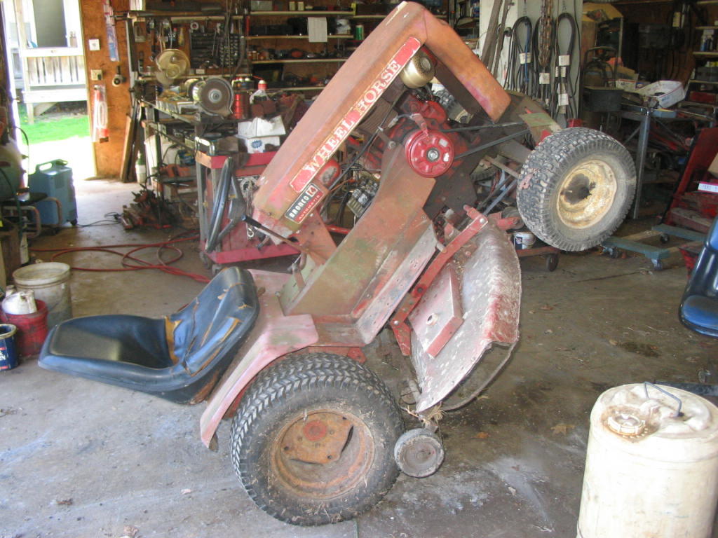

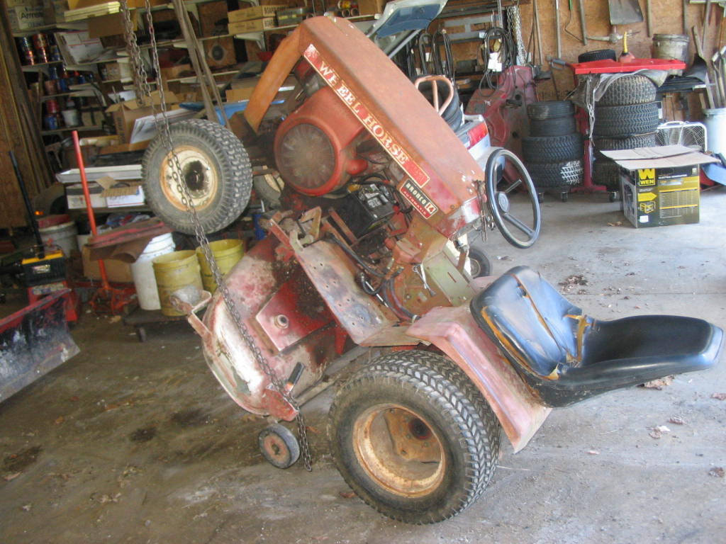

daveoman1966 3,882 #4 Posted May 17, 2023 I've used a 1-1/2 ton chain falls for years.... works great. 1 Share this post Link to post Share on other sites

daveoman1966 3,882 #7 Posted May 18, 2023 7 hours ago, Wayne0 said: Show off! Yeah... I know. Picked it up at a local auction about 25+ years back...but it was new. Sure as H never paid more that a 'C' note for it. I've pulled engine/trans combos with it too. It hangs on a 1/2" link chain looped on a 2" pipe... across 3 double-2x6 stringers in my garage. I've whacked my head on the hook more than once.... lol. Share this post Link to post Share on other sites

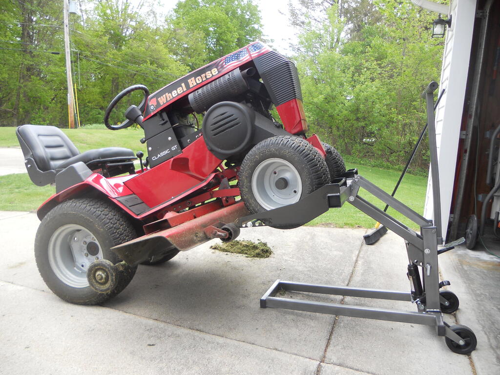

Racinbob 12,812 #8 Posted May 18, 2023 I use this HF version of the Mojack. Most often it's just to remove the wet clumped grass but at blade changing time too. 2 Share this post Link to post Share on other sites

Racinbob 12,812 #12 Posted May 19, 2023 11 hours ago, lynnmor said: I had a Harbor Freight jack, my 520's broke the weldment under the hydraulic jack and pushed it to the ground. In my opinion, those jacks are only for box store disposable mowers. Sorry you had trouble with yours. Hopefully nobody was hurt. I've had mine for quite a while and use it a lot. No issues. I consider it one of the better buys in a store full of some iffy tools. Share this post Link to post Share on other sites
