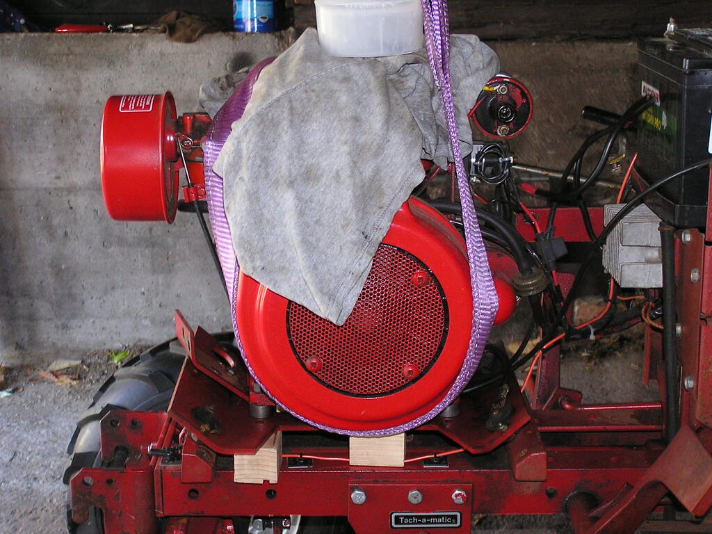

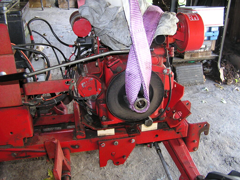

squonk 44,975 #3 Posted May 16, 2023 I have heard about issues getting things aligned. I have never done it. I think if you had a hoist you could lift the engine about 6 inches with out unhooking everything and replace the mounts all at once Share this post Link to post Share on other sites

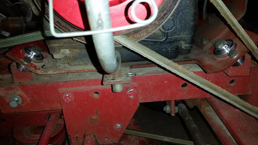

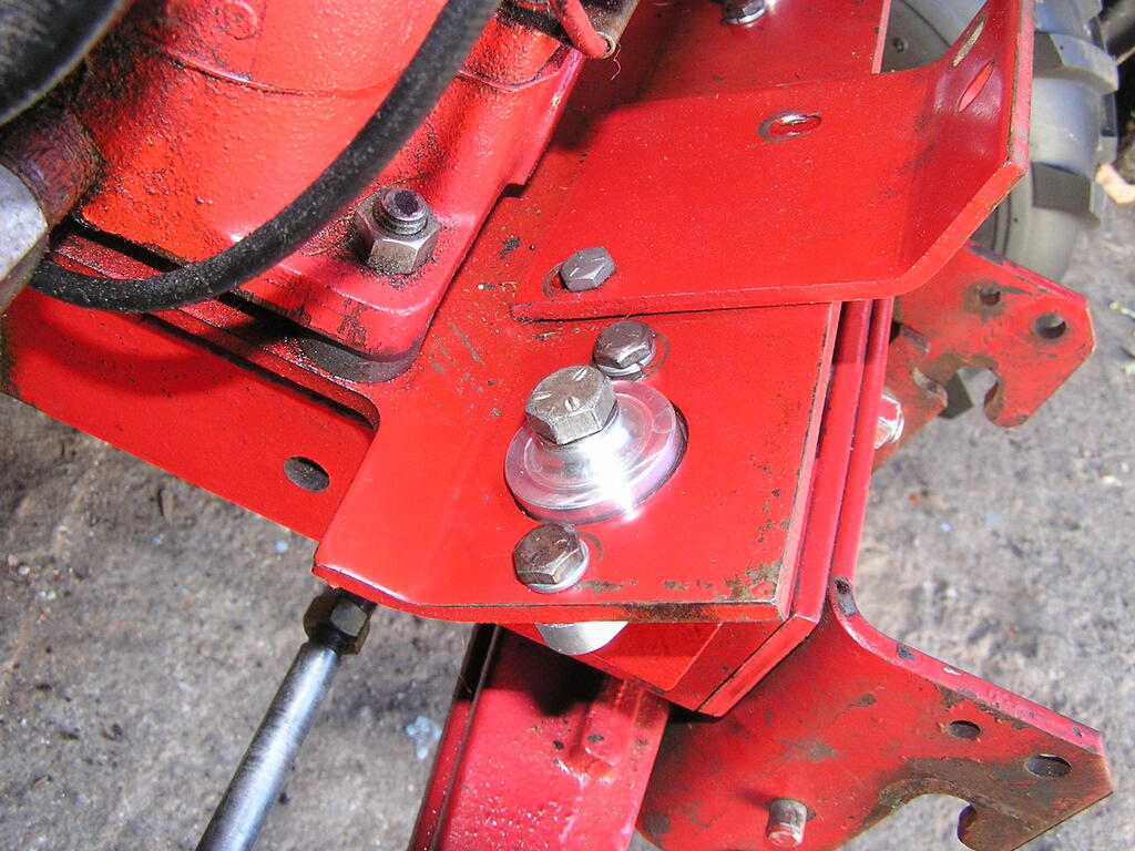

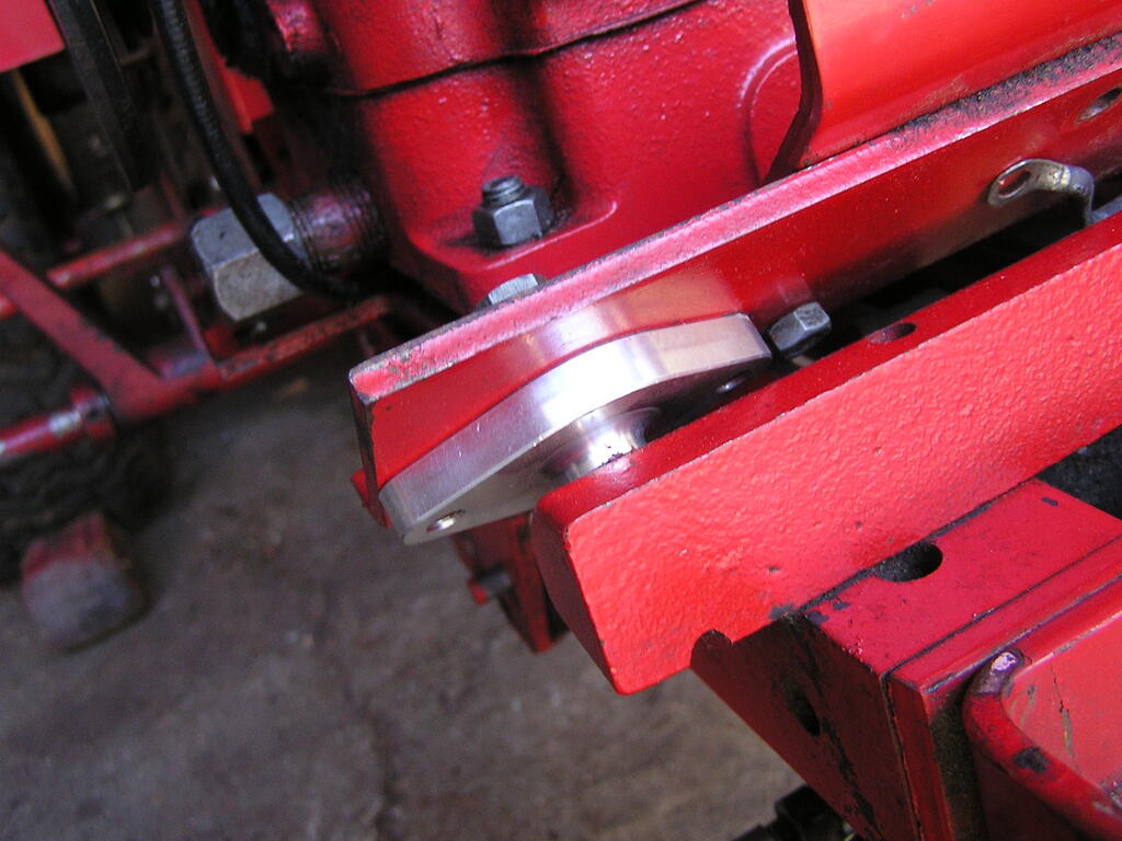

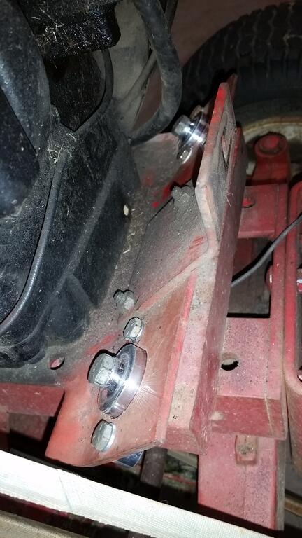

WHX?? 53,454 #4 Posted May 16, 2023 (edited) Easy peasy Cas you'll have no problem. Motor does not have to come off the blocks or plate Take the deck/drive belts off. Loosen all the mounting bolts Start at one corner and with a stout flat or crowbar and carefully lift the motor up just enough to wiggle the old ones and the new ones in. If they are Kerber mounts they are precision so alignment won't be a problem. I think I did the two front ones first then the back. It may help to leave some mounting bolts a couple threads in so the shaker plate doesn't slide around on the v blocks. These thing are better than sliced bread. Edited May 16, 2023 by WHX?? 5 1 Share this post Link to post Share on other sites

mrc 1,022 #7 Posted May 17, 2023 i did that job on my SIL's C161. i used the zack kerber product. fit perfectly and about half the cost of toro replacements. i did not have to lift the engine off the frame. i recall needing drift punches. also the EXACT correct length bolts. too short and not enough engagement. too long and cannot get them in. sorry i do not remember what length bolts i used. good luck 1 1 Share this post Link to post Share on other sites
ri702bill 10,781 #8 Posted May 17, 2023 12 hours ago, squonk said: I have heard about issues getting things aligned. I have never done it. I think if you had a hoist you could lift the engine about 6 inches with out unhooking everything and replace the mounts all at once I did mine on the C81 - only had to lift about 3 inches to slip in the temporary support blocks - loosening the vee blocks made the lineup easier for the final assembly... 2 1 Share this post Link to post Share on other sites
