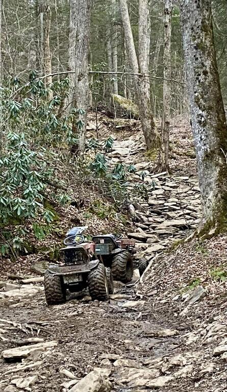

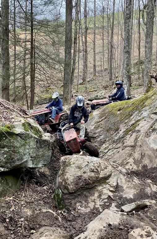

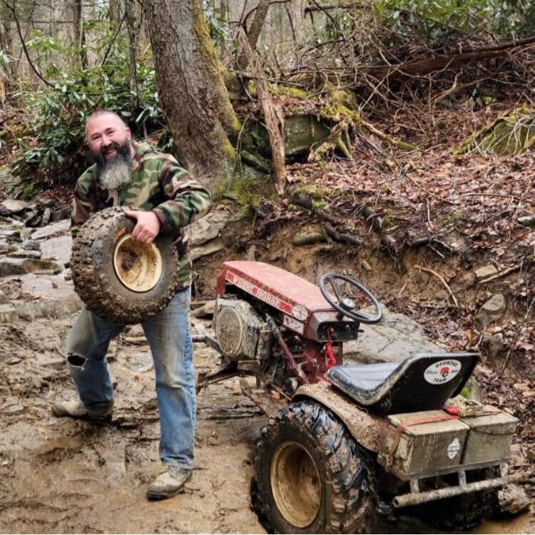

Greentored 3,220 #1 Posted May 16, 2023 Hope you all are doing great! Geez, between breaking ground on a new house and trying to keep my shop going in this 'different' world we live in, things are just a little hectic. While the Horse 'collecting' addiction has taken a bit of a back seat, the off roading continues when I can. (dont worry, ol Hoss and 'lawn duty' 1277 continue to work like rented mules and are running great!) We took a ride at Good Evening Ranch and offroad park last month- 28 tractors altogether! GER is a TOUGH place, with lots of huge rocks and super rugged trails. 5 of us finally found the weak link/breaking point of our beloved Horses- front spindles. Thank God for carrying spares, as I lost both by the end of the weekend. Time for 1" custom 'loader' style spindle upgrades, as even bracing does not help on trails like this. As for the rest of the machine- just plain bomb proof- zero issues, and is probably one of the least 'modified for off roading' machines out there- again- a testament to the Pond brothers!! So, what have you all been up to??? PS- Red Square membership renewed!! 2 5 Share this post Link to post Share on other sites
