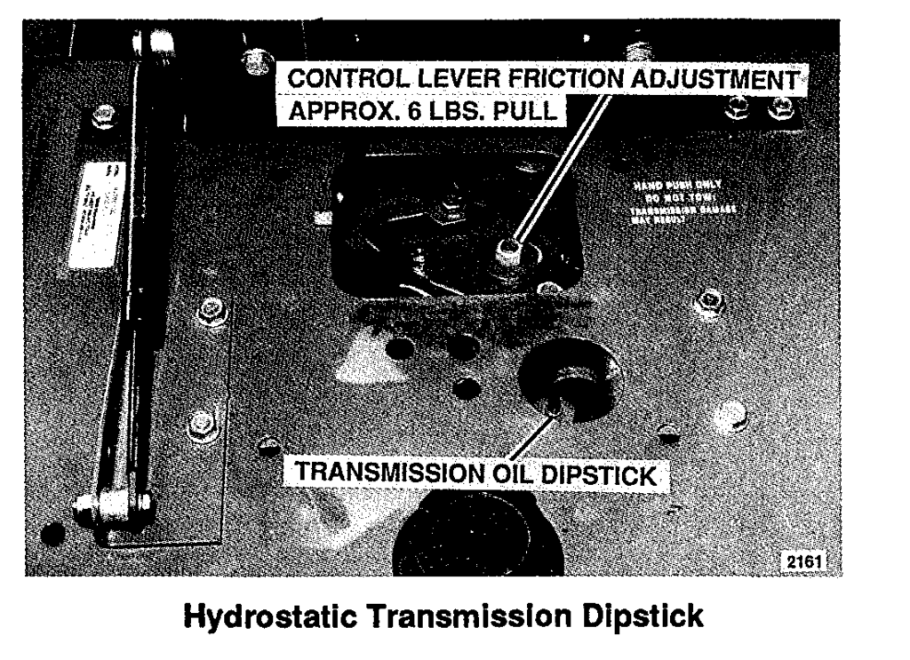

Thetbone 61 #4 Posted May 14, 2023 Handy Don, I referenced the manual, I actually have the original manual when the tractor was purchased, but I do not see where to adjust as you said? 1 Share this post Link to post Share on other sites
lynnmor 8,232 #5 Posted May 14, 2023 Page 15 in your owners manual. 2 Share this post Link to post Share on other sites
