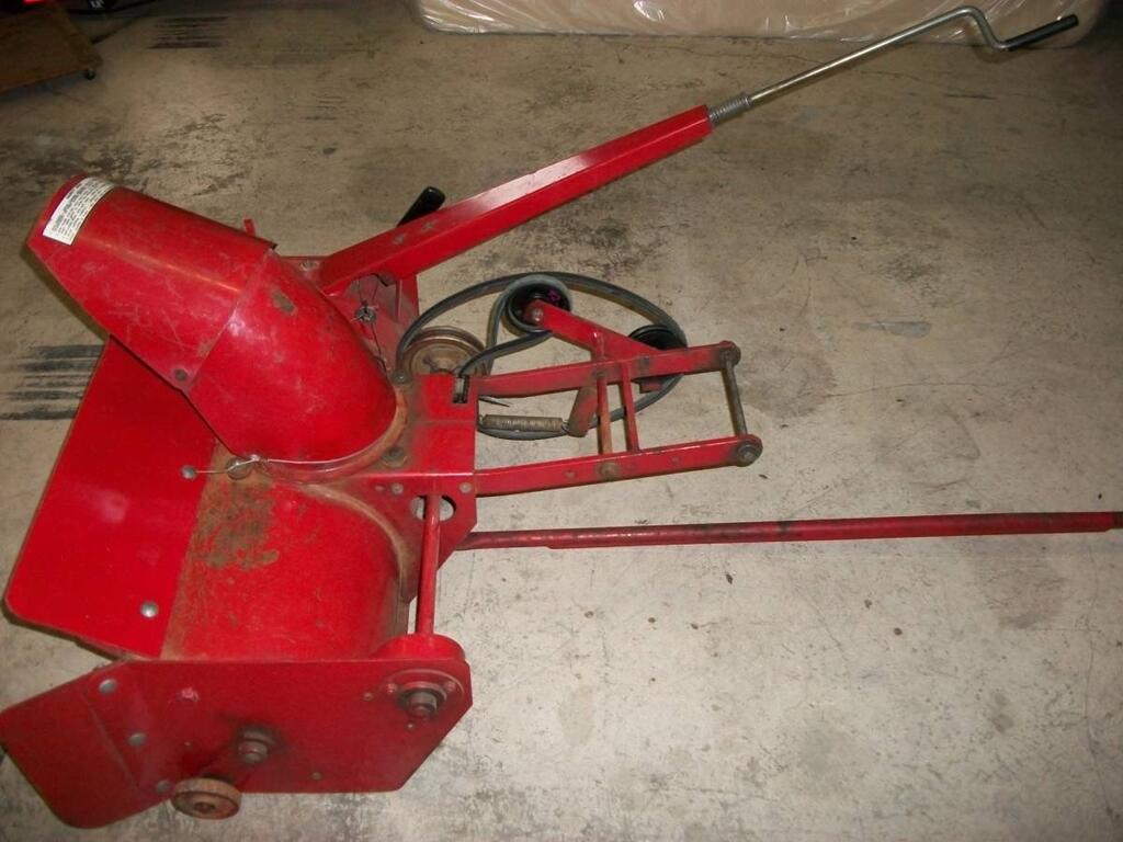

DBrashear 0 #3 Posted May 14, 2023 Here’s a picture. I thought it was attach-o-matic but after looking closer at the picture it looks like it would bolt on. Thank you Share this post Link to post Share on other sites
Ed Kennell 43,800 #4 Posted May 14, 2023 Yep, that would bolt to the two existing holes on the 414s frame. Share this post Link to post Share on other sites
gwest_ca-(File Mod) 11,849 #5 Posted May 14, 2023 1971 model 6-0100 - Fits 800 Automatic, 800 Special, Bronco 14, Charger 12, Raider 10, Raider 12, WorkHorse 800 (No record of 6-0100 at Toro. Suspect it was same as 6-0200 plus 6-9112 in one package) (Uses # 40 chain Pitch 1/2" and roller width 5/16") (Uses #101460 lift tube and #9750 5/8" x 69" belt) Click on the pictures for more info 1 Share this post Link to post Share on other sites

peter lena 9,559 #7 Posted May 14, 2023 @DBrashear , done a couple of those , in recovery ,drag / resistance / function , is the main problem .excellent picture reference , note the idler pulley frame , dry rusty movement areas ? how about those , wobbly , noisy belt Idlers? would also add a stronger pull tension spring , lucas red or green grease in / on every movement point .that #40 drive chain and sprocket , needs a specific chain lubricant , lube before and after every use , also adjust that chain , gat some silicone grease under that chute base , put a round knob on the end of shaft handle , 3/8 x 16 die nut , knob at h/w store , blowers spun up by hand when I sold them , pete Share this post Link to post Share on other sites
