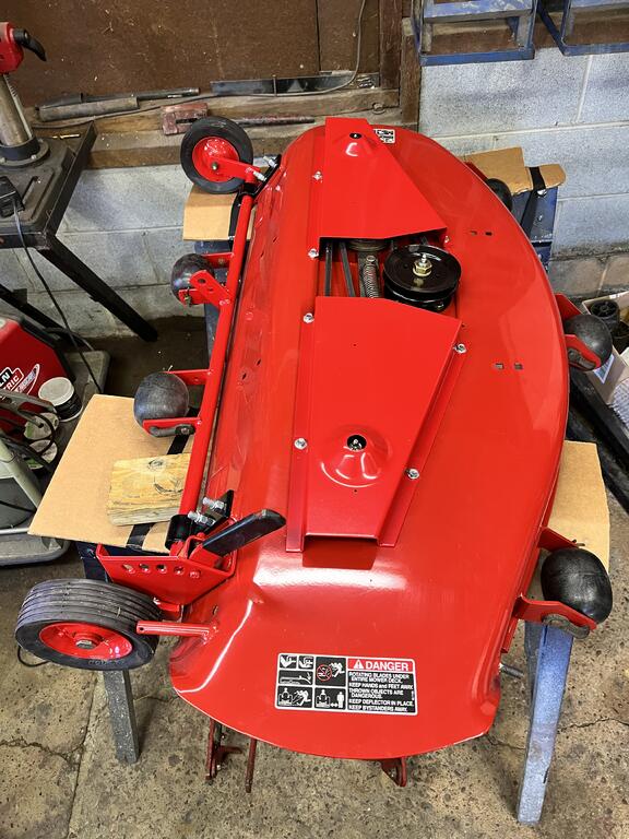

Wvtroutbum81 304 #1 Posted May 9, 2023 So i built a new deck for my 312-8, i am also new to working on WH. Having a hard time getting it to cut even. Would someone more knowledgeable than me please guide me through the process? Share this post Link to post Share on other sites

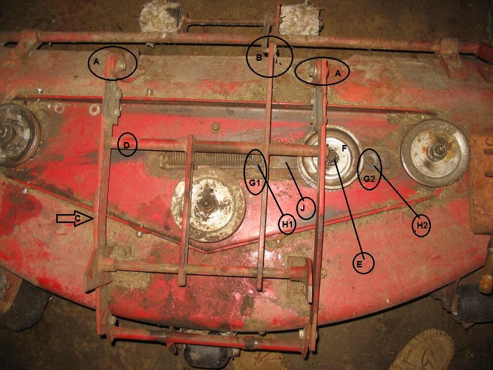

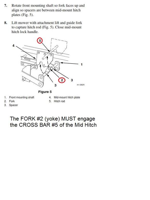

daveoman1966 3,882 #2 Posted May 9, 2023 (edited) First, is it mounted... hung... on the tractor correctly. Study this image of the FORK to be sure. Secondly, are the blades SHARP and mounted correctly.... (they can be mounted upside-down). Third.... is the PTO to Deck belt the RIGHT BELT?...and is the tension set properly? It should deflect 1" or so mid-way of the PTO bell and the front mule drive. 4th... do the 3 deck spindles turn free by hand, with no noticeable drag...and IS the deck TENSION Idler arm/pulley free floating. If not, clean out the debris from under the floating arm (J). (This is a 48" deck...they're all the same setup). Edited May 9, 2023 by daveoman1966 1 1 Share this post Link to post Share on other sites

Rick3478 445 #8 Posted May 10, 2023 17 hours ago, Wvtroutbum81 said: So i built a new deck for my 312-8, i am also new to working on WH. Having a hard time getting it to cut even. Would someone more knowledgeable than me please guide me through the process? So what do you mean by "built a new deck"? Refurbished an existing deck, or start from scratch? If from scratch, does it have gage wheels on the back? Leveling yoke/linkage similar to WH? Gage wheels on the front? A picture or drawing might be helpful. Share this post Link to post Share on other sites

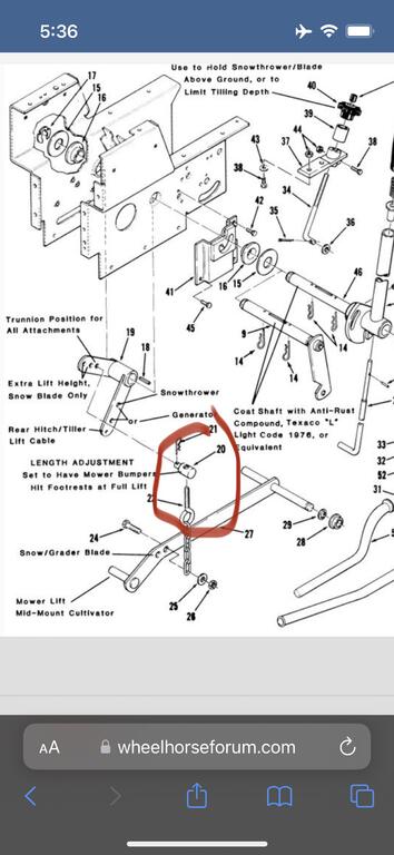

Wvtroutbum81 304 #11 Posted May 10, 2023 Its all new, this was before i put the carrier frame on. I unbolted it from the old shell and put it onto the new one. i think i might have figured it out, the chain that connects lift arm to deck is short, guessing it broke in the past and was not fixed properly. The lift arm will not raise or lower the deck. what length should the chain be? Share this post Link to post Share on other sites
Rick3478 445 #12 Posted May 10, 2023 It's really hard to see with the deck mounted, and almost impossible to get your hands in to adjust. I *think* there are like 4 links of chain plus the screw eye and trunnion on top. Someone else chime in if they have one far enough apart to see. I often thought of trying to figure a better setup, but once adjusted it hasn't needed any further fussing, so I didn't. Ideally, the lift handle should just latch into the up position with the deck pulled tight against the bottom of the tractor. Share this post Link to post Share on other sites
8ntruck 8,631 #13 Posted May 11, 2023 The trunoin that attaches to my deck slides on a rod that hooks into the lift arm. The bottom end of the rod is threaded to allow for adjustment of the up position. Distance between the reunion and the hook in the lift rod n the order of 4 to 6 inches. Working from memory here, which does not work as well as it used to. Share this post Link to post Share on other sites
Wvtroutbum81 304 #14 Posted May 21, 2023 Figured it out, this was turned all the way out. Adjusted it and it works now. Thanks for help Share this post Link to post Share on other sites
