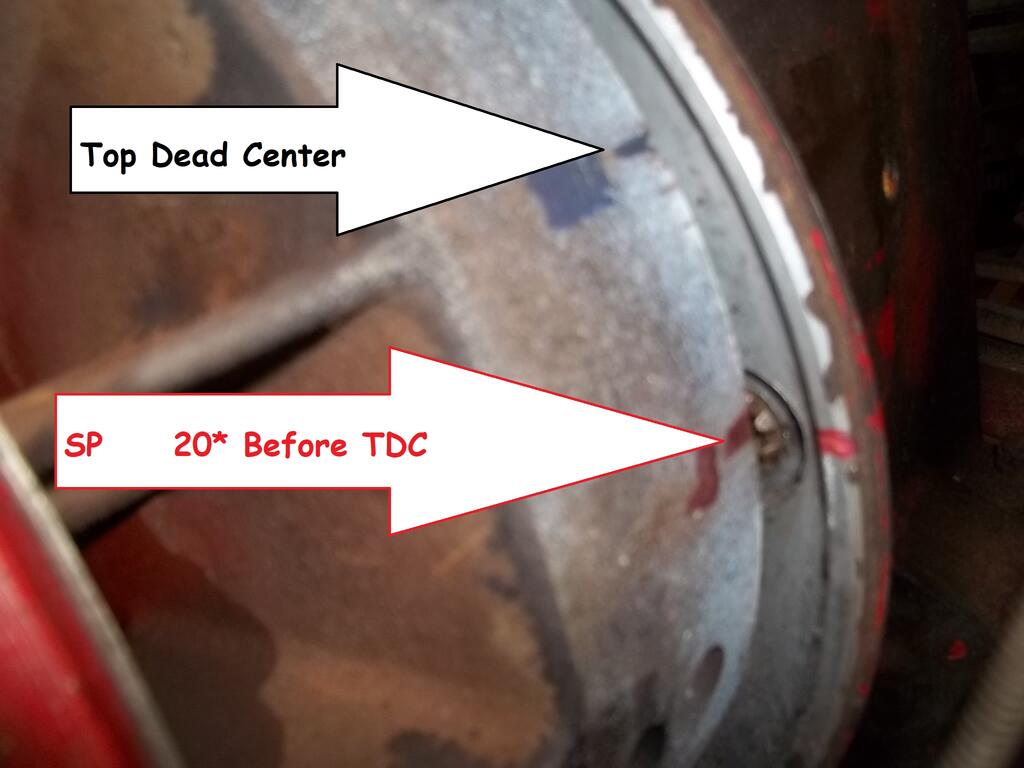

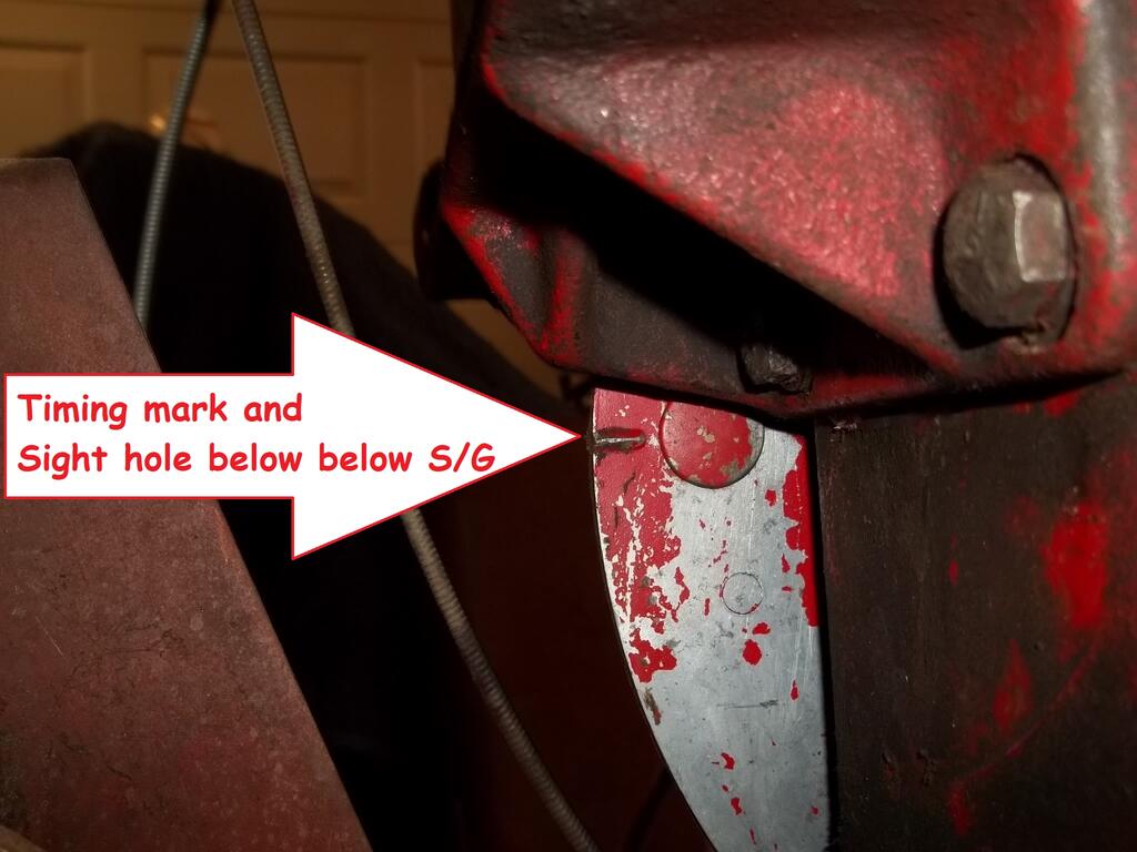

953 nut 64,647 #2 Posted May 9, 2023 45 minutes ago, Skwerl58 said: does it matter since there are only two connections on each You are correct, doesn't matter. 48 minutes ago, Skwerl58 said: Today I could not get the tractor to fire or turn over consistently. I cleaned the points and changed the spark plug but it has very little fire to the plug Check the setting of your ignition points. With the ignition turned OFF and the spark plug out begin by turning the engine over by hand ( latch the PTO) turn the the PTO counter clockwise while watching the ignition points. When they open continue turning until the points reach maximum opening. The points should now be open to .020". Now repeat turning the PTO two full revolutions to double check the setting. If they are not at .020" reset them. The moment opening begins will be setting you ignition timing. The "Static Timing" method can not be used on this engine because it has a spark advance camshaft rather than a compression release cam. If you have a timing light you can check the timing while the engine is running through the sight-hole in the back of the bearing plate. 2 1 Share this post Link to post Share on other sites
