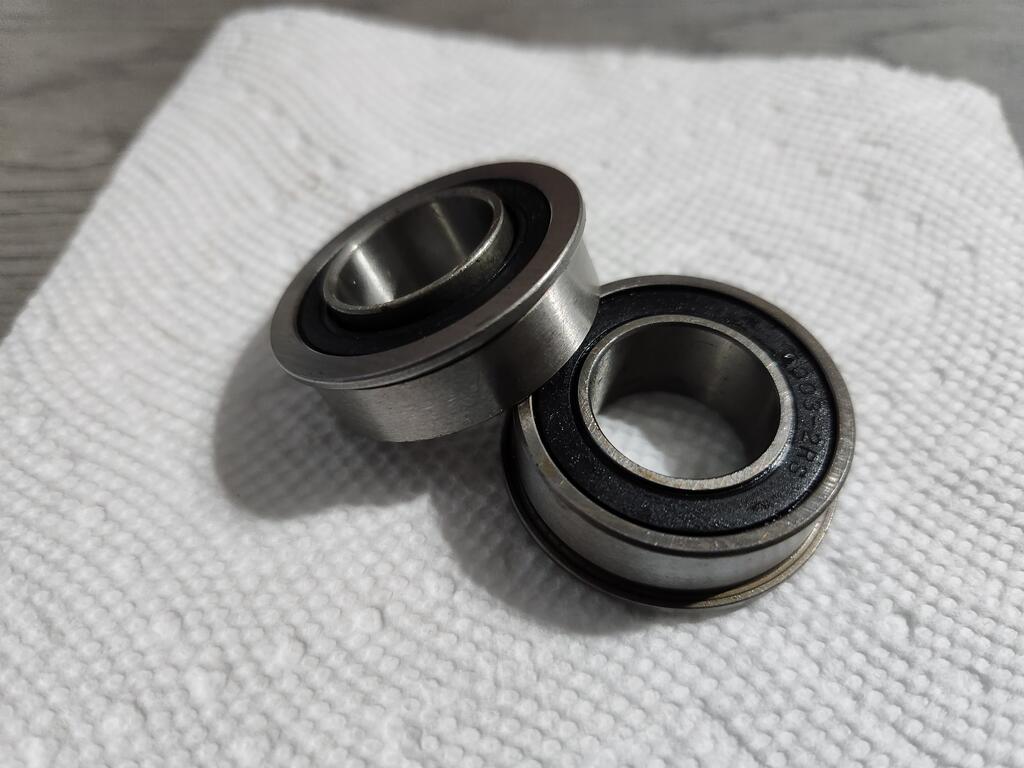

Racinbob 11,932 #9 Posted May 6, 2023 11 hours ago, richmondred01 said: What are your thoughts on the sealed front wheel bearings? Any links to a quality source? Thanks. Get this type and not the stamped steel. 2 Share this post Link to post Share on other sites
Lee1977 7,214 #10 Posted May 6, 2023 (edited) 56 minutes ago, Sailman said: Anybody have a NAPA part number for sealed front wheel bearings on C series tractors? I have bought two sets off ebay. Had one set in the 312-8 for 7 or 8 years. The other set in my 1989 520 has been in 4 years. They all still run quite but they have a little side ways play in them. I don't remember how tight I had them shimed when I installed them, but I thing they have loosen up some. Mine are machined steel also. Edited May 6, 2023 by Lee1977 1 Share this post Link to post Share on other sites
