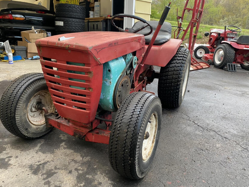

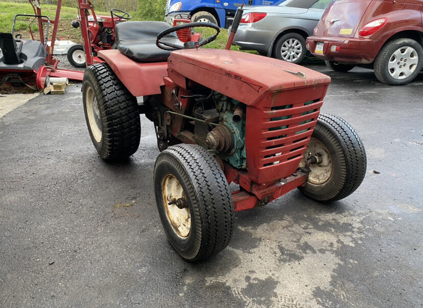

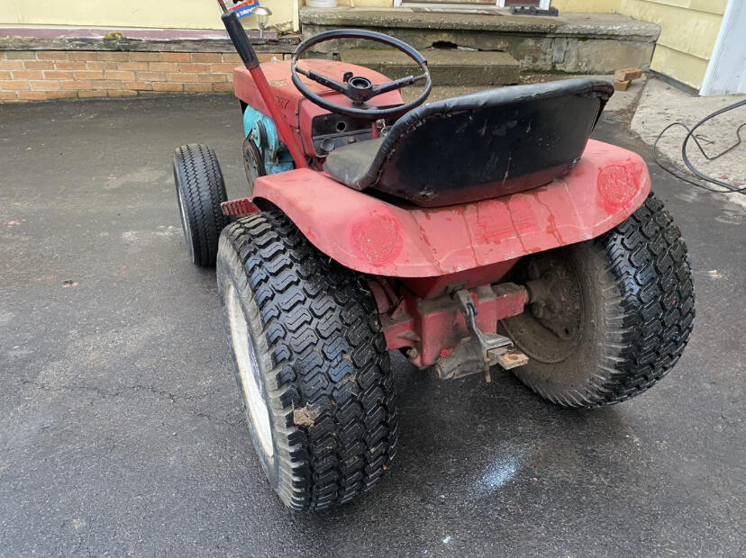

Thompson1276 257 #1 Posted May 5, 2023 Just low rided my 856, that has a HH100 Tecumseh (big block short frame) with points. And she rips but even better fits the rat rod look. Yes I have the drive belt guard just need to shop it a little to make it fit. Took me 6-8 hours to do only specials tools I needed was a angle grinder if anyone was thinking about doing it too and I have it held it with the bottom holes for th transmission at the top holes on the frame and then brackets to hold the top in place if you don’t it’ll wanna fold in on itself 2 2 2 Share this post Link to post Share on other sites

wallfish 19,279 #6 Posted May 5, 2023 28 minutes ago, Thompson1276 said: Thank you I’d like to improve it a little more make it now instead of use , now safe 😅 Looks good The biggest thing safety wise is those steering spindles. If it's just relying on those snap rings to support them and hold the weight don't go too fast because eventually they will indeed fail and it's going to stop FAST too. Especially when doing wheelies and coming down hard. 2 5 Share this post Link to post Share on other sites

Thompson1276 257 #8 Posted May 5, 2023 8 hours ago, wallfish said: Looks good The biggest thing safety wise is those steering spindles. If it's just relying on those snap rings to support them and hold the weight don't go too fast because eventually they will indeed fail and it's going to stop FAST too. Especially when doing wheelies and coming down hard. Yeah the snap rings I noticed I’m going to have to put something stronger at the end, and yeah she dosnt do wheelies, but she use to prob because she’s lower, but she also does around 20 mph Share this post Link to post Share on other sites
