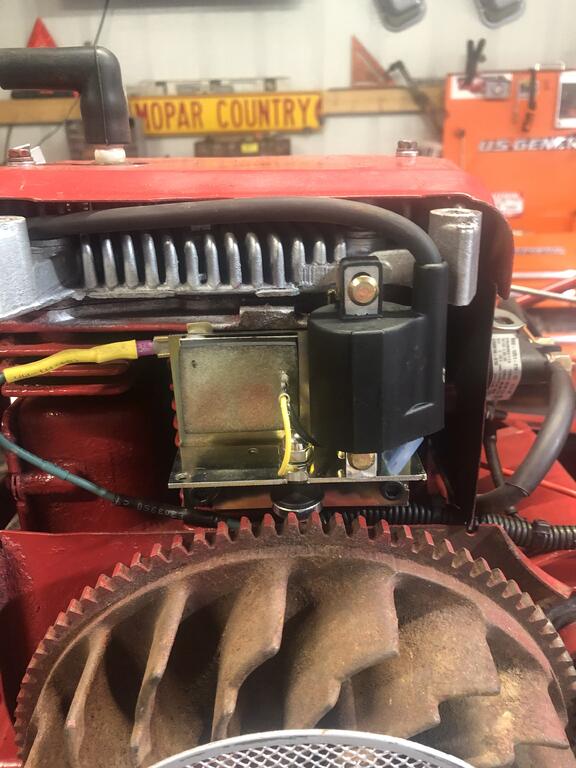

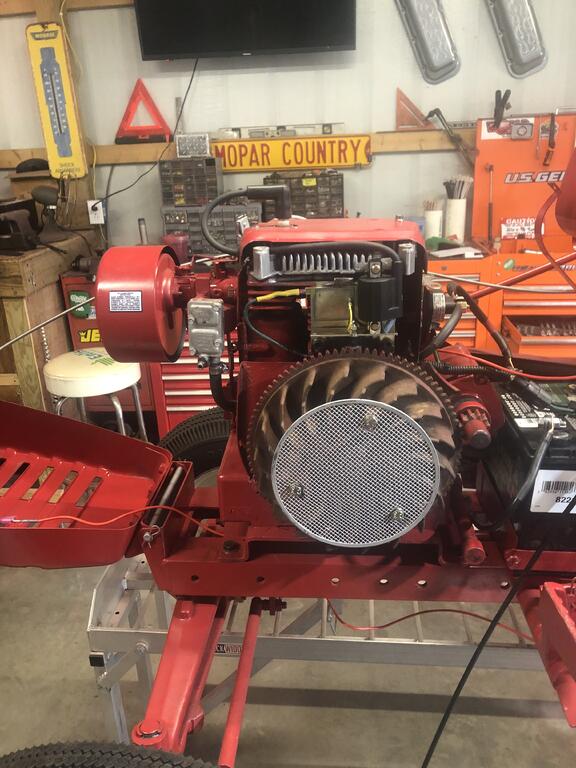

Nearing the completion of my grandfathers raider and can not get spark to the plug for the life of me.   We have already purchased a kit from overnight.  I also added a solenoid just because I don’t care for the way all the load went directly to the key switch.  I thought these two additions would make tractor more reliable. Although I have not been able to get spark at all.  I have tested the stator and it reads 465 ohms consistently.  I don’t know what I am missing.  Any help or thoughts

Has a brand new plug wire and coil
see pictures

My first thought was wondering if the air gap distance is correct from
BOTH trigger pins to the coil's pickup.

Has both pins   Has new battery it whirls over pretty good.  I have talked to guy at overnight.  Seems I forgot to clearance a cooling fin. So sounds like it’s grounding itself out

There is a note at the bottom of the instructions saying to slightly clearance cooling fins.  It’s basically grounding its self out it sounds like.  I will clearance this evening and see what happens
