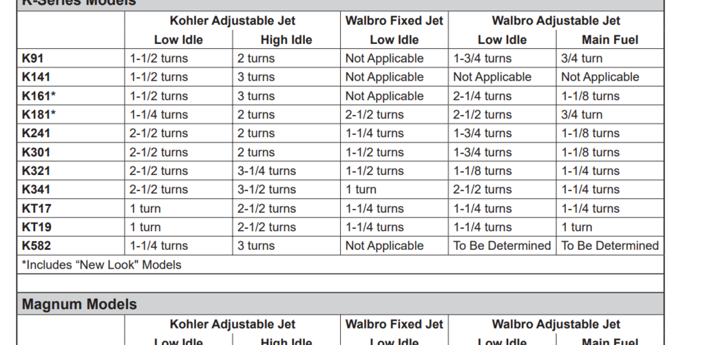

AHS 1,594 #1 Posted April 29, 2023 The 73 14hp/hydro has been my mower tractor for years now! It backfires when i shut it down, from the smell, i have my main jet opened a little bit too far. Do i remember a chart that says how many turns open your main/slow speed was? i remember 10, 12, 14, 16 hp. Thank you Share this post Link to post Share on other sites
ri702bill 11,256 #3 Posted April 29, 2023 Use the chart to get it running - once it is warmed up, adjust the low speed screw for best (not always the highest) RPM then the high speed for best RPM. Go back to idle, throttle up as usual - watch for a poor transition from idle circuit to high speed - you may have to richen the idle.... BT,DT. By chance, is the air bleed clear in the high speed needle ?? - it is a VERY tiny hole, the needle it hollow. Plugged up makes an engine run rich...... 1 Share this post Link to post Share on other sites
Ed Kennell 44,869 #4 Posted April 29, 2023 1 hour ago, squonk said: Where did you find this Mike? I want to print the Magnum settings. 2 Share this post Link to post Share on other sites
squonk 45,520 #5 Posted April 29, 2023 27 minutes ago, Ed Kennell said: Where did you find this Mike? I want to print the Magnum settings. 2 2 2 Share this post Link to post Share on other sites

AHS 1,594 #8 Posted April 30, 2023 7 hours ago, oldlineman said: Do you let it idle down for a few min. before turning off , can help cool engine down and sometimes helps with backfiring, probably a little rich too. That’s what i do. I’m printing off 10 of them charts and putting them in my shop!! 1 right in front of me everywhere I turn!!!!! I have the Kohler carb (im 99% sure). How would i tell which carb i have? Share this post Link to post Share on other sites
AHS 1,594 #9 Posted April 30, 2023 I answered my own question! Check see if the hi speed is out 3 1/4 turns or 1 1/4 turns! Duh! 1 Share this post Link to post Share on other sites
