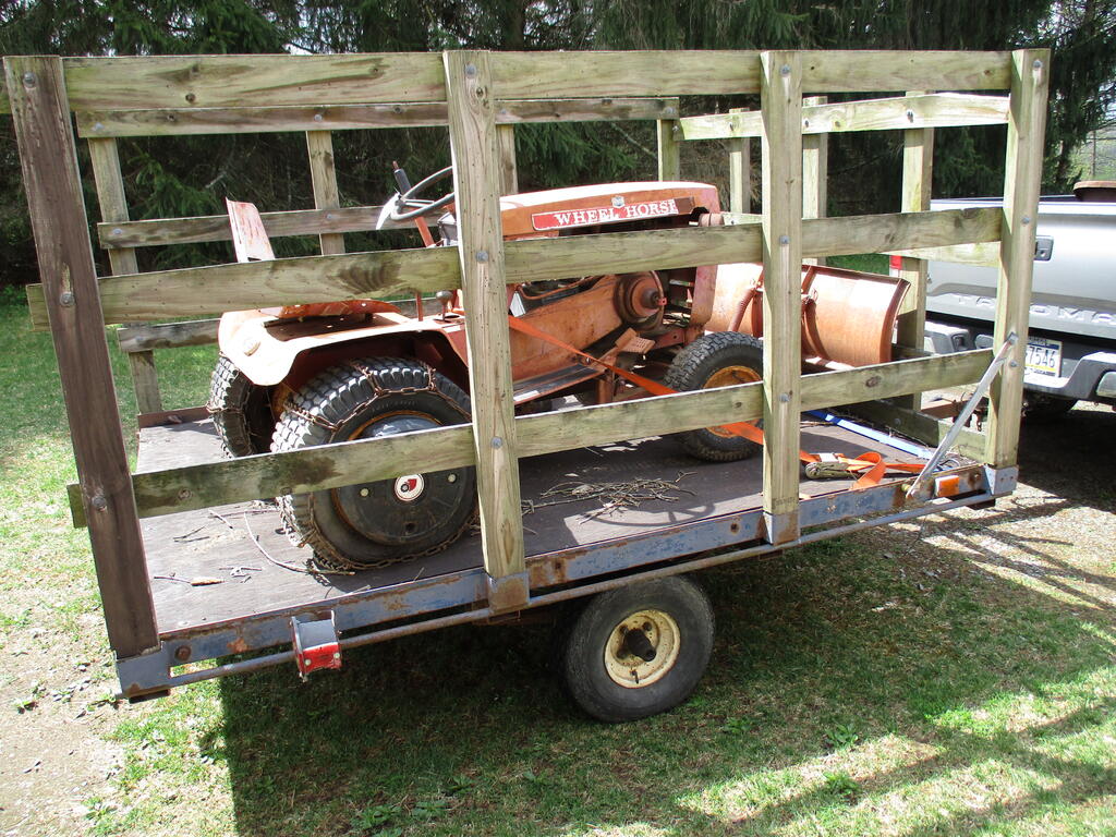

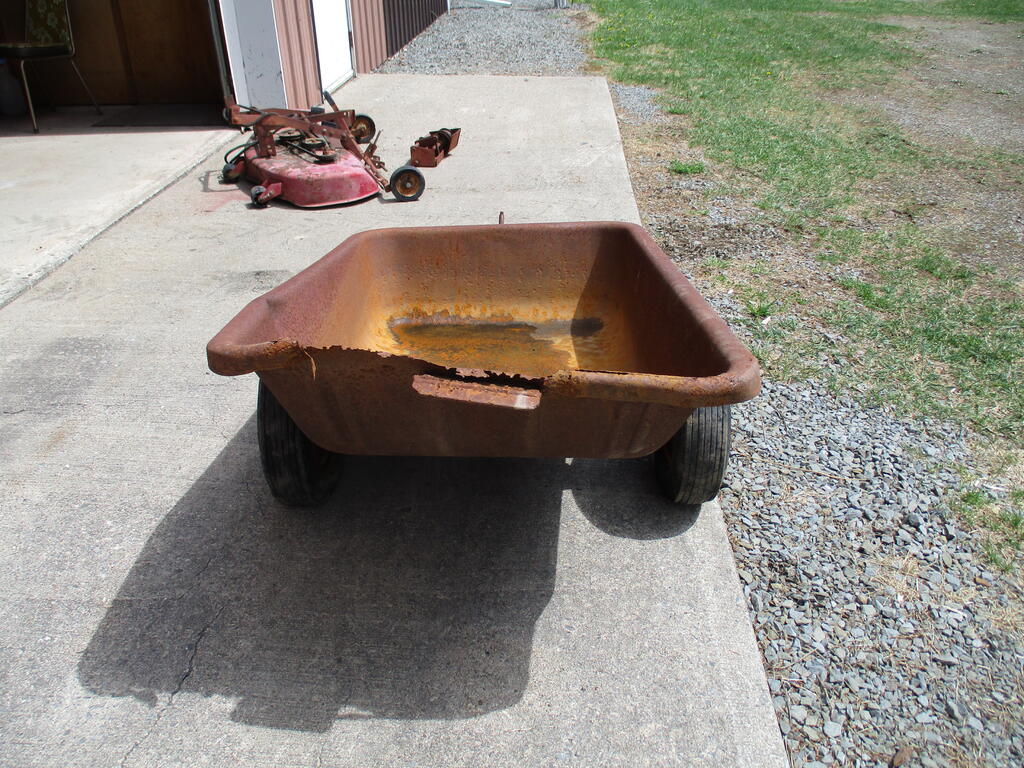

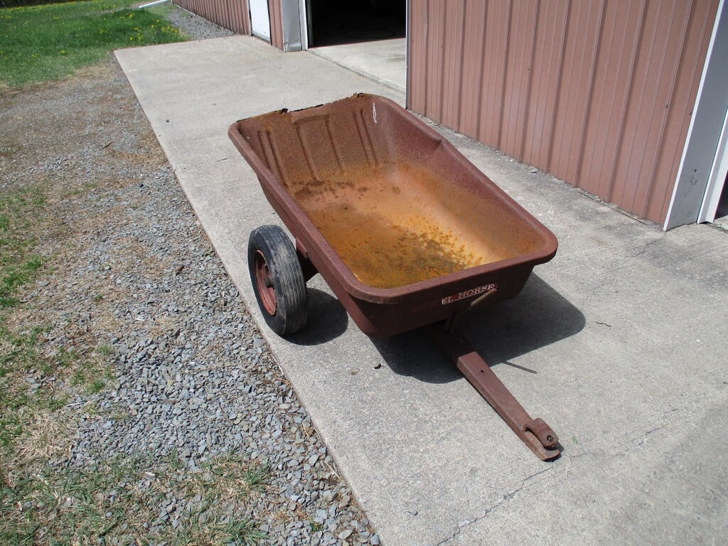

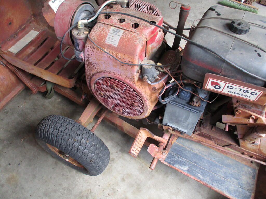

pfrederi 19,868 #1 Posted April 24, 2023 Made a low ball bid online never expected to win...but it went very late in the day (early evening I think) no other bids... Not really anything I needed.. but K341 spins over and has compression. Deck is scrap. May try my spot welder to put some fresh metal on the stern of the tub cart and use it with out worrying about dents scratches Model is 1-0380 -9 Serial (1974) engne spec number is 71128 which is listed for a 1975 model 1 20 Share this post Link to post Share on other sites
ebinmaine 77,302 #2 Posted April 24, 2023 Niiiiice 1 Share this post Link to post Share on other sites
SylvanLakeWH 30,564 #3 Posted April 24, 2023 As Monty Python's Knight would say about that cart: "Thats just a flesh wound!"... 1 5 Share this post Link to post Share on other sites
ri702bill 11,242 #4 Posted April 24, 2023 52 minutes ago, pfrederi said: May try my spot welder to put some fresh metal on the stern of the tub cart and use it with out worrying about dents After you work the twist out of it.... Good score (both) worth saving .... 1 Share this post Link to post Share on other sites
pacer 3,179 #5 Posted April 24, 2023 4 hours ago, pfrederi said: K341 spins over and has compression That alone would be worth quite a few coins...... Nice catch! 2 Share this post Link to post Share on other sites
OutdoorEnvy 1,807 #6 Posted April 24, 2023 Nice grab for sure! Wheel weights and chains too! I can’t come by those in my parts. Keep us updated on bringing her back to life! 2 Share this post Link to post Share on other sites
ebinmaine 77,302 #7 Posted April 24, 2023 37 minutes ago, pacer said: That alone would be worth quite a few coins...... Nice catch! A NON running K341 is worth $150-$225 up here. That #30 carb ALONE is worth $50-$75 even if the throttle shaft is loose. 2 Share this post Link to post Share on other sites
953 nut 64,073 #8 Posted April 24, 2023 The tires on that tub cart are factory originals. If they are any good and you find the right buyer you could make your money back. 3 Share this post Link to post Share on other sites
pfrederi 19,868 #9 Posted April 24, 2023 Interesting finding. You can roll her backwards as far as you want..but not an inch forward...if you jack it up wheels spin freely in opposite directions. Hope she was parked because of tranny issue and the engine may be in usable shape.. 1 1 Share this post Link to post Share on other sites
953 nut 64,073 #10 Posted April 24, 2023 (edited) Sounds like the nut came off a differential bolt and it is wedged in the transaxle. Had that happen a few years back, drove onto the trailer fine and when I got back home it wouldn't budge. Had to use the frontend loader and some chains to get it on the ground. Seems the bolt would hang up going backward but something guided it away from what it was hitting backing up. Edited April 24, 2023 by 953 nut fat finger 2 Share this post Link to post Share on other sites
pfrederi 19,868 #11 Posted April 24, 2023 Hope that is the case here. Trannies I can fix and have spares... 2 Share this post Link to post Share on other sites

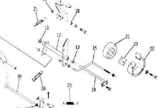

pfrederi 19,868 #13 Posted April 28, 2023 She popped off an ran for a few seconds on a spray of carb Cleaner!!! and it wasn't the tranny. The cross shaft that supports the brake (item#14) is too short and not anchored on the right side hence it was crooked and cause the dragging. The shaft looks original but is about 1/8" too short 2 Share this post Link to post Share on other sites
