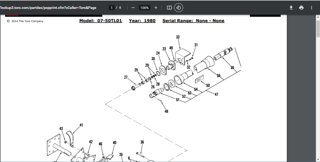

"Manic-Mechanic" 1,420 #1 Posted April 15, 2023 This is in search of part 25, any help greatly appreciated. (is it same as the axle bearing?) Share this post Link to post Share on other sites

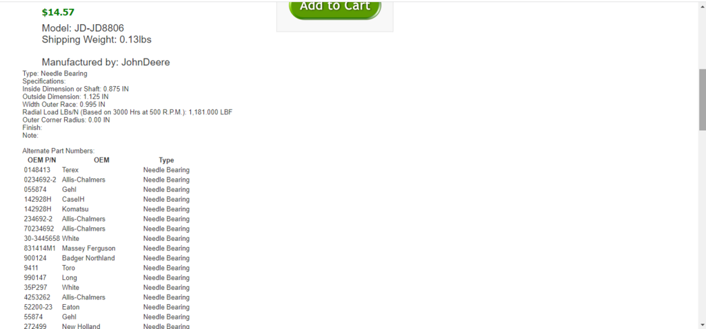

"Manic-Mechanic" 1,420 #2 Posted April 19, 2023 I can't believe yuen's left me hanging! I struggled but found it under none other than a Green Machine! Share this post Link to post Share on other sites
