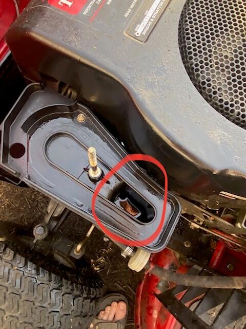

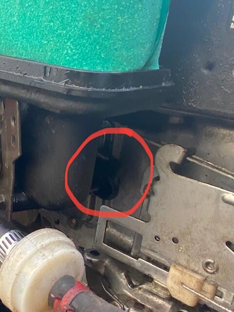

d124716 7 #1 Posted April 12, 2023 Hello and thank you for looking at my post. I have a toro 13-38xl (13HP, B&S model# 28M707 Type 1122-E1) that I had for many years. Some time ago it started having issues starting and smoking heavy on start up. Once the tractor warms up for a bit it works great, restarts easy, no issues when warm. I've cleaned the carb, put a new plug, new air filter, new breather on it, cylinder compression checked at at 70psi . It didn't solve the problem, tractor worked for a season but progressively got worst. I went to start it up just now and it would run for a few seconds and then die out. I've noticed that there is a lot of oil in the air intake "sum" that connects to the breather hose (see picture below). Tried running the tractor without the filter, it starts runs great for a few seconds and then the oil fountains out of the air cleaner "sump" as the motor dies. I took off the rubber breather hose (see picture below) and started the engine, again ran great for a few seconds and then the oil flooded out of the rubber hose like a fountain. I am guessing but it feels like the oil is being passed back into the air intake and then chokes the motor out. There is a "charring" black residue all over the front of the tracker where the exhaust comes out. I love this thing, it served me well for many years and would hate to let it go. Please help.... Thank you! 1 Share this post Link to post Share on other sites
RED-Z06 2,716 #2 Posted April 12, 2023 Oil is contaminated with gas most likely...carb probably needs a new needle and seat. 1 Share this post Link to post Share on other sites
Achto 30,999 #3 Posted April 12, 2023 9 hours ago, d124716 said: Some time ago it started having issues starting and smoking heavy on start up Is your oil level over full? If so you may be leaking gas into the crank case. Float not shutting the gas off inside of the carburetor. 70lbs of compression sounds a little low. You may have blow by on the piston rings causing excess crank case pressure. This would force oil out the breather. 2 Share this post Link to post Share on other sites
d124716 7 #4 Posted April 12, 2023 Thank you for commenting, few follow up notes and a question. 1. Dip stick does smell like gas. 2. When "oil" shoots out of the breather it does feel / look to be much thinner than it should be. 3. On initial start up the starter has a hard time turning the engine over, almost like a hydro lock indeed. However, after a few seconds / tries the starter spins the motor with good RPMs (I've always blamed this on a weak battery). 4. On initial start up the motor does take a very long time to start, it will spin and spin for 5-8 tries with about average of 5 seconds for starter engagement. 5. Oil level on dips stick is very high... almost unbelievably high. I've always checked the oil after the engine had a chance to distribute the oil all over itself, when doing it that way the level seemed to be in order. Follow up questions: What tests are there to determine if I have a leaky carb issue or a worn piston rings issue? Thank you! 2 Share this post Link to post Share on other sites
Ed Kennell 44,868 #5 Posted April 12, 2023 Gas in the crankcase is dangerous to you and the engine. The gas is likely entering the crankase either thru the carb or thru a fuel pump. The carb float may be full of fuel and no longer floating or the needle shut off valve may not be sealing. The fuel pump may be leaking fuel thru a bad diaphram into the crankase. 1 Share this post Link to post Share on other sites
