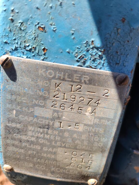

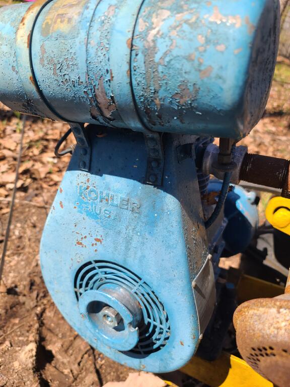

York57 1 #1 Posted April 11, 2023 Hey I'm new here and I knew this is for Wheel Horse however someone may know the answer. I have a vintage I believe from the 50s Farm-Ette walk behind. Last year I removed the Carb to get another and misplaced it. It has a Kohler Engine only thing I see is Model K 12 -2 Spec 2645-A I contacted Kohler and they can't locate any information. Please if anyone has information it would be greatly appreciated. I have attached photos if that helps Thanks Sam 1 Share this post Link to post Share on other sites

wallfish 19,300 #3 Posted April 11, 2023 Looks like a K91 carb would fit right on there. But it's possible the governor works the opposite direction as a K series engine. Do you know if it even runs? You can run it without a carb to test it. A spray bottle works best but the gas will trash the inards of it. They're cheap anyway. You just need to be able to continuously feed gas into it Share this post Link to post Share on other sites
