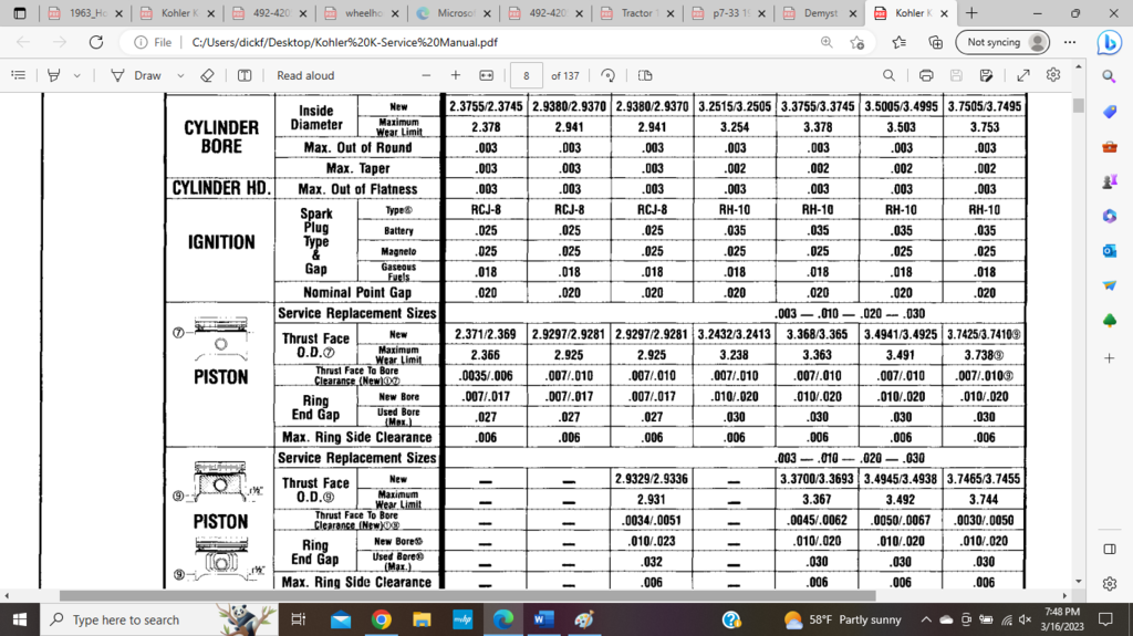

953 nut 60,224 #13 Posted April 17, 2023 Is your spark plug gapped at 0.025"? Share this post Link to post Share on other sites

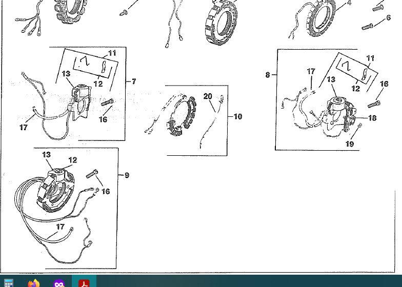

pfrederi 18,703 #14 Posted April 18, 2023 (edited) 47147B spec number originally came with a Breakerless ignition system. Obviously some PO replaced it when the trigger or coil failed. Going to be hard to figure which magneto style stator/coil set up they used with out pulling flywheel to see. There are at least 3 types that would fit. Edited April 18, 2023 by pfrederi Share this post Link to post Share on other sites
