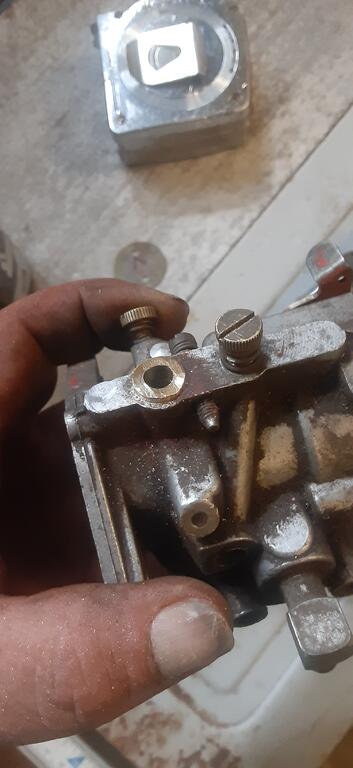

Oldskool 6,679 #82 Posted August 21, 2023 I finally had a moment to work on this little guy again. The throttle shaft had alot of play in it so I spun out a bushing for it. I have gas and fire with a jumper. It will start with a squirt of starter fluid then die. When trying to start with just the carb all it does it buck to starter. I was thinking a stuck valve 🤔, but it starts with a shot. I know I'm over looking something, but what 1 Share this post Link to post Share on other sites

953 nut 70,664 #86 Posted August 22, 2023 15 hours ago, Oldskool said: When trying to start with just the carb all it does it buck to starter. Could be the ignition timing is off or you have a condenser that has gone bad, time for an ignition tune-up. 1 Share this post Link to post Share on other sites
Oldskool 6,679 #87 Posted August 22, 2023 6 hours ago, 953 nut said: Could be the ignition timing is off or you have a condenser that has gone bad, time for an ignition tune-up. I never gave much thought to the condenser. It has good fire Share this post Link to post Share on other sites
953 nut 70,664 #88 Posted August 23, 2023 16 hours ago, Oldskool said: I never gave much thought to the condenser. It has good fire Here is some information I saved from a post by @Save Old Iron. If an engine idles well, but runs erratically when revved up, like it hits and misses, pops and backfires, then chances are, it needs a new condenser/capacitor. And always install a condenser/capacitor with the wire facing downward so rain water and/or when washing off engine, water will not enter inside condenser/capacitor, ruining it. With water inside the condenser, this will also allow it to idle well, but cause it to run erratically when revved up. 1 1 Share this post Link to post Share on other sites
