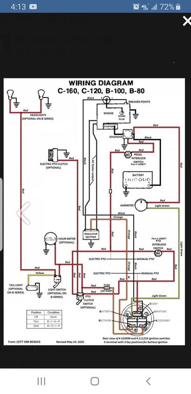

ebinmaine 80,918 #26 Posted April 13, 2023 26 minutes ago, Frank DeHaven said: I have looked everywhere for wiring diagram for my tractor. It is a 1976 wheel Horse c120 automatic and it has the Kohler 12 horse power engine. Maybe I'm blinder I don't know how to read but I just can't seem to find it. I found one for a 74 but I'm not sure if it's the same. Any help that anyone can give me would be greatly appreciated. Again thanks everyone for all the help that you've been giving me every time I tinker with it and get something else working I have a big smile on my face. 74 and a 76 should be close enough to one another to use. Same body style. 1 Share this post Link to post Share on other sites
ebinmaine 80,918 #28 Posted April 13, 2023 Got that several years ago and been using it for half a dozen tractors or more. 1 1 Share this post Link to post Share on other sites

953 nut 69,807 #30 Posted April 14, 2023 Until you have it running and drive the "C" around you won't know what needs to be repaired while it is apart. Here is a bit bigger wiring diagram. 1 1 Share this post Link to post Share on other sites

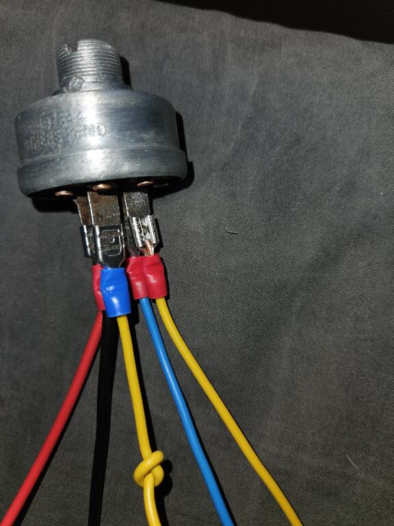

Frank DeHaven 27 #32 Posted April 18, 2023 Well after taking everybody's advice and I still can't thank you enough for all the information I have rewired the ignition. I ran out of colored wire so I had to substitute blue for green and yellow with a knot for white but I have everything written down as to what goes where. I also replaced the coil, the condenser, and the points. I know I have to replace the solenoid due to half thing to jump across terminals. But it turns over so hopefully with this new temporary wiring job it will run. Cross your fingers! 4 Share this post Link to post Share on other sites
