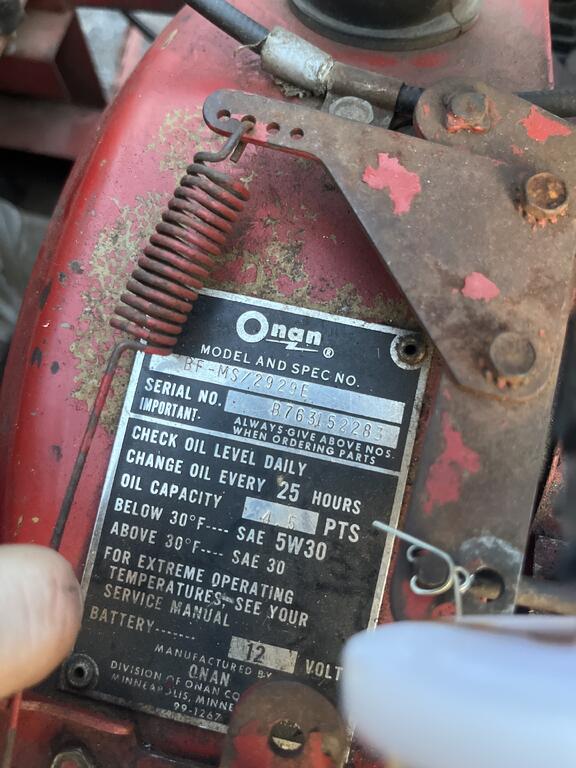

857lover 291 #1 Posted April 4, 2023 hey guys i was wondering if anyone has every done a repower on a d series’s tractor i know it would be expensive but i’m willing to put a little money in to make this work my onan on the tractor does run it’s just a little finicky as i put a carb and intake from a 416 on to it …took a little modification to make it fit but it works half decent but i can’t get the original air cleaner on i did all this because the orginal carb was missing the needle for some reason and i could find one anywhere and i just want the peace of mind of a new engine like one of those twin predators or briggs 3 Share this post Link to post Share on other sites

pacer 3,179 #13 Posted April 4, 2023 2 minutes ago, 857lover said: this kit would work for my engine ? @857lover sure, you do have a B43M dont you? 2 Share this post Link to post Share on other sites
857lover 291 #14 Posted April 4, 2023 2 minutes ago, pacer said: @857lover sure, you do have a B43M dont you? 1 Share this post Link to post Share on other sites
Handy Don 15,928 #15 Posted April 4, 2023 24 minutes ago, pacer said: B43 carb kits are plentiful on the bay and they will have a needle plus a bunch of other stuff --- dozens. Just enter B43 carb kit in search..... But you are right in saying they ARE finiky!!! This one is $16.50 Not a big investment to try it. 1 Share this post Link to post Share on other sites
pacer 3,179 #16 Posted April 4, 2023 Well..... that dont exactly say B43, but from your earlier pic, that looks like it would take the square carb which is whats on the 43's. I had one and became intimate with that dang carb, and your engine sure looks like mine. Some of the 43's had a built in fuel pump on the carb and others - like mine, had a off mount 'pulse' pump - the basic carb is the same tho. 2 Share this post Link to post Share on other sites
857lover 291 #17 Posted April 4, 2023 18 minutes ago, pacer said: Well..... that dont exactly say B43, but from your earlier pic, that looks like it would take the square carb which is whats on the 43's. I had one and became intimate with that dang carb, and your engine sure looks like mine. Some of the 43's had a built in fuel pump on the carb and others - like mine, had a off mount 'pulse' pump - the basic carb is the same tho. i will definitely give it a try 2 Share this post Link to post Share on other sites

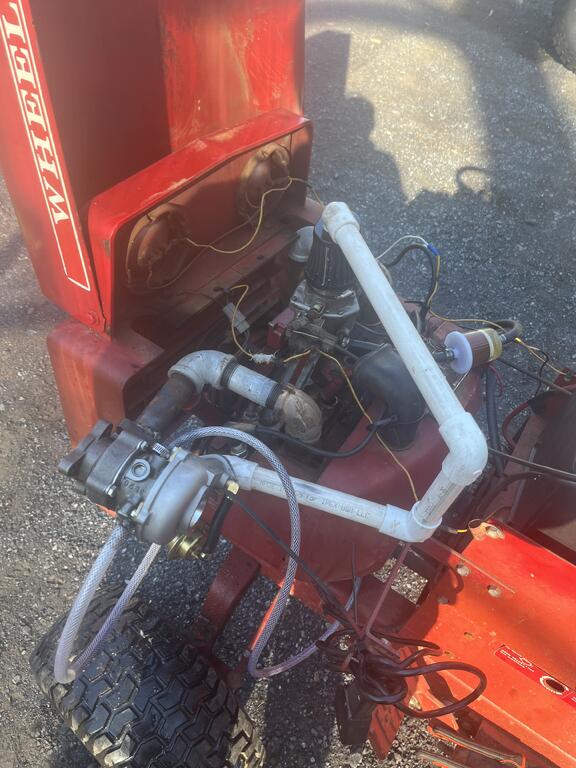

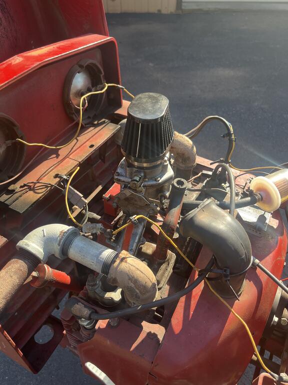

857lover 291 #19 Posted April 9, 2023 On 4/4/2023 at 9:18 PM, TJ Salyers said: So who all has a turbo Onan would love to see it and see how it performs. i now can say me 1 Share this post Link to post Share on other sites
TJ5208 1,841 #20 Posted April 9, 2023 36 minutes ago, 857lover said: i now can say me Yes you can. 1 Share this post Link to post Share on other sites
8ntruck 8,600 #21 Posted April 9, 2023 3 hours ago, 857lover said: i now can say me Pictures? Video? Share this post Link to post Share on other sites
857lover 291 #22 Posted April 9, 2023 Just now, 8ntruck said: Pictures? Video? 1 1 Share this post Link to post Share on other sites
857lover 291 #23 Posted April 9, 2023 (edited) 1 minute ago, 857lover said: it’s still a work in progress onlh had it for one day working out some kinks Edited April 9, 2023 by 857lover 1 Share this post Link to post Share on other sites
TJ5208 1,841 #24 Posted April 9, 2023 Now it's a turbo d160. 1 Share this post Link to post Share on other sites
