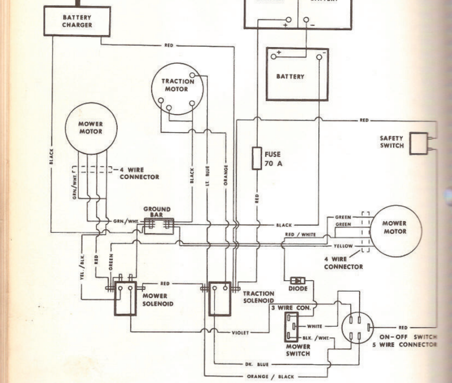

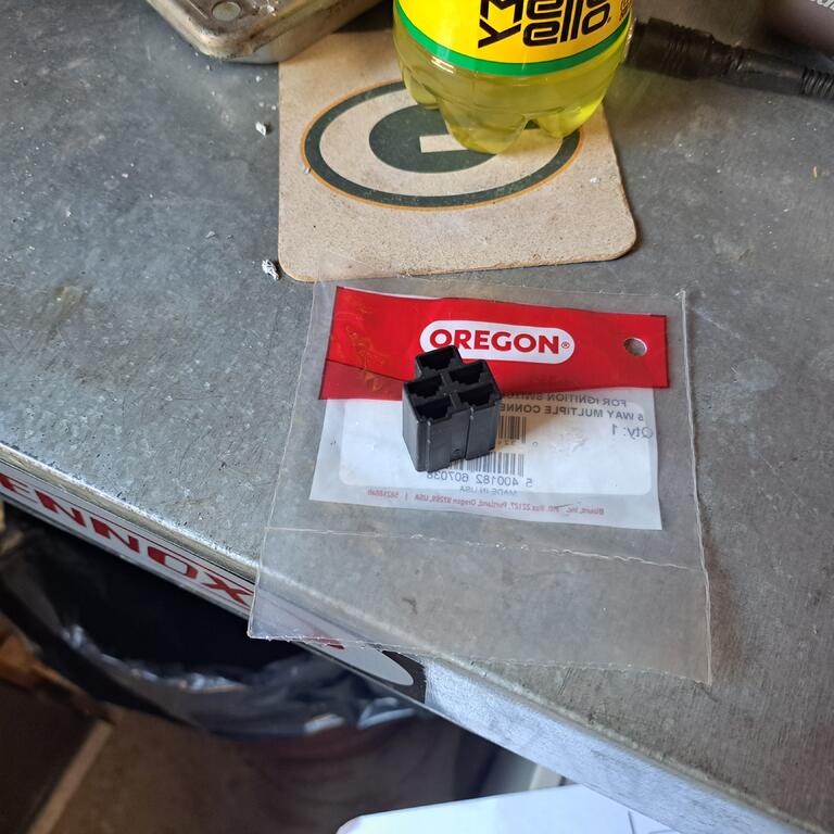

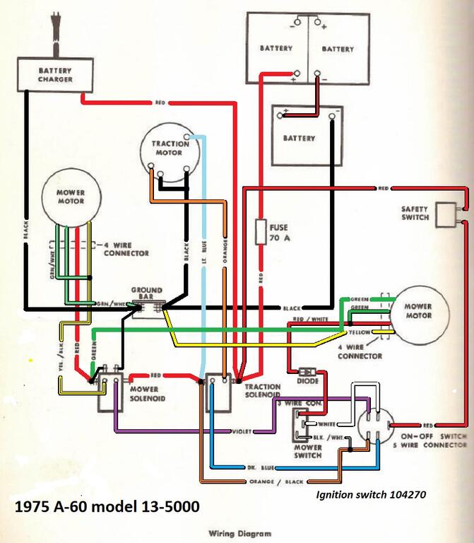

WHX?? 53,081 #1 Posted March 29, 2023 (edited) On Sylvia's @SylvanLakeWH NOS A-60 Electric Horse a PO decided he needed the plastic block that plugs into the ignition switch more than this tractor does. No biggie as @Achto found a replacement in the jungle & one will be here today. Worst is there is a diode that plugs in a socket that is wired in the motor circuits that run the mower blades. That diode has also flown the coop and is listed as discontinued. Can anyone tell us what the purpose of that diode is? It appears it's part of the power supply to the DC motors. Perhaps a braking circuit when the blades are switched off? Part number for it is 104272. Also part number for ignition switch is 104270. Is this switch the common five terminal one found on other models? Mods if this thread belongs in electric horses please move. Edited March 29, 2023 by WHX?? 1 Share this post Link to post Share on other sites

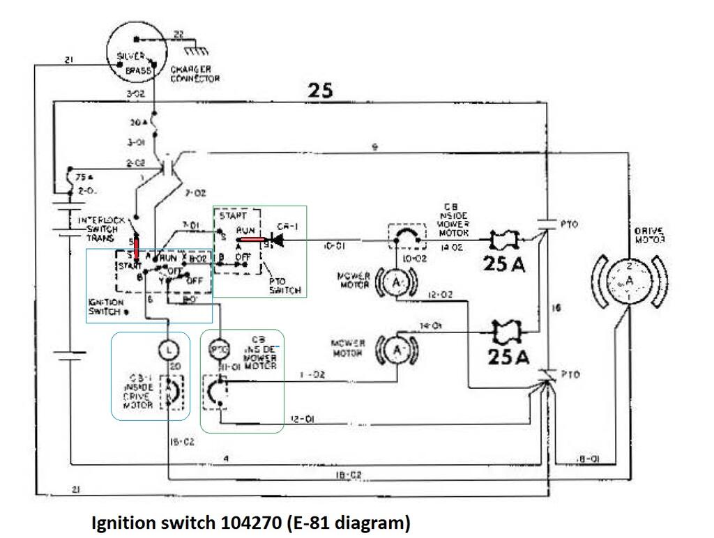

gwest_ca-(File Mod) 11,777 #2 Posted March 29, 2023 May help? There is a switch schematic.for 104270 2 1 2 Share this post Link to post Share on other sites

Handy Don 14,884 #4 Posted March 29, 2023 Probably not blade braking, but I think you are on the right track. I think it prevents current from being put back into the circuit from blades that continue to spin after the motor is shut off. 4 1 1 Share this post Link to post Share on other sites
953 nut 62,595 #5 Posted March 29, 2023 Most DC electric motors will also act as a generator. When the switch is turned off the blades spin for a while and will slow more rapidly if there is opposition to the power being produced by the blades spinning the motor. I don't think it is a deal breaker, with the holder for the diode being open it will do no harm in my opinion. 4 1 2 Share this post Link to post Share on other sites

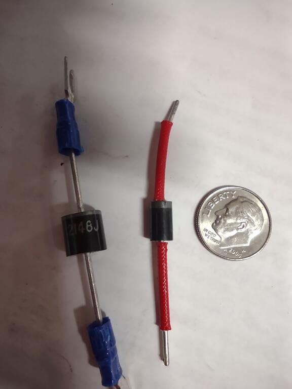

Achto 30,038 #6 Posted March 29, 2023 57 minutes ago, WHX?? said: That diode has also flown the coop and is listed as discontinued. One of these work for you Jim? 1 Share this post Link to post Share on other sites
WHX?? 53,081 #7 Posted March 29, 2023 Yes that's where I was going with this but thinkin it would help if a guy knew the electrical characteristics or ratings of it. I'm going to get in touch with a guy that I met at a show who is into GE Elect Tracs. See if he can shed any light on this. Get some numbers off the motors & research them too. 2 1 1 Share this post Link to post Share on other sites
SylvanLakeWH 29,518 #8 Posted March 29, 2023 If i'm understanding this then, you can run without a diode? My simplistic brain assumes the closed switch prevents current from blades still spinning from going back into the circuit past the closed switch??? 1 Share this post Link to post Share on other sites

gwest_ca-(File Mod) 11,777 #10 Posted March 29, 2023 Trying to figure out the ignition switch wiring and I'm stumped. This is from the E-81 that used the same ignition switch 1 2 Share this post Link to post Share on other sites
squonk 44,746 #11 Posted March 29, 2023 (edited) The direction arrow on the diode is allowing current out of the mower motor to the motor switch but not from the switch to the motor. I think it's there to keep that motor from going in the wrong direction. Edited March 29, 2023 by squonk 1 1 Share this post Link to post Share on other sites
WHX?? 53,081 #12 Posted March 29, 2023 Mower switch is a three position spdt switch & has continuity from white to red/white in run. White to black/white in momentary start mode, spring return to run when released. 1 1 Share this post Link to post Share on other sites
WHX?? 53,081 #13 Posted March 29, 2023 (edited) 43 minutes ago, squonk said: The direction arrow on the diode is allowing current out of the mower motor to the motor switch but not from the switch to the motor. I think it's there to keep that motor from going in the wrong direction. So they are looking for some sort of feedback from the motor? Why only to one motor? The white wire is connected to the violet one when the ignition switch is in start or run. Continuity from the red wire on the ig switch to dk blue when in start is the only other ring on the switch. Edited March 29, 2023 by WHX?? 1 Share this post Link to post Share on other sites
squonk 44,746 #14 Posted March 29, 2023 Just now, WHX?? said: So they are looking for some sort of feedback from the motor? Why only to one motor? The white wire is connected to the violet one when the ignition switch is in start or run. No idea why. But all a diode does is prevent current flow in the opposite direction of the arrow. They wanted it in there for some reason. I'm not an electrical engineer. I just watch guys play the part when they come to do a power survey at the plant. Maybe that feed back to the switch acts as a blade brake when the switch is flipped off. 1 Share this post Link to post Share on other sites

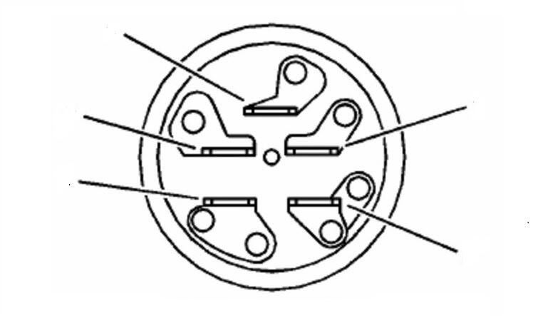

WHX?? 53,081 #15 Posted March 29, 2023 (edited) 42 minutes ago, squonk said: blade brake when the switch is flipped off. My first thoughts too and the motors see each other somehow thru the mower solenoid? 42 minutes ago, squonk said: I'm not an electrical engineer. Well go get one dammit ... Sure wish Save Old Iron was still around... This should work for the ignition switch... Edited March 29, 2023 by WHX?? 1 1 Share this post Link to post Share on other sites

gwest_ca-(File Mod) 11,777 #20 Posted March 31, 2023 Interested in knowing how the terminals on the ignition switch are identified when viewed from the back. 1 Share this post Link to post Share on other sites
