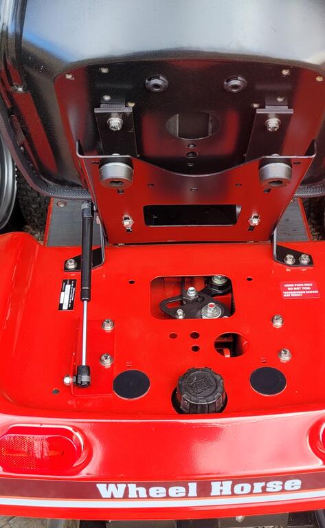

clueless 3,332 #1 Posted March 24, 2023 I know this has been posted before but here it goes again, what size shock strut do I need to replace my 312-8 seat strut? Share this post Link to post Share on other sites
cleat 8,111 #2 Posted March 25, 2023 Seat lift gas spring 114343 (Strong arm F4673) For my last couple of tractors I have used Strong arm 6915 just need to source the ball mounts. 1 Share this post Link to post Share on other sites
Lee1977 7,462 #3 Posted March 25, 2023 (edited) I bought a couple off Ebay a few years back. Found two 10" 60 # truck tool box lid support struts for 11 and change with free shipping. They have to hole in the ends. Edited March 25, 2023 by Lee1977 1 Share this post Link to post Share on other sites
dcrage 631 #4 Posted March 25, 2023 I thought Craig (AMCrules) had a readily available option for these. Share this post Link to post Share on other sites
