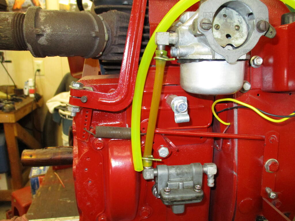

pfrederi 19,879 #1 Posted March 24, 2023 (edited) Based on discussions here a few years ago that the black neoprene fuel lines were bad I bought some yellow line Tygon fuel line and put it on several horses. Apparently it was not a good choice.. after a few years exposed to fuel the stuff shrinks and gets very hard. .Note the difference between the pump to carb line and an unused piece of the tygon. I know several are now using the blue stuff....but has anyone 2 or three years experience with it does it harden up also???? (I have never had any issues with the neoprene line I got from McMaster.) Edited March 24, 2023 by pfrederi 1 1 Share this post Link to post Share on other sites
ebinmaine 77,335 #2 Posted March 24, 2023 I tried using the yellow stuff for one year. Noticed that shrinkage almost immediately. I switched over to the Blue Line made by Stens. I've had that on Cinnamon for 3 years now and it too is due for replacement. I really do like the idea of being able to see the fuel in the line but I can't honestly recommend. Either the yellow Tygon or the blue Stens line... 3 Share this post Link to post Share on other sites

formariz 12,354 #4 Posted March 24, 2023 Tried twice with the yellow and blue lines. really not impressed with them. They will deteriorate right at the connection with time and get hard. Also regular spring clamps are too big for them. As a routine maintenance item I inspect and change lines anyway if needed. So far for the flexibility and durability I stick with the black neoprene lines. Not that it is a concern for me but they also look better. If one does regular maintenance there is no need to reinvent the wheel. 5 1 Share this post Link to post Share on other sites

pfrederi 19,879 #9 Posted March 24, 2023 This is not my day for tubing. I have a 175k Mr Heater torpedo unit about 4 years old. Went to use it and it sputtered didn't run well and shut itself off. Some disassembly and research revealed the rubber hose from the air pump to the burner had dry rotted and cracked open in several places. The fuel line from the tank to the burner was also dried out and cracked but not leaking. replaced with some neoprene fuel line and all is better. 5 1 Share this post Link to post Share on other sites

RED-Z06 2,716 #24 Posted March 27, 2023 Tygon line was a scam, to me...when it came on the scene nationally around 2004ish, it was supposed to be the end-all be-all fuel line that resisted heat, UV exposure, ethanol, and time. What we found was, it was none of that..you get up to about a year out of it; it gets rigid and cracks. Stens blue line, is slightly better but suffers from a different type of failure that frankly scares the hell out of me...it just dissolves, or disintegrates, it falls apart even when not exposed to UV light. The plastic line you see on Amazon...same kind of issue, it shrinks and breaks. Ive gone to normal rubber lines, either briggs brand or goodyear, triple layer...its more expensive yes but, it lasts. 3 Share this post Link to post Share on other sites
