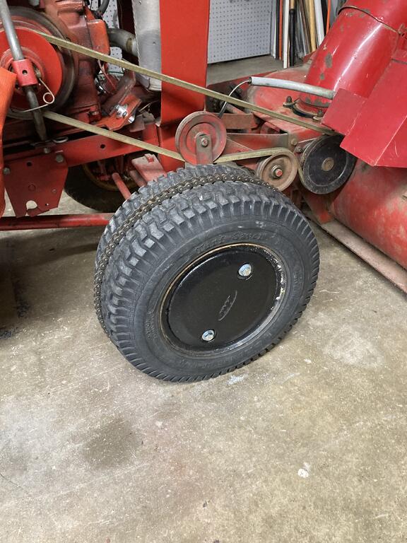

Wayne0 1,526 #8 Posted March 19, 2023 (edited) On 3/18/2023 at 8:47 AM, Blasterdad said: What an AWESOME idea!! I've got a bunch of double 40 at work. That should work even better. My 520H is a dedicated snow machine.The 2 stage is a PITA to change off and on. I have an old Workhorse 1800GT for the mowing and hauling. Edited March 19, 2023 by Wayne0 added info 1 Share this post Link to post Share on other sites
Wayne0 1,526 #9 Posted March 21, 2023 Dug it out today and it's #50! See any issues? Share this post Link to post Share on other sites
Blasterdad 3,163 #10 Posted March 21, 2023 28 minutes ago, Wayne0 said: Dug it out today and it's #50! See any issues? Nope, Share this post Link to post Share on other sites
Wayne0 1,526 #11 Posted March 21, 2023 3 hours ago, Blasterdad said: Nope, Great!! Share this post Link to post Share on other sites
ri702bill 11,417 #12 Posted April 2, 2023 Wayne - double strand #50 roller chain - THAT in itself will add some hefty weight to the front wheels..... Share this post Link to post Share on other sites
