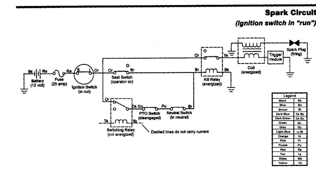

Handy Don 15,761 #4 Posted March 15, 2023 (edited) 2 hours ago, Wayne0 said: When I back my 520H up the ramp and into my shed, I have to crank my head around to see where I'm going. When I do that, I take weight off the seat and the motor cuts out. I have the same experience as Ed and Bill for 520-H, 312-H, and 310-8 -- dismounting with the PTO disengaged lets the engine keep running. If your PTO lever is pulled fully back and the cutout is still happening, then I think it’s time for you to check your wiring. Do you have the wiring diagram and are you comfortable doing some investigating? Some 520’s use a single switch at the PTO and a Kill Relay. Others have two switches and no relay. So I can’t give you any more specific guidance. Find documents on this site with a search like “Tractor yyyy 520-H”. Search in “Files” or “Documents” and turn on “Use all my search terms". For “yyyy” use the year of your tractor. Edited March 15, 2023 by Handy Don Share this post Link to post Share on other sites
Wayne0 1,476 #5 Posted March 15, 2023 If the motion control is engaged, the motor cuts out. (so you can't run your self over) Not just the PTO. Sounds correct to me. 1 Share this post Link to post Share on other sites

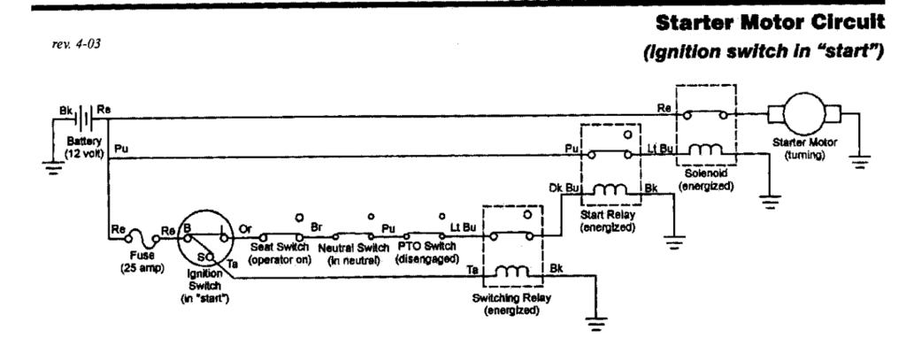

Handy Don 15,761 #6 Posted March 15, 2023 (edited) 30 minutes ago, Wayne0 said: If the motion control is engaged, the motor cuts out. (so you can't run your self over) Not just the PTO. Sounds correct to me. Good catch. according to the Demystification Guide, 520-H ’91-97, the neutral switch is in the starter circuit and the spark circuit. To start: seated, neutral, and PTO disengaged To run either: - seated or - PTO disengaged and neutral (so if motion is not in neutral and operator leaves the seat, regardless of PTO, it stops the engine) Edited March 15, 2023 by Handy Don Share this post Link to post Share on other sites

Wayne0 1,476 #9 Posted March 15, 2023 18 minutes ago, Handy Don said: Good catch. according to the Demystification Guide, 520-H ’91-97, the neutral switch is in the starter circuit and the spark circuit. To start: seated, neutral, and PTO disengaged To run either: - seated or - PTO disengaged and neutral (so if motion is not in neutral and operator leaves the seat, regardless of PTO, it stops the engine) The way I'm seeing it, I can jump the orange and brown to bypass the seat switch and have the option to use it or not. Thanks for that. Share this post Link to post Share on other sites

cleat 8,716 #14 Posted March 16, 2023 Here is an early 520 wire diagram. It shows that so long as the PTO is off then you can get off the seat. Neutral switch only affects starting, not running. Wheel horse 520H wire diagram.pdf This is the wire diagrams for the later model 520's It shows how the seat and neutral switches come into play even with the PTO off 520 wiring.pdf I always rewire mine to the early spec. that simplifies things a lot. Share this post Link to post Share on other sites
