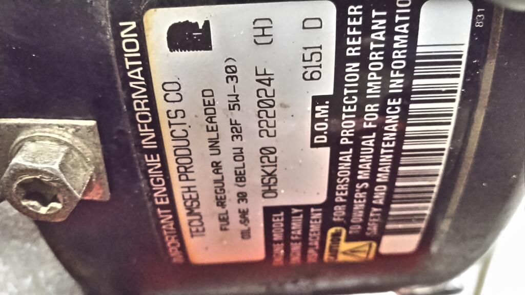

Bill D 2,596 #1 Posted March 15, 2023 (edited) Trying to fix my neighbor's snowblower. It's a Toro Powermax 828LXE. It has a Tecumseh OHSK120 swapped on it. I've rebuild the carb, new fuel lines, new primer lines, set the valve clearances, .004 intake /.010 exhaust. I swapped coils and plugs with no change. The engine runs fine until you load it. Once I try to move heavy wet snow it dies in a minute or less. After it dies it's impossible to restart unless you use the electric start with full choke, and even then it starts hard. I can't figure out why it runs well with no load and not when loaded. Thinking burnt exhaust valve. Any advice is appreciated. Bill Edited March 15, 2023 by Bill D 2 Share this post Link to post Share on other sites
