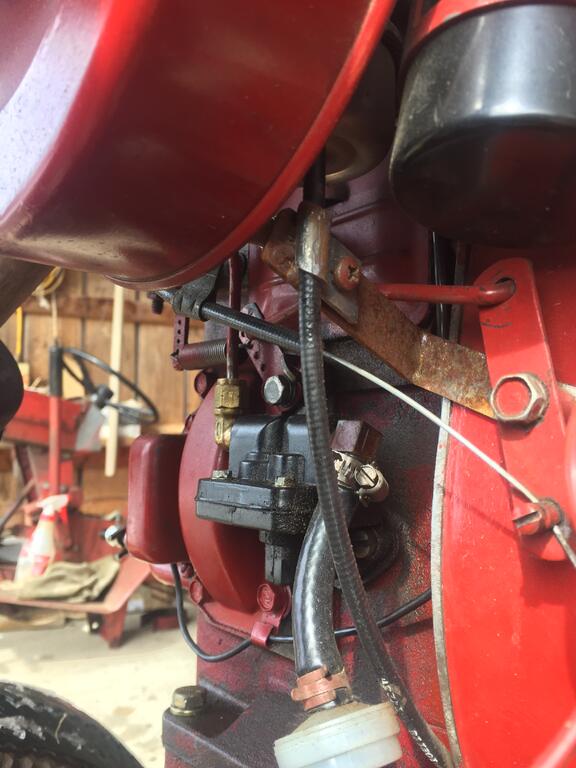

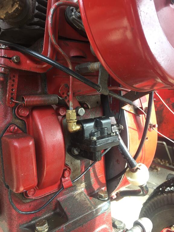

JimSraj 561 #8 Posted March 15, 2023 Oil level is good and I don’t smell any gas odors. Viscosity seems fine also. Here are a couple of pictures taken this morning after it ran for about 20 minutes. I was keeping an eye on the breather plate as it was running and could not see any oil or even mist coming from anywhere but there was enough oil on the block and front of the oil pan below the breather to catch a coating of dust. 1 Share this post Link to post Share on other sites
Handy Don 15,629 #9 Posted March 15, 2023 36 minutes ago, JimSraj said: oil pan below the breather to catch a coating of dust. Only thing that comes to mind is if the mesh in the breather is in place and intact. Over a few hours usage, I do get an oil residue on the front of my 181. Like you, I noticed it because it collects dust . BTW, is the throttle cable housing going to interfere with the governor arm where they cross or is it just the camera angle? 1 Share this post Link to post Share on other sites

kpinnc 16,616 #12 Posted March 16, 2023 Looks completely normal to me. 1 Share this post Link to post Share on other sites
JimSraj 561 #13 Posted March 16, 2023 Well thanks to all of you. I guess I’m being a little too particular about it. Good to know that others have the same experience with their tractors. Don, it’s the camera angle. I fashioned the bracket that holds both cables bc I didn’t like their positions. There is no interference with the governor arm. 2 Share this post Link to post Share on other sites
