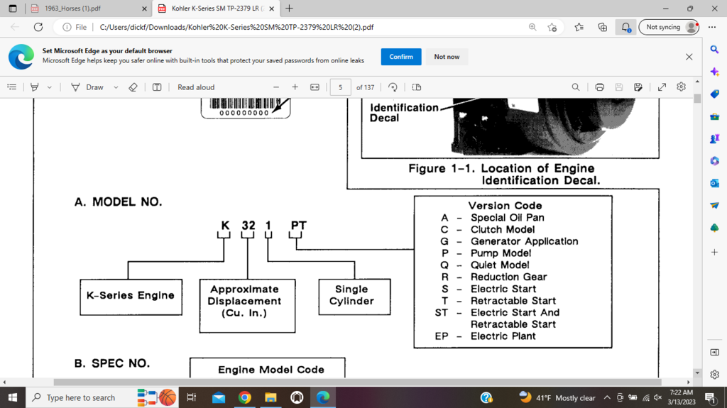

Pullstart 68,882 #1 Posted March 13, 2023 Anyone ever seen a P in a model number on an old K series? Spec no. 30559d. It’s on a long splitter. Pressure lube possibly? The pictures online are not very complete and hard to see. 1 Share this post Link to post Share on other sites
953 nut 64,115 #2 Posted March 13, 2023 The "P" stands for Pump Model. 4 Share this post Link to post Share on other sites
Pullstart 68,882 #3 Posted March 13, 2023 Gotcha. Is that a set governor then most likely? Runs at WOT? Share this post Link to post Share on other sites
