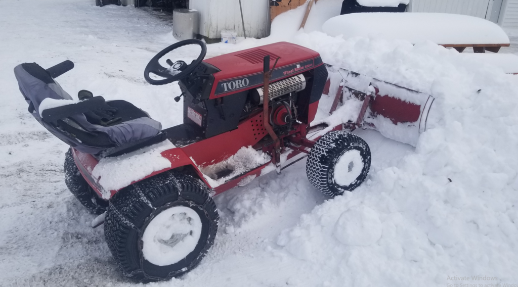

boomchucker49318@gmail.co 2 #1 Posted March 11, 2023 Hi, I've had a 520H, two different units, for over 15 years. I really like this tractor. I don't mow with it but I have front, belly, rear blades (box scraper), cultivator, single bottom plow, and a rototiller. It's set up with a shop made Brinley style hitch for some of those implements. I loaded the rear tires when I first got it so I didn't have to take off the chrome baby moon hubcaps in order to put on ugly wheel weights! It works great for plowing snow. My problem is that it has gotten slower and slower in both forward and rear motion. I would say that it is half the speed of what it was when I first got it. I've adjusted that linkage that is under the plate in front of the seat but it won't adjust any more. Is there something else I can do or am I just going to have to replace the parts of that linkage? 1 Share this post Link to post Share on other sites
