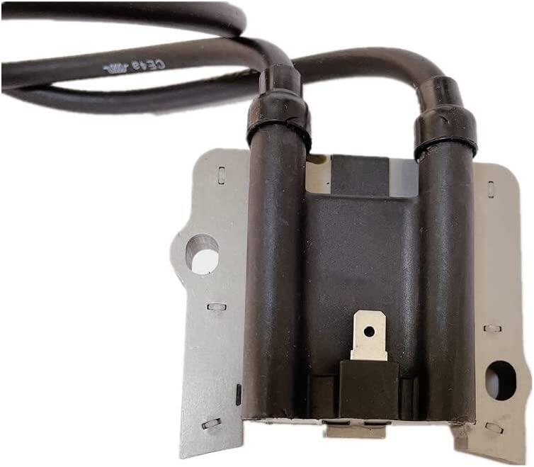

Achto 30,999 #2 Posted March 8, 2023 (edited) 16 minutes ago, johnnymag3 said: I am looking to bench start a Kohler M18 I believe your M18 will have a magneto coil not a battery ignition, please check to verify. If it does have a magneto coil you will have to ground the coil kill wire to shut the engine off. To start it ground the block and throw power to the starter. Kill wire on the coil would connect to the spade terminal in the middle. Do not send positive power to the coil, this will wreck a magneto coil. if it has a battery ignition then it will be just like running a K model with a battery ignition. Power to coil to run, remove power to coil to kill. Edited March 8, 2023 by Achto 2 Share this post Link to post Share on other sites
johnnymag3 2,635 #3 Posted March 8, 2023 So if I ground the engine...and send 12v to starter...the engine will run from the power generated by the magnets on the outside of the flywheel...and to shut down, ground the male spade on the coil... John 3 1 Share this post Link to post Share on other sites
johnnymag3 2,635 #5 Posted March 8, 2023 15 minutes ago, Achto said: Correct! So easy !!!! I do not have points and coil, so I definitely have a magneto coil system thanks so very much !!! ACHTO I did not want power that coil and cook the system, as I have only bench ran K engines with points, coil etc. so asking first is far better !!!. 2 1 Share this post Link to post Share on other sites

Achto 30,999 #7 Posted March 8, 2023 (edited) 28 minutes ago, johnnymag3 said: So easy !!!! This is also how you would bench test all Briggs & Stratton engines. Edited March 8, 2023 by Achto Share this post Link to post Share on other sites
