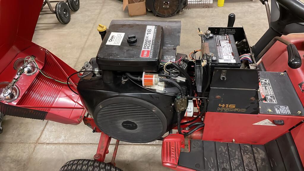

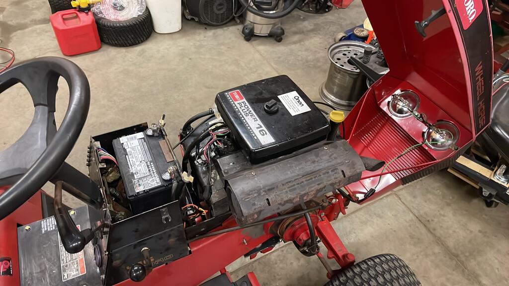

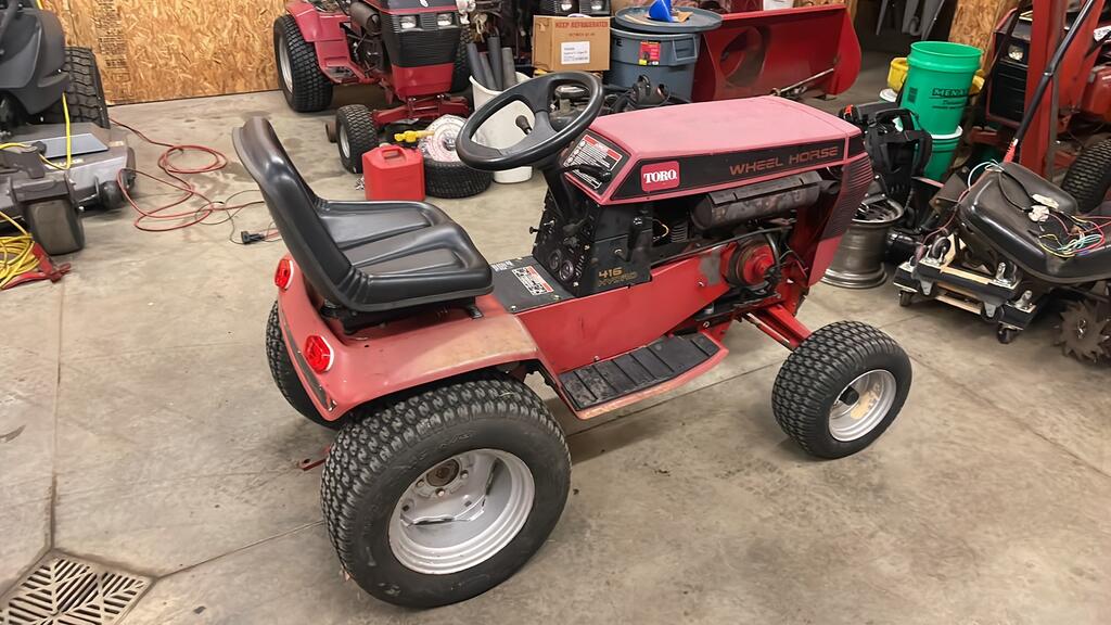

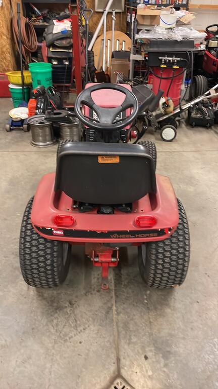

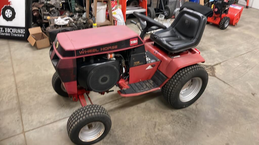

Bow_Extreme 580 #1 Posted March 6, 2023 Another one done. It’s been sitting here for 3 years, waiting to come alive. Following has been completed: 1. Engine harness connector replaced with 2-Deutsch connectors. 2. All wiring has been replaced/repaired/upgraded including, removing the fuse block and replacing with sealed, ATC fuse holders. 3. All electrical connectors have been cleaned, blown out, and packed with dielectric grease. All terminals were cleaned as well. 4. New Battery 5. Entire fuel system was removed, flushed, and all new hose and filter added. 6. Trans was drained, flushed, and new filter and oil put in. 7. Fuel pump vacuum hose was replaced. 8. New drive belt installed. 9. All new bolts installed with sheet metal and coated with anti-seize. 10. New tail lights installed. 11. Engine oil drained, cleaned the inside of the pan, and installed a new filter and oil. 12. New seat fitted and installed. 13. Rear hitch pin removed, cleaned, anti-seize put on and reinstalled. 14. New air filter and wrap. 15. I’m sure I’m missing something…lol 16. Power washed entire tractor long ago when I bought it. Going to it’s new home, soon! IMG_8245.MOV 2 13 Share this post Link to post Share on other sites
