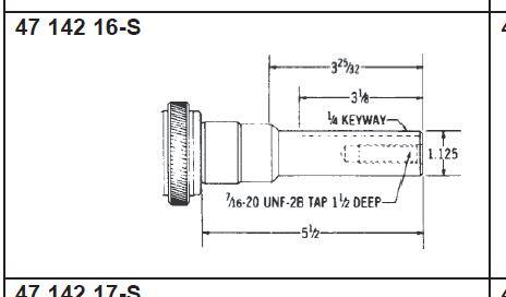

Achto 30,999 #3 Posted March 3, 2023 A generator or water pump engine usually have a tapered shaft on the PTO side. 1 Share this post Link to post Share on other sites
pfrederi 19,879 #4 Posted March 3, 2023 Crank in parts manual comes back as this Share this post Link to post Share on other sites
