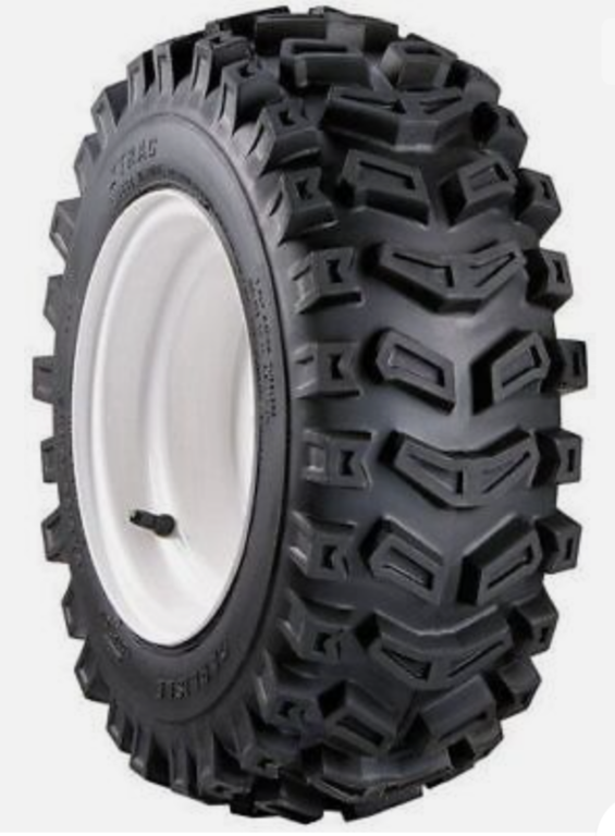

ebinmaine 77,302 #2 Posted March 3, 2023 Non steering while plowing snow is definitely an issue. Trina's 867 Pigpen will barely turn even with chain wrapped tires and some extra weight. I've ordered a set of these: Carlisle X-tracs for the steers on her rig. We'll add more weight. Very likely also fluid fill the tires. Should help a fair amount. 3 2 Share this post Link to post Share on other sites
Achto 30,957 #3 Posted March 3, 2023 14 minutes ago, ebinmaine said: I have these on my C145 snow plow tractor & love 'em . No added weight on the front and very little trouble going where I point it. 4 Share this post Link to post Share on other sites

Lagersolut 793 #9 Posted March 3, 2023 1 hour ago, ebinmaine said: Non steering while plowing snow is definitely an issue. Trina's 867 Pigpen will barely turn even with chain wrapped tires and some extra weight. I've ordered a set of these: Carlisle X-tracs for the steers on her rig. We'll add more weight. Very likely also fluid fill the tires. Should help a fair amount. 1 hour ago, Achto said: I have these on my C145 snow plow tractor & love 'em . No added weight on the front and very little trouble going where I point it. Ditto - I have these on the 416 -8 for snow blowing - they do a great job 2 Share this post Link to post Share on other sites

Achto 30,957 #17 Posted March 3, 2023 7 minutes ago, Mark siebenaler said: What size are they You can get them in most common sizes. 16-6.50 x 8 4.80- 8 6" rim sizes also available. 1 Share this post Link to post Share on other sites
