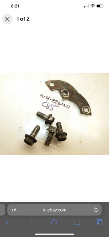

Tonytoro416 1,309 #11 Posted March 1, 2023 1 minute ago, Racinbob said: What retainer are you referring to? What PTO do you have? The little retainer plates. 2 plates four bolts. I’m not sure what PTO it is Thinking it’s from a raider. Dad is wanting to put it on the Tecumseh engine instead of the electric clutch Share this post Link to post Share on other sites

Racinbob 12,765 #13 Posted March 1, 2023 If you're talking the bolts going into the block I doubt it. I would be very surprised if the Kohler and the Tecky were the same. Share this post Link to post Share on other sites
squonk 45,512 #14 Posted March 1, 2023 1/4" flange head bolts.I think 3/4" long Share this post Link to post Share on other sites

Racinbob 12,765 #19 Posted March 1, 2023 15 minutes ago, Tonytoro416 said: Those are the bearing race retainers, They bolt through the clutch plate directly into the block. Like I said, I doubt that they will work on a Tecky but I could be wrong. 1 Share this post Link to post Share on other sites

Lee1977 7,553 #22 Posted March 1, 2023 2 hours ago, Racinbob said: Those are the bearing race retainers, They bolt through the clutch plate directly into the block. Like I said, I doubt that they will work on a Tecky but I could be wrong. Make sure the thickness of the metal clutch plate and the space behind the grove in the bearing race match. They changed the metal thickness on later model clutch plates. A later model clutch plate and older bearing race will destroy the c-shaped retainers. Share this post Link to post Share on other sites
Tonytoro416 1,309 #23 Posted March 1, 2023 Copy that. I’ll have to get a closer look at what he is wanting to use Share this post Link to post Share on other sites
