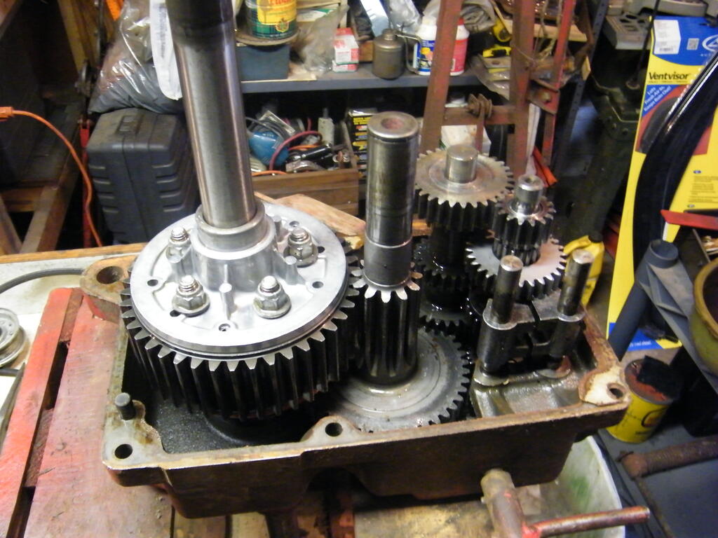

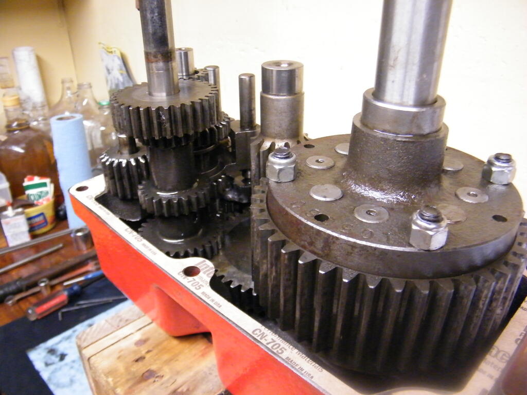

stevasaurus 23,536 #35 Posted February 26, 2023 (edited) The 103916 is an 8 pinion differential and it should bolt right in if you want to open up your other trans...which I would recommend. Did you notice any jamming while turning the wheels...if not...try holding one of the wheels while turning the other one. You may still have a 10 pinion differential, but turning wheels may not really tell you. You really have to open it up to0 know for sure. If you take off the seat and clean all that gear drift out, you will find 2 bolts on top of the transmission. If you shine a light down one hole and look down the other, you may be able to see the differential bolts that hold the differential together. If you see 5 bolts, it is a 10 pinion. If you see 4 bolts it is an 8 pinion. That is your best shot without opening up the trans. You did not answer the question on how long you have owned this horse and if the LS ever worked before. Know that some people have changed out the 10 pinion differential for the 8 pinion differential in the past...for various reasons and can use the same transmission case. 4 bolt differential 5 bolt differential Edited February 26, 2023 by stevasaurus 2 Share this post Link to post Share on other sites

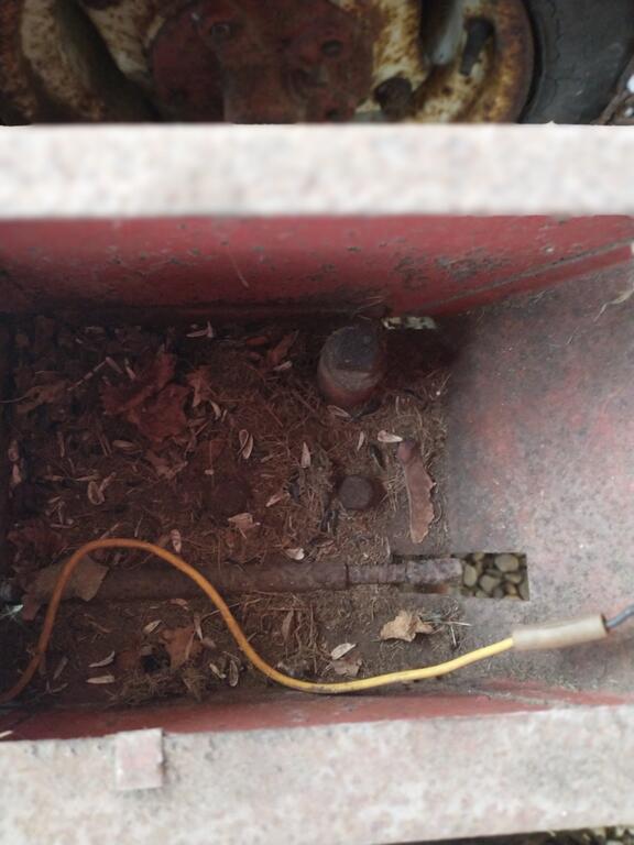

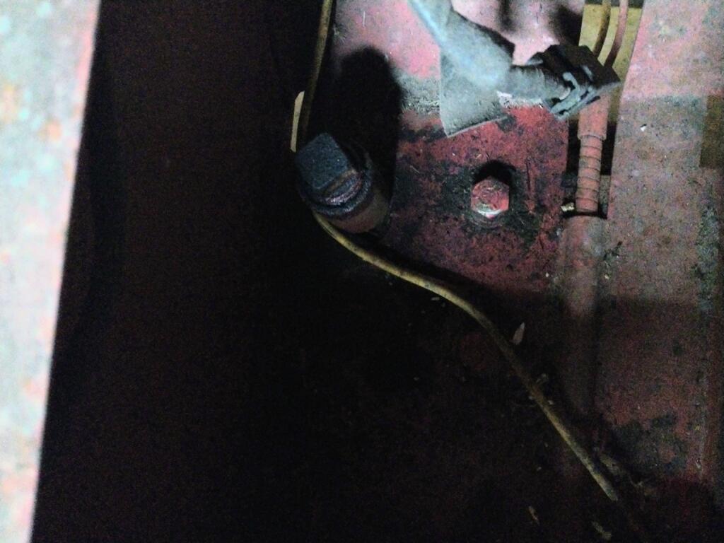

23 Reo 234 #42 Posted March 2, 2023 I pulled the two bolts from the top of the transmission and shined a light in but could not identify anything. I have a 69 Raider 12 that I am not using. The Raider 12 transmission has a huge brake that is very close to the axle and is actuated from the bottom. I think it is a 5060 although it has a tube with a plug on top for oil that is similar to a 5073. I would like to repair my 5073 but could these transmissions be swapped? Share this post Link to post Share on other sites

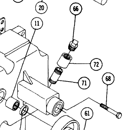

Handy Don 15,671 #43 Posted March 3, 2023 (edited) On 3/2/2023 at 6:00 PM, 23 Reo said: I pulled the two bolts from the top of the transmission and shined a light in but could not identify anything. I have a 69 Raider 12 that I am not using. The Raider 12 transmission has a huge brake that is very close to the axle and is actuated from the bottom. I think it is a 5060 although it has a tube with a plug on top for oil that is similar to a 5073. I would like to repair my 5073 but could these transmissions be swapped? Your Raider might have a 5071, the last of the LSD 6-speeds. Another 6-speed LSD indicator is the extension of the oil fill on the lower left rear behind the axle (parts 71 and 72 in the picture). 5060 and 5071 are direct swappable since their brake system is the same. I have heard of 6-speeds with an oil fill plug at the top, but never seen one. 5073 is a 4-pinion 8-speed without LSD (correction: 10-pinion, LSD, 8-speed with dipstick. 5 March. Thanks for catching this, Steve.) Edited March 6, 2023 by Handy Don 2 Share this post Link to post Share on other sites

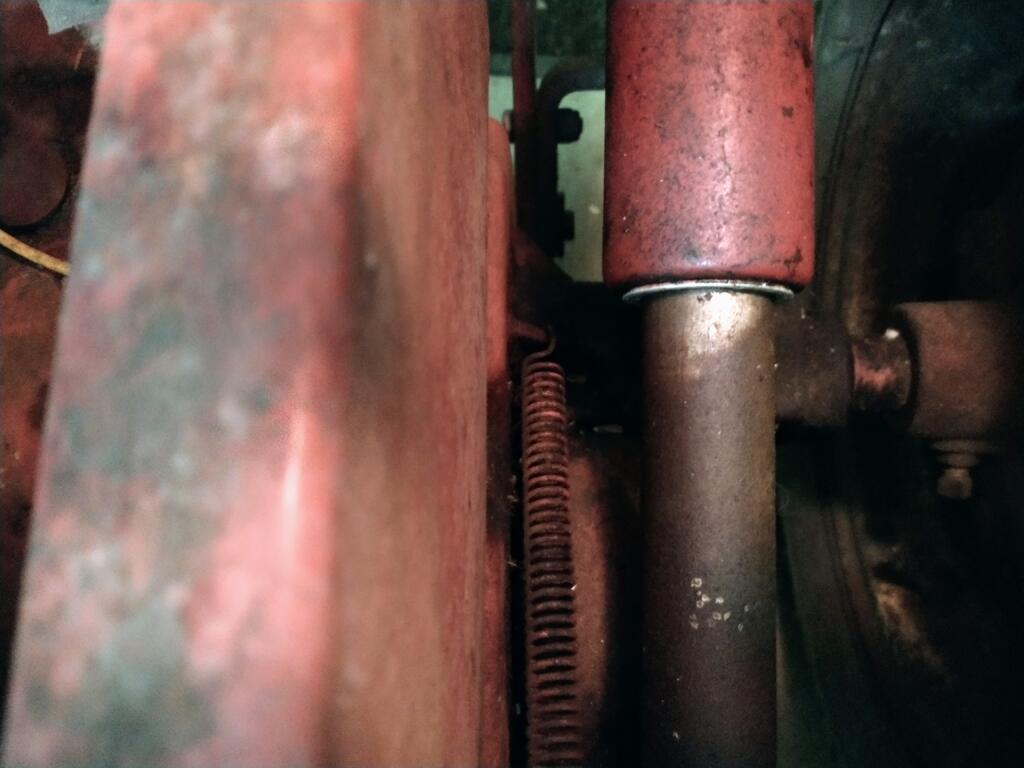

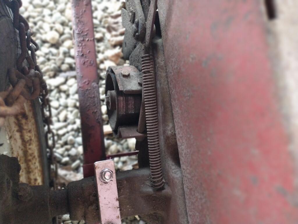

23 Reo 234 #44 Posted March 3, 2023 I'll take some pictures. 1 Share this post Link to post Share on other sites

23 Reo 234 #47 Posted March 4, 2023 This is the trans in my 69 Raider 12. Is it a 5071? Share this post Link to post Share on other sites
stevasaurus 23,536 #48 Posted March 5, 2023 There is really no way to tell at this point in history. It depends on when you bought it, if you knew who had it before you, if someone bought it to flip, and any other scenario you can think of. It comes down to this...YOU HAVE TO OPEN IT UP TO COUNT THE BOLTS HOLDING THE DIFFERENTIAL TOGETHER...5 IS A 10 PINION LIMITED SLIP...4 BOLTS IS AN 8 PINION. IT REALLY IS THE ONLY WAY TO TELL ANY MORE, BECAUSE SOMEONE COULD HAVE CHANGED WHAT IS IN THERE. Yes, I am yelling at this point. Show me a picture of your differential and I will tell you what you have. 1 Share this post Link to post Share on other sites
