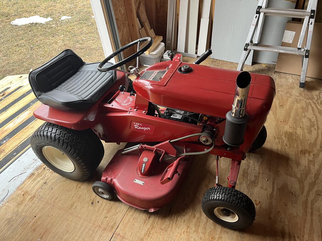

Heavyhand 11 #1 Posted February 23, 2023 Hey guys! New to the forum. Restoring a 1967 Lawn Ranger with a H60. The laminates on the bullhorn are bad and I need a good working unit. Does anyone have a source that might have new in box? I know it is a long shot, but thought I would ask 5 Share this post Link to post Share on other sites

Heavyhand 11 #3 Posted February 23, 2023 Thank you. No spark on her. Needs a new stator assembly. I would take a flywheel also if anyone has one! 2 Share this post Link to post Share on other sites
Terry M-(Moderator) 2,293 #4 Posted February 23, 2023 Could it just be a bad coil? 1 Share this post Link to post Share on other sites
Heavyhand 11 #5 Posted February 23, 2023 (edited) Coil tested good. Condenser tested good. Good ground. Points replaced. Took it in to get a second opinion and they came up with the same thing. Previous owner sanded the laminates on the stator ruining it. Mags on flywheel ok also. It puts out spark, it is not enough volts to run. Edited February 23, 2023 by Heavyhand Grammer 2 Share this post Link to post Share on other sites
