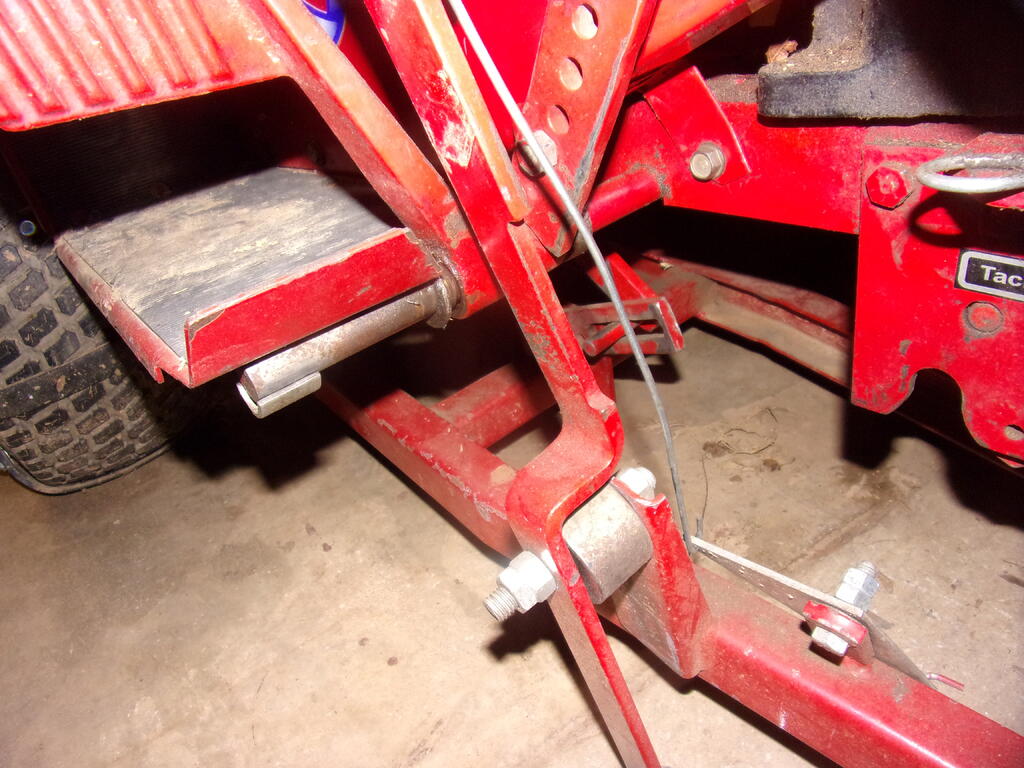

Ed Kennell 41,910 #4 Posted February 20, 2023 Sometimes turning the lever around on the pivot bolt works. You just have to move the lever in to clear the pedal. It may require reshaping the lever. Here is an example of the changes I made to get the blade angle lever to clear the motion pedal. 2 Share this post Link to post Share on other sites

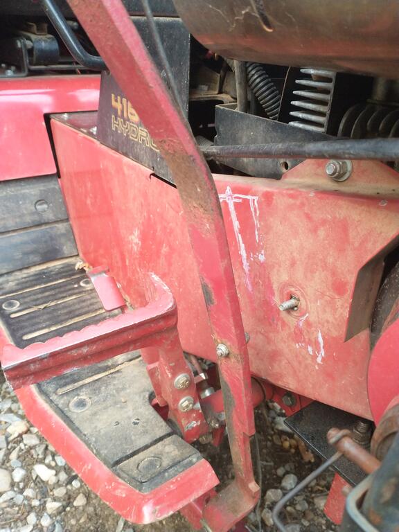

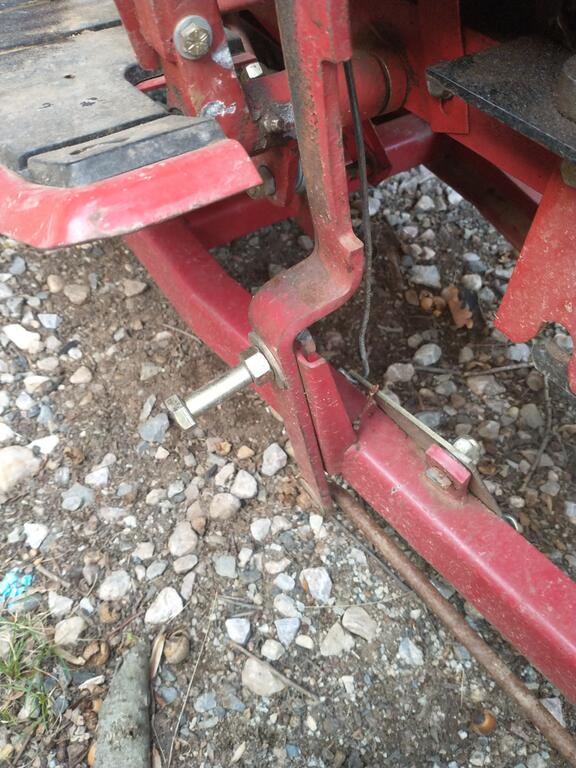

rmaynard 16,292 #5 Posted February 20, 2023 (edited) 52 minutes ago, dkg520 said: It seems that with the angle lever pulled back in its furthest position you can not push the foot lever forwards even a small amount without them coming in contact with each other. I have the same setup on my 416-H, and I had the same problem. I found that if I lowered the blade a little from it's full UP location, the problem was lessened. I also reshaped the angle lever. Here are some differences between yours and mine. Your lever needs to be mounted against the frame. Then bend the angle lever out to miss the muffler. Edited February 20, 2023 by rmaynard 1 1 Share this post Link to post Share on other sites
