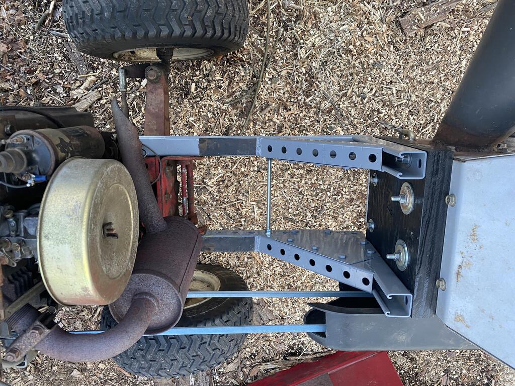

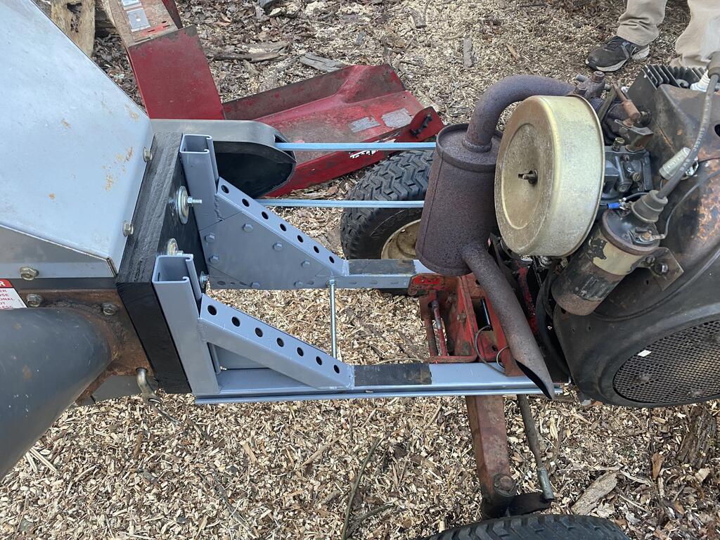

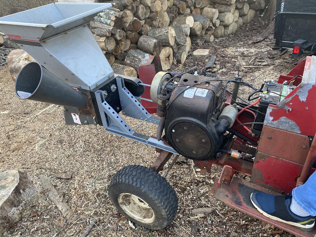

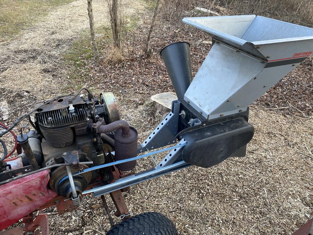

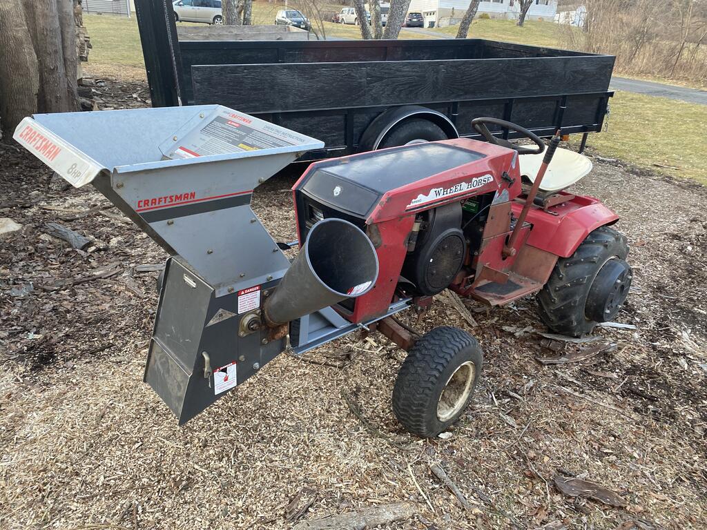

formariz 12,351 #1 Posted February 20, 2023 My son got tired of replacing Tecumseh engines on our shredder and hauling it around. So he removed all unnecessary parts and adapted it to a tractor. I had this C-125 under a tarp for the last five years so I donated it to be a dedicated shredder tractor . Very appropriately he named it the Craftyhorse. 7 19 Share this post Link to post Share on other sites

Retired Wrencher 6,109 #6 Posted February 20, 2023 Great job on the conversion. May be make a belt guard. Always good to have more tractors to do these kinds of jobs. 1 Share this post Link to post Share on other sites

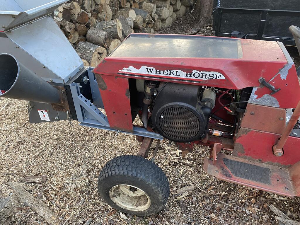

formariz 12,351 #11 Posted February 20, 2023 4 hours ago, Pullstart said: Ingenious Cas! Looks plenty stout too! Thank you but the credit goes to my son. He had the idea I just donated the tractor. This will be also the tractor he will use on the property moving trailers around with firewood. The permanent front weight on it will improve the steering in those situations. 4 hours ago, squonk said: I got a little hitch on mine. So here is the full story on how it came to be. I had one just like yours for 35 years. Probably the best machine I ever owned. Had a Briggs engine. One day about a year ago while being used there was a real big bang where it actually jumped off ground. It stopped and upon inspection he realized the whole impeller assembly actually bent. So then he took the other one I had here also a Craftsman but larger. Always had trouble with that engine and could never really fix it. It always wanted to over rev. Shure enough soon after rod broke through block. He realized that engine from old one although less horse power fit perfectly on it. Changed it . Soon after it also was turning too fast. Something with governor got stuck inside. Not wanting to deal with it anymore decided to attach it to a tractor that would not only have a reliable engine but also made it easier to deal with moving and storing unit itself. That is when I volunteered a tractor that I did not need anyway. 2 5 Share this post Link to post Share on other sites
ebinmaine 74,971 #12 Posted February 20, 2023 1 hour ago, formariz said: This will be also the tractor he will use on the property moving trailers around with firewood. The permanent front weight on it will improve the steering in those situations. Excellent idea. I do the same with my Cinnamon Horse C160. Having the great big chipper shredder out front lends a hand to towing capacity for sure! 1 Share this post Link to post Share on other sites
