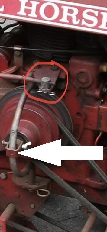

Sparky-(Admin) 26,547 #4 Posted February 18, 2023 1 hour ago, gris71 said: I dont know how to adjust the clutch You add tension by turning this trunion, closer to the PTO handle, a little bit at a time. 2 1 1 Share this post Link to post Share on other sites

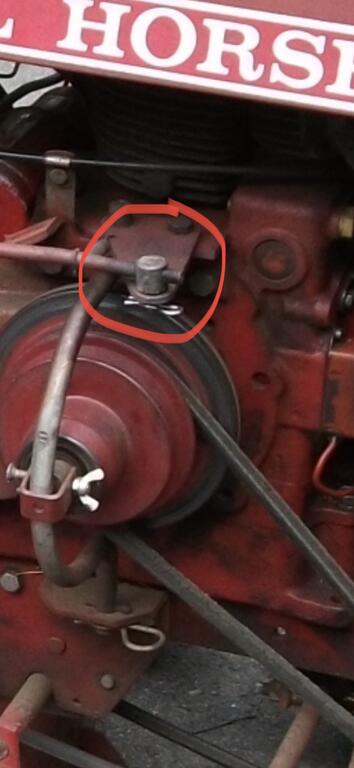

wallfish 20,697 #6 Posted February 19, 2023 Also inspect this area and the bracket. There should be a pin holding it on which is common to fail after 30-40 years. If it's not attached correctly you can't adjust enough. Post a pic of yours so we can see it 3 1 Share this post Link to post Share on other sites
