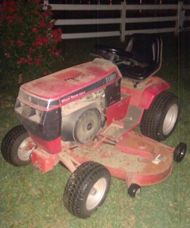

kpinnc 18,778 #26 Posted March 1, 2023 (edited) I think I'll bring you my 520-H for one of your "clean ups"... You can call it number 6! That thing looks like a restore in my book! Edited March 1, 2023 by kpinnc 4 1 Share this post Link to post Share on other sites
lynnmor 8,941 #27 Posted March 1, 2023 27 minutes ago, kpinnc said: That thing looks like a restore in my book! Looks like a candidate for soap and water to me. Hard to tell what is under there. 2 Share this post Link to post Share on other sites
kpinnc 18,778 #28 Posted March 1, 2023 (edited) 26 minutes ago, lynnmor said: Looks like a candidate for soap and water to me. Hard to tell what is under there. That's after a day mowing when it was dry. Definitely dusty! Makes the "dry dusty conditions" comment in the service manual make more sense. It always gets a wash down after it cools. Maybe not soap every time, but the dust gets knocked off. Better than my FILs Charger after getting up leaves. It was solid dirt- no visible red whatsoever. He stops at least twice while working just to clean the air filter out. But his engines are always pristine. Edited March 1, 2023 by kpinnc 4 Share this post Link to post Share on other sites
Lee1977 7,724 #29 Posted March 2, 2023 They don't know how dry it gets down here in July, August and September. 1 Share this post Link to post Share on other sites
kpinnc 18,778 #30 Posted March 2, 2023 44 minutes ago, Lee1977 said: They don't know how dry it gets down here in July, August and September. I've heard it described as "dry as a popcorn fart", whatever on earth that is... 1 3 Share this post Link to post Share on other sites

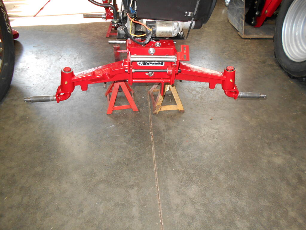

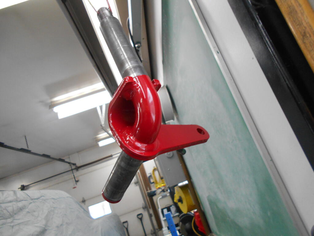

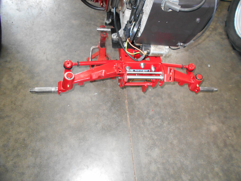

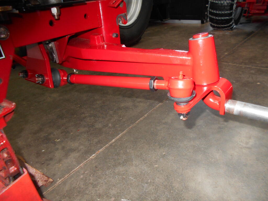

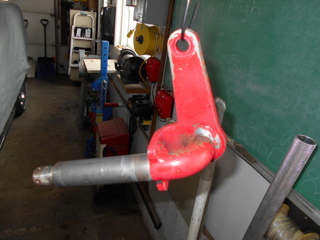

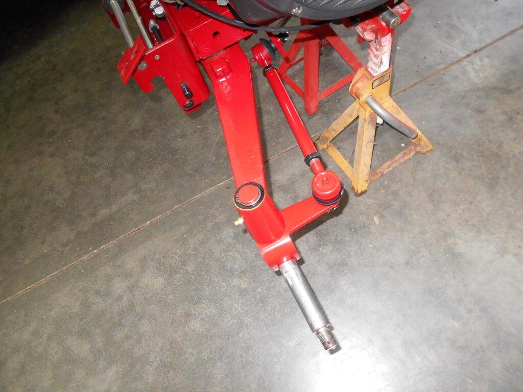

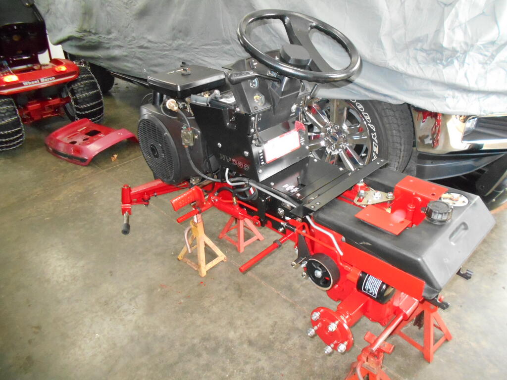

cleat 9,069 #32 Posted March 3, 2023 Front spindles cleaned up then painted. How they looked when just de-greased. Cleaned up and painted. Installed with cleaned and greased thrust bearings. Tie rods installed and a preliminary alignment completed. 1 4 Share this post Link to post Share on other sites

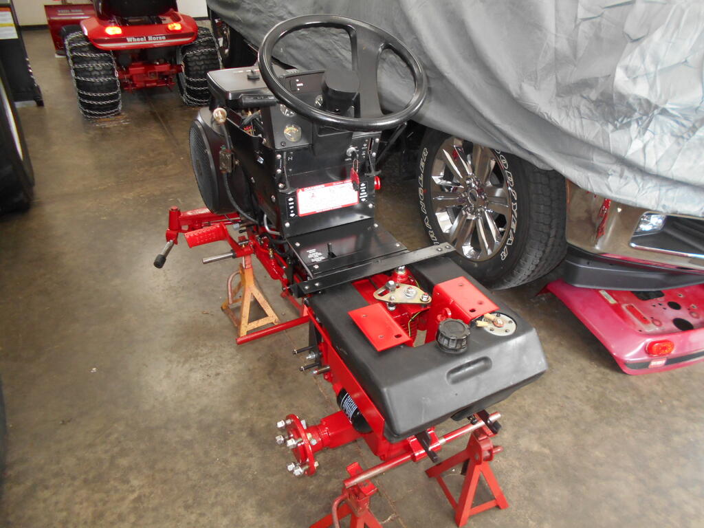

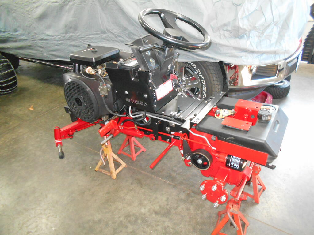

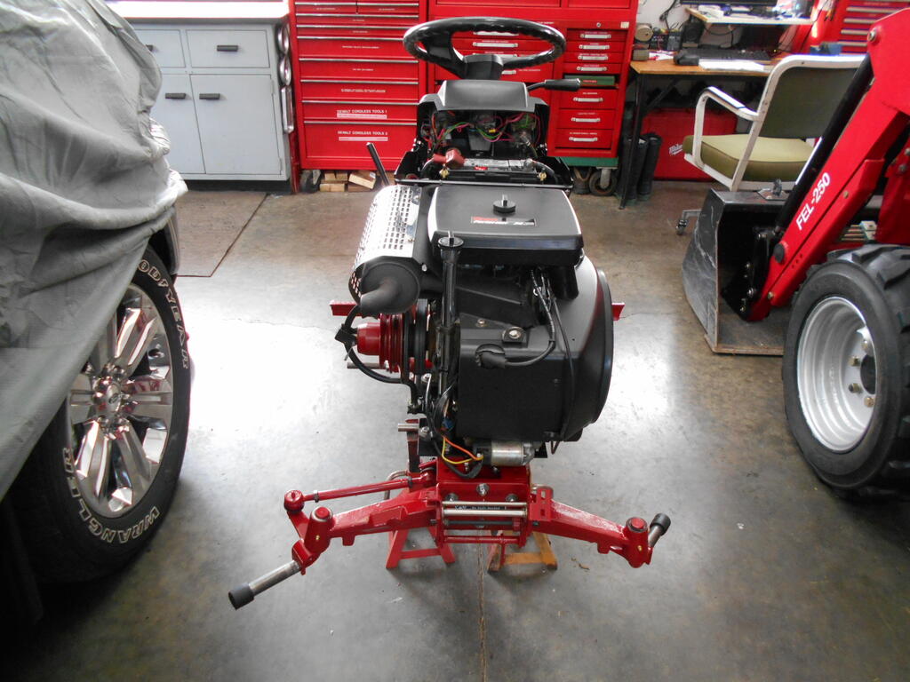

cleat 9,069 #33 Posted March 3, 2023 Air filter assembly installed. Vertical cover plate installed. Tunnel cover plate just sitting in place. Next up are the wheels but I need more warmer weather so I may be done for now. 4 4 Share this post Link to post Share on other sites

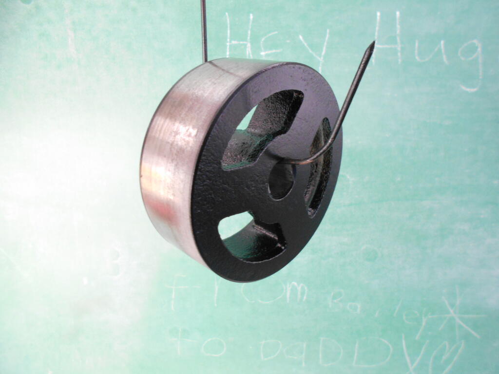

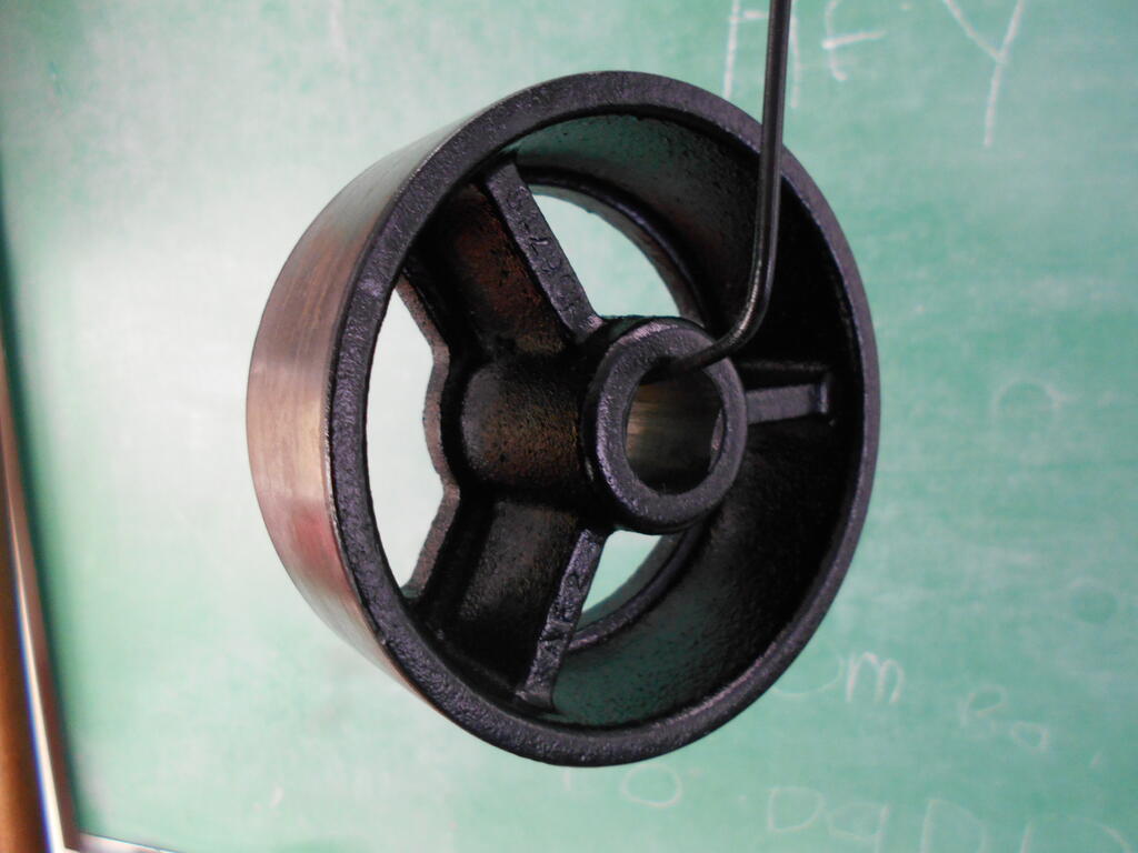

cleat 9,069 #34 Posted March 6, 2023 Finally got a warm enough day to get my bead blast cabinet out. It is a little bench top unit that i sat on two saw horses out in the snow. Cleaned up the brake drum. I am sure wheel horse never painted these. Do not have a before pic but it was rusty except where the brake band kept it shined up. It cleaned up nicely and got a couple coats of semi-gloss black. Brake shaft is cleaned up as well. I will let the paint dry for another day or two then assemble. 5 2 Share this post Link to post Share on other sites

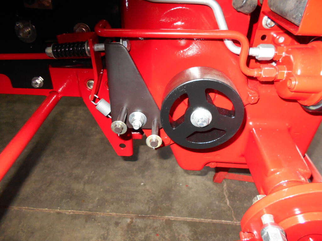

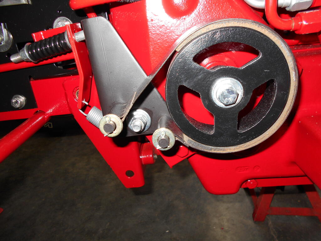

cleat 9,069 #35 Posted March 7, 2023 Brake drum installed. Brake band installed and adjusted as per manual. Side view showing progress to date. 4 4 Share this post Link to post Share on other sites

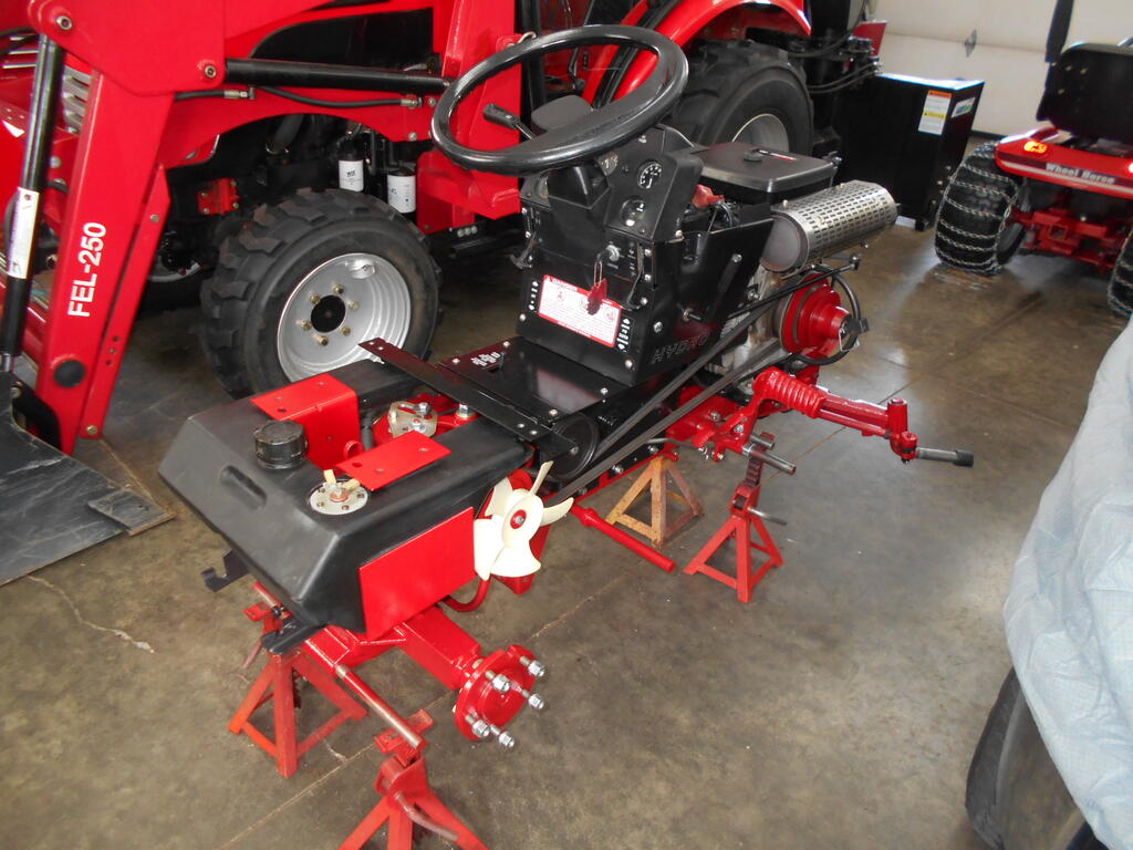

Handy Don 17,073 #36 Posted March 8, 2023 On 3/7/2023 at 9:08 AM, cleat said: Brake drum installed Wow, that is nice work. If I had a tractor that spiffy, I’d never want to get it dirty. Hence, none of mine will ever look like that. Noticing the clever support of the rear end. Somewhere on the forum is a slide show of the final WH production run. it shows the tractors moving down an overhead track assembly line suspended at the front by the attach-a-matic and the rear by the transaxle hitch pin hole! 2 Share this post Link to post Share on other sites
cleat 9,069 #37 Posted March 8, 2023 Yes, i went through that slide show as well and it gave me some ideas. Nice to be able to work on the tractor and/or paint it with basically nothing in the way. The 3/4 rod is old valve handles from my days working at a chemical plant. 2 Share this post Link to post Share on other sites

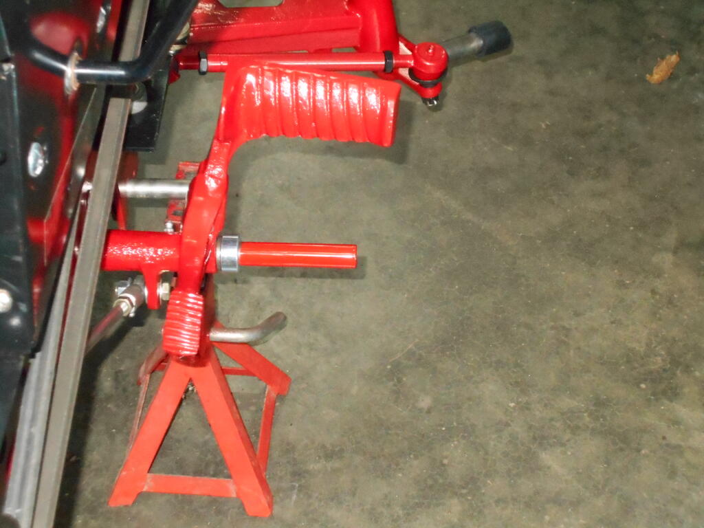

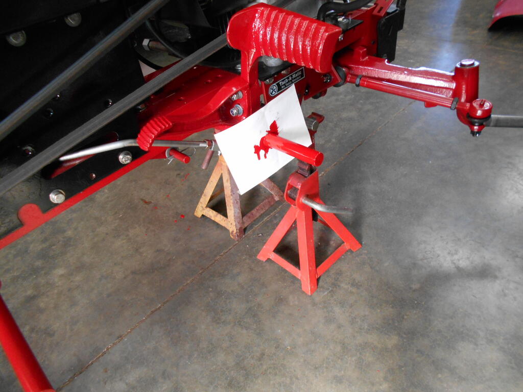

cleat 9,069 #39 Posted March 10, 2023 Another small but important step complete. Brake and foot motion control pedal shafts were left as bare steel for pedal installation. I punched 3/4" holes in pieces of heavy paper to act as a painting guide. Shafts were then given 2 coats of self priming paint using a foam applicator. After drying overnight I cut the paper and carefully removed it from the shafts. This is how the tractor looks now. I will give this paint a few days to dry before installing the footrests. 3 2 Share this post Link to post Share on other sites

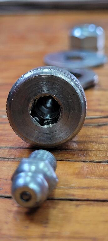

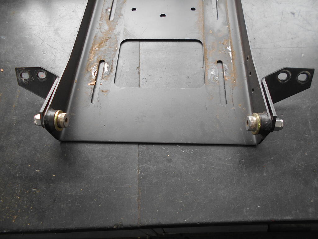

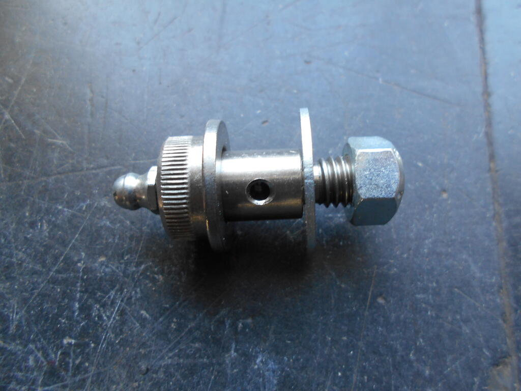

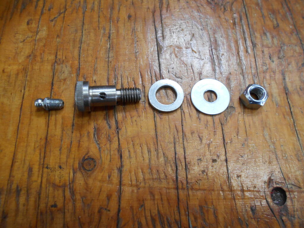

cleat 9,069 #41 Posted March 10, 2023 I have begun work on the seat mount pivot plate. I modified this one a few years ago as it was badly worn. Spacers were welded in and stainless steel shoulder bolts used as pivot bolts. When it was disassembled I found the spacers to be rusty. Well that won't do so I drilled and tapped the shoulder bolts to accept grease fittings and drilled a cross hole to direct the grease to the center of the spacer. A shot of grease now and then should prevent rust. Just need a warmer day for sand and paint of the seat pivot plate, mounting brackets and springs. 2 1 Share this post Link to post Share on other sites

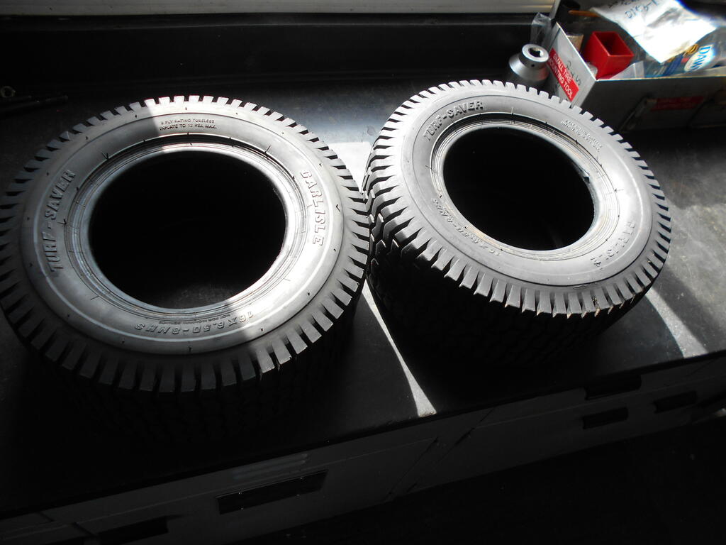

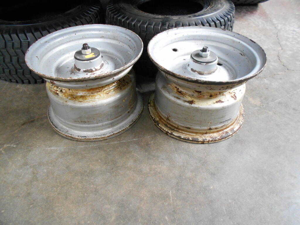

cleat 9,069 #42 Posted March 10, 2023 Removed front tires from wheels. These had tubes which are now inflated and being checked for leaks. They held air before being removed, I just want to be sure I did not damage them during tire removal. Next warm day I will clean and paint these wheels. Hopefully tires and tubes will be re-used. 2 1 Share this post Link to post Share on other sites

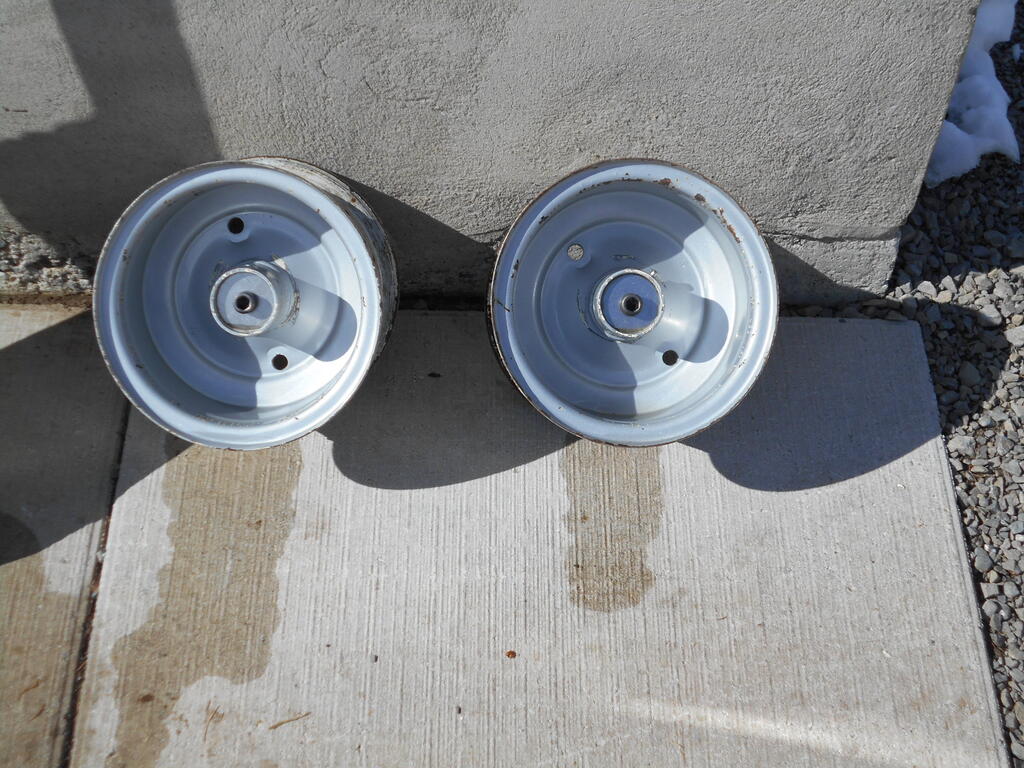

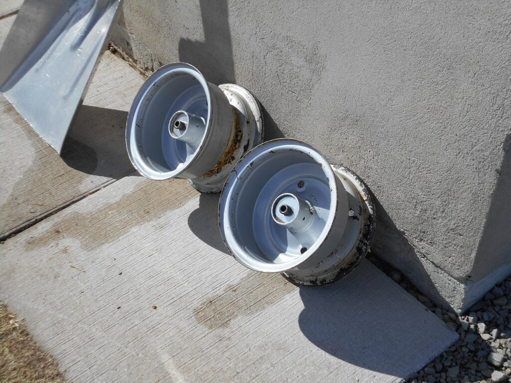

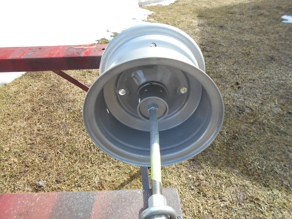

cleat 9,069 #43 Posted March 11, 2023 Well it got just above freezing today so good day to do some wheel degreasing and washing. You can see the wash sink I use just behind the house using a short hose that I keep inside and drained. Not warm enough yet for sanding and paint however. 3 Share this post Link to post Share on other sites

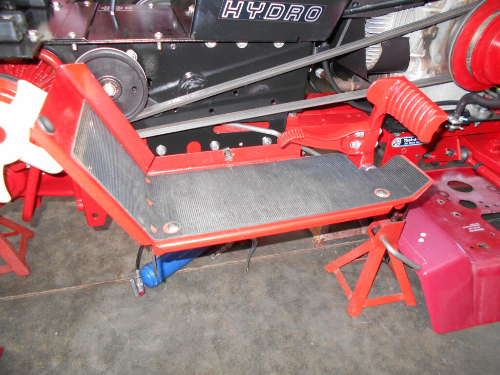

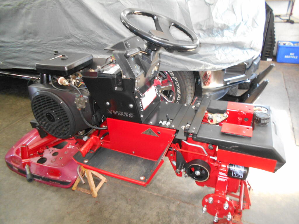

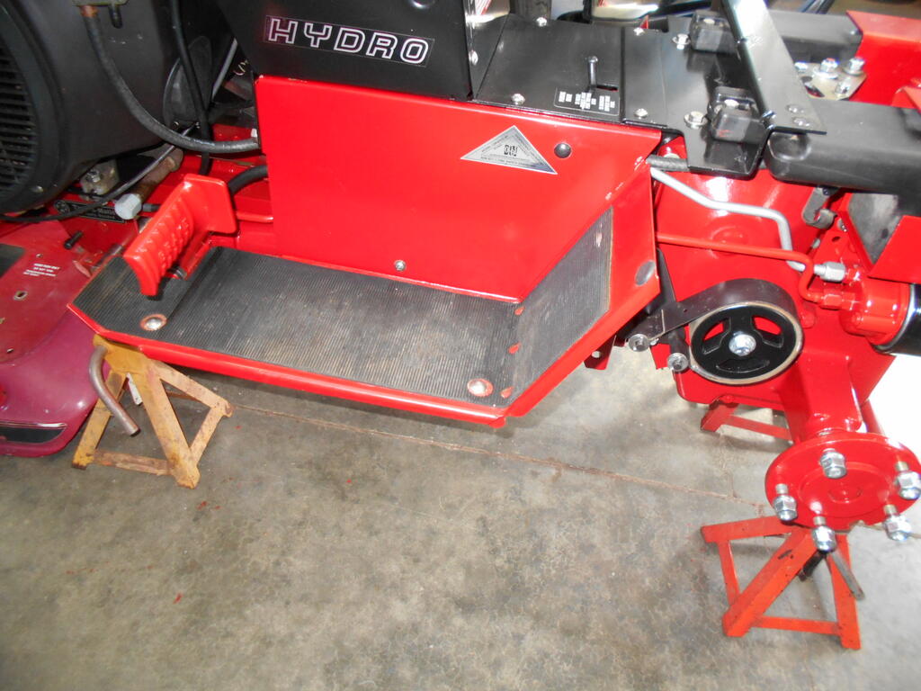

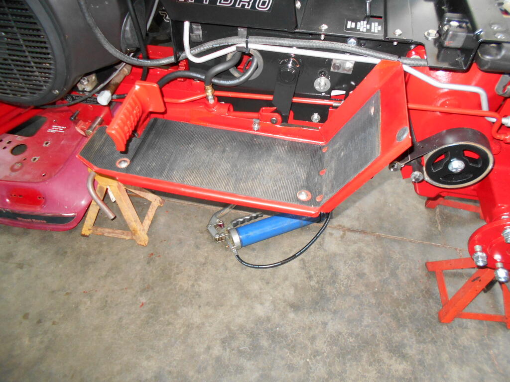

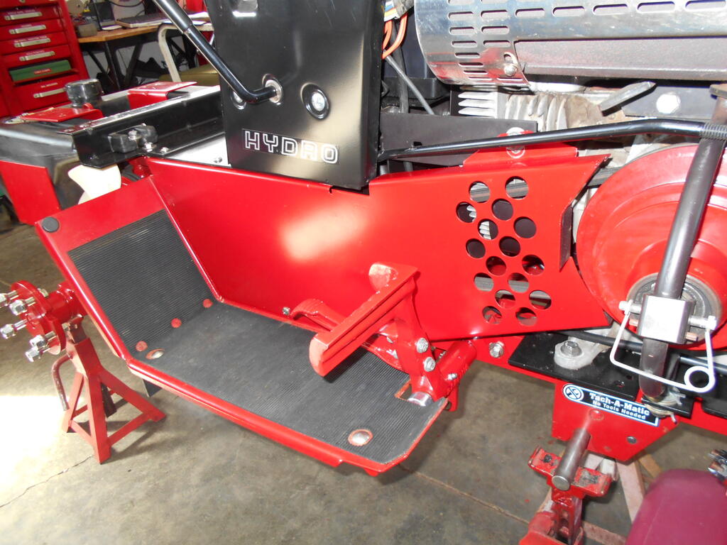

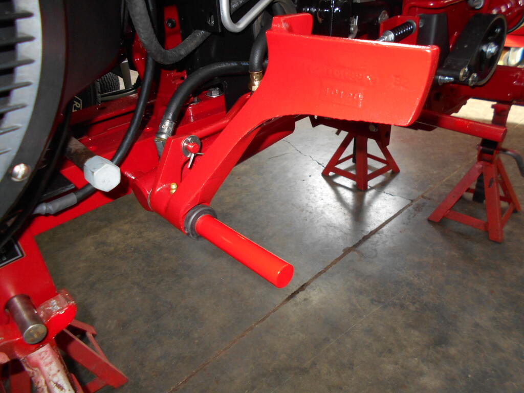

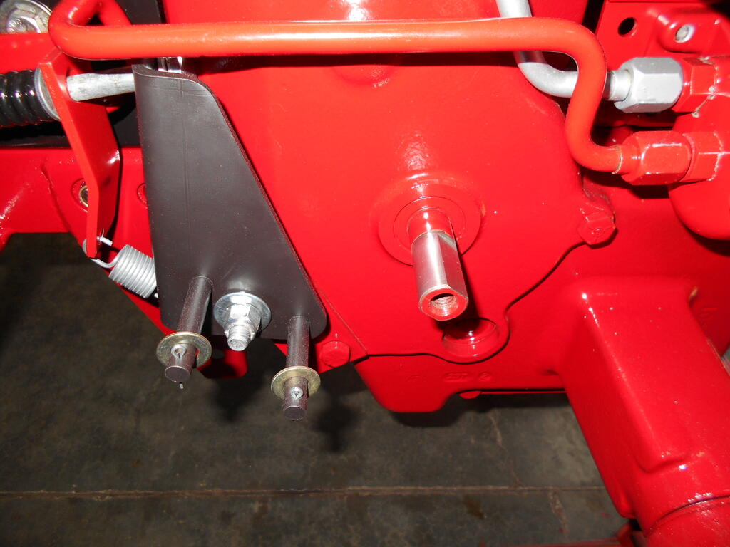

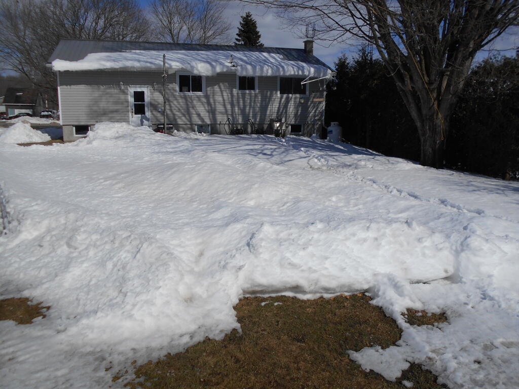

cleat 9,069 #44 Posted March 15, 2023 Well, we got another 6-8" of snow yesterday so the 520HC got to work with the blade and cleaned that up today. After that I installed the right side foot rest then set the foot control pedal height and locked it in place. Right side cover then installed. Left foot rest then installed. Left side cover installed. The covers and foot rests were previously painted so just got re-installed as-is. 1 3 Share this post Link to post Share on other sites

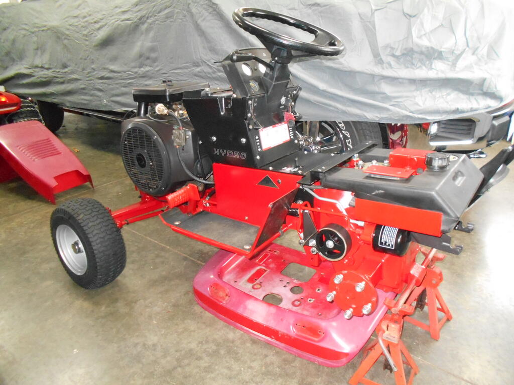

cleat 9,069 #45 Posted March 15, 2023 This is how she looks as of today. Hopefully all this snow soon melts so I can move on to the rest. 2 3 Share this post Link to post Share on other sites

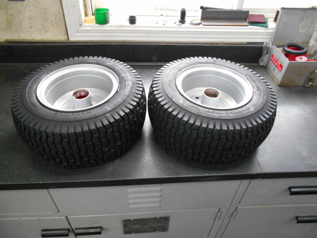

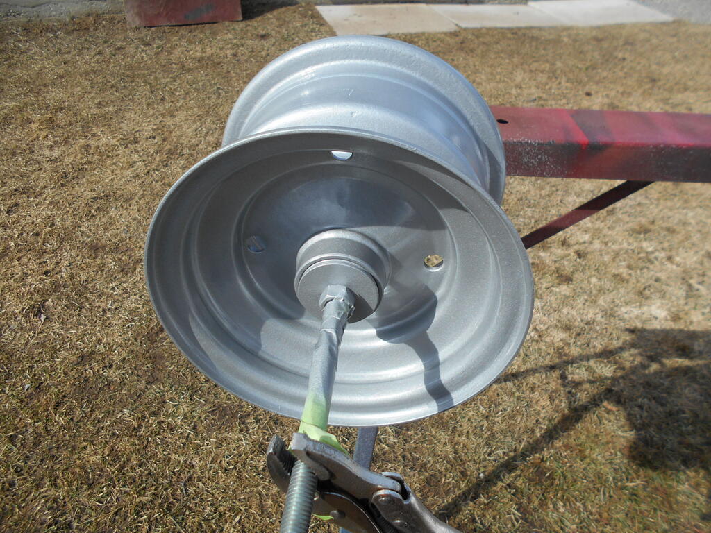

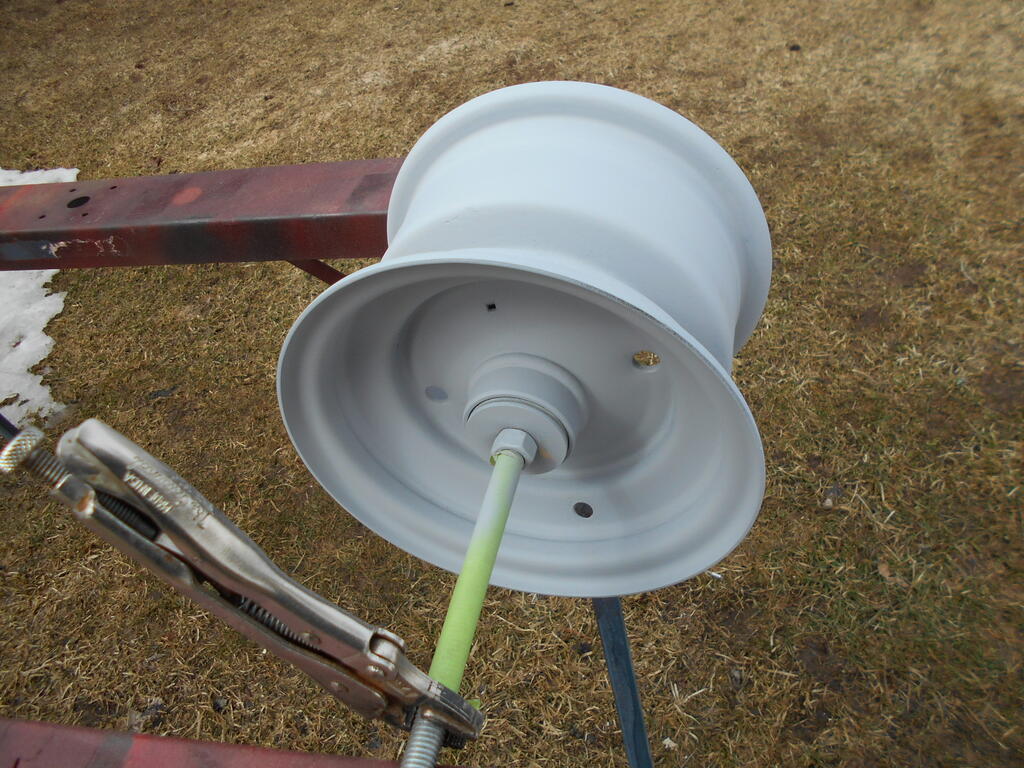

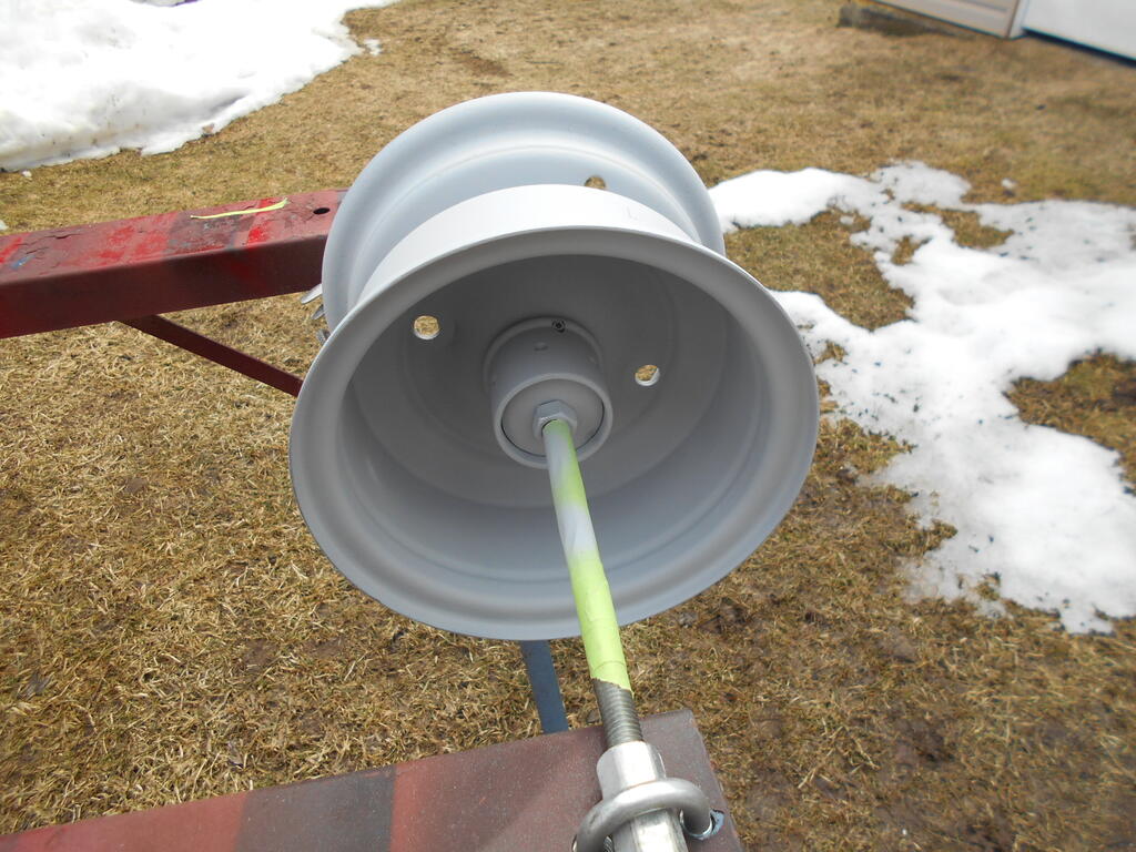

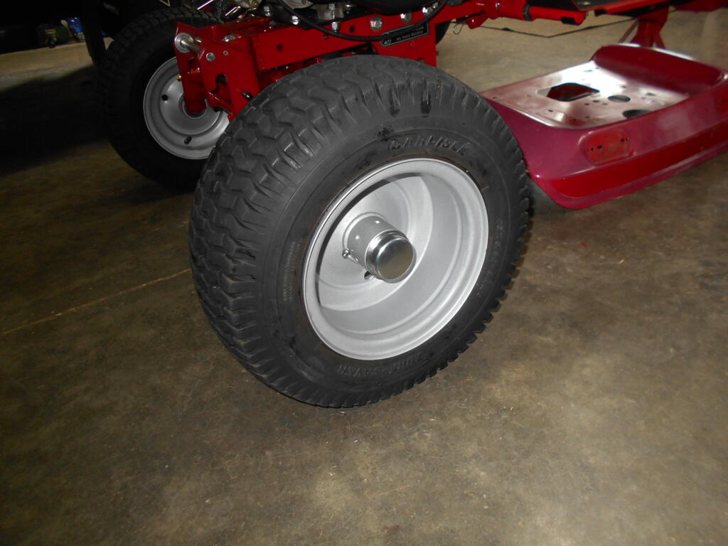

cleat 9,069 #49 Posted March 22, 2023 Well it got up to plus 2 degrees C today so I got the front wheels wire brushed, sanded, and painted today. Wheels in primer. 2 coats of silver paint. Tires cleaned up. I will give the paint a few days to dry then re-assemble. 1 5 Share this post Link to post Share on other sites

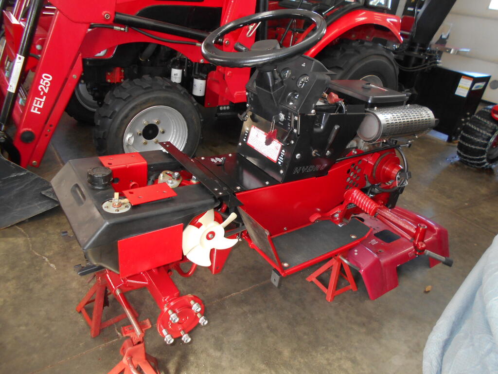

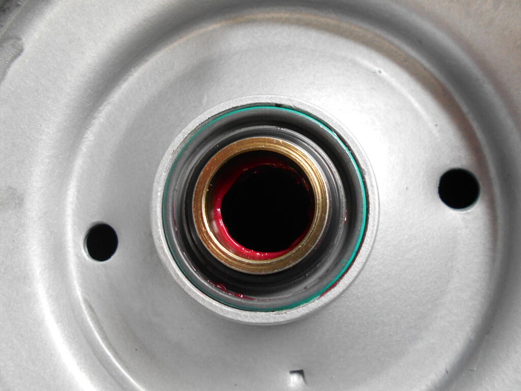

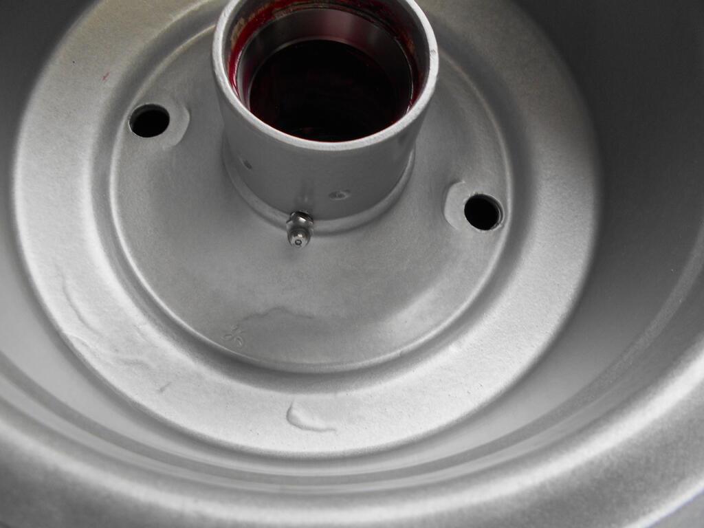

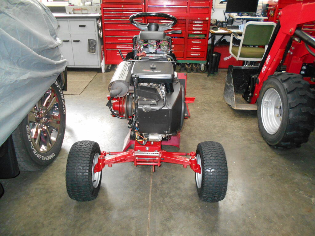

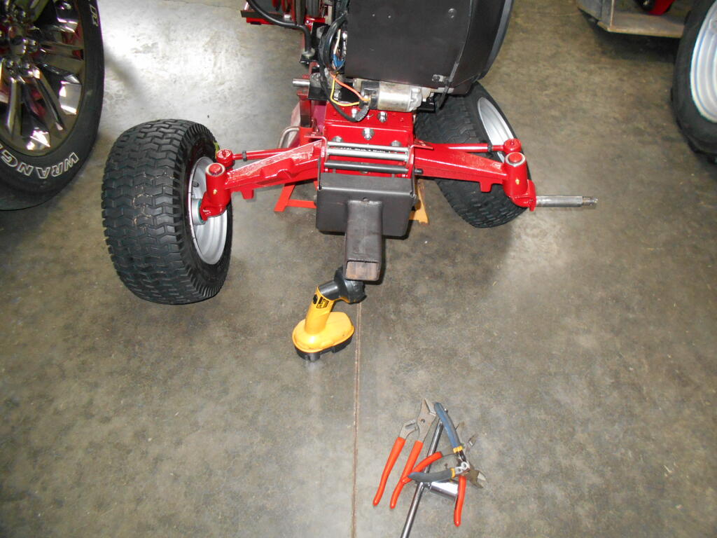

cleat 9,069 #50 Posted March 25, 2023 Tubes and tires installed onto wheels. Grease fittings installed. Inner bearings cleaned, packed with grease then installed. Grease seals installed and spacer inserted. One front wheel installed. Both front wheels installed, grease pumped in then dust caps installed. Overall view of progress to date. 5 2 Share this post Link to post Share on other sites
