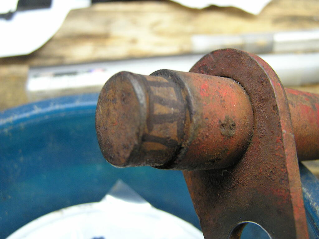

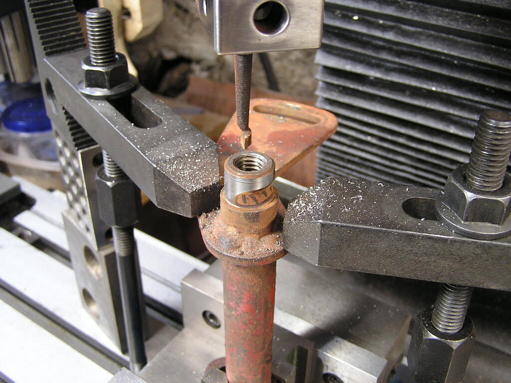

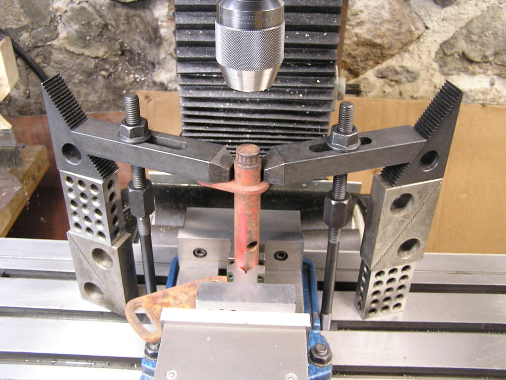

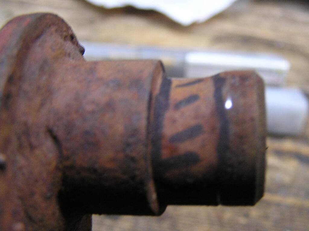

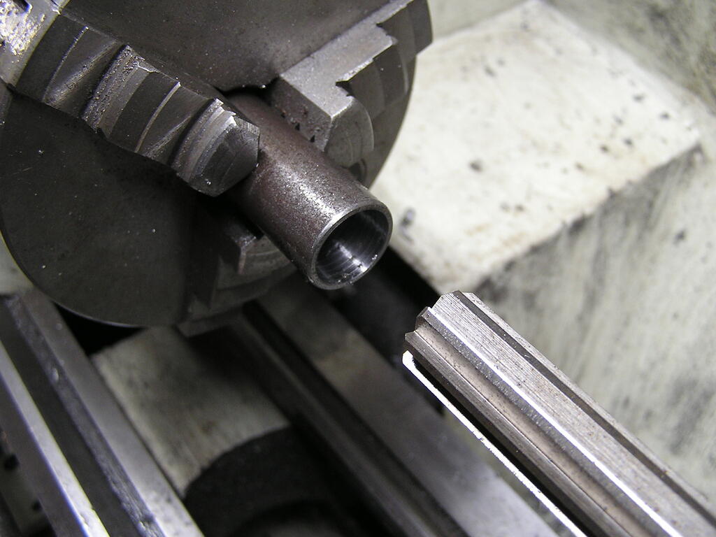

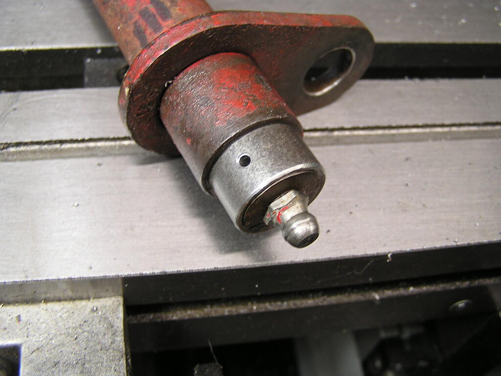

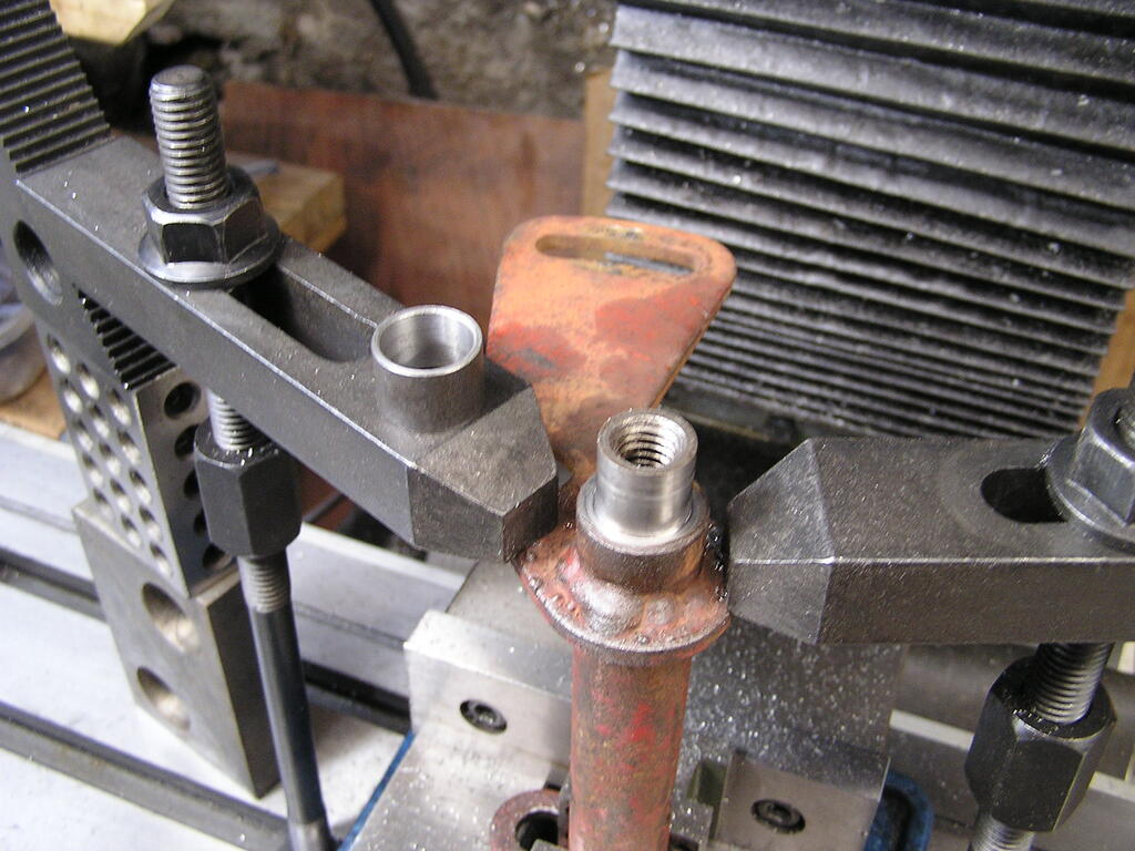

ri702bill 10,809 #1 Posted February 16, 2023 Any of us that use a 32 or 26 inch Gear Drive Rotary Mower will be very familiar with the excessive wear the Hitch Shaft ends get over time. I decided to repair and upgrade this latest one. The plan was to cut down both ends to accept a thin wall 4140 press fit sleeve in the lathe. I made the sleeves in the lathe, but the belt tensioner arm was too long to allow it to get a full swing in the lathe. Moved over to the milling machine and went Old School, using a boring head with the bit reversed to do external cuts. Got about .001 press fit - a bit of red Loctite, good to go. Drilled for a grease fitting and cross drilled a .080 hole. Have yet to do the other end. Total cost (except for the electric bill) was Zero had everything I needed in stock. Bill 2 6 Share this post Link to post Share on other sites

ri702bill 10,809 #3 Posted February 16, 2023 The other choice was to braze or mig weld up the worn areas and then spend way too much time with a Dremel or a bastard file..... Share this post Link to post Share on other sites
