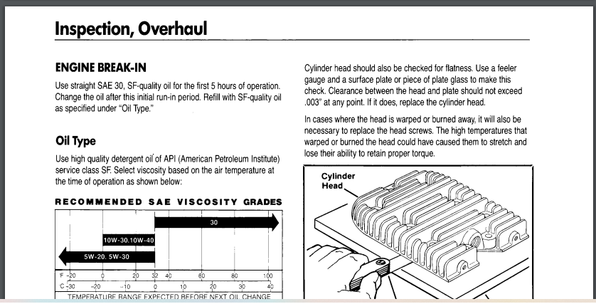

Wheelhorse#1 1,901 #1 Posted February 14, 2023 Anyone know the proper break in procedure on a rebuild, Kohler K series ? Share this post Link to post Share on other sites
rmaynard 16,992 #2 Posted February 15, 2023 Straight from the Kohler rebuild manual. 5 Share this post Link to post Share on other sites
953 nut 64,650 #3 Posted February 15, 2023 Also you should retorque the head bolts after the first time you run the engine up to operating temperature. 2 1 Share this post Link to post Share on other sites
