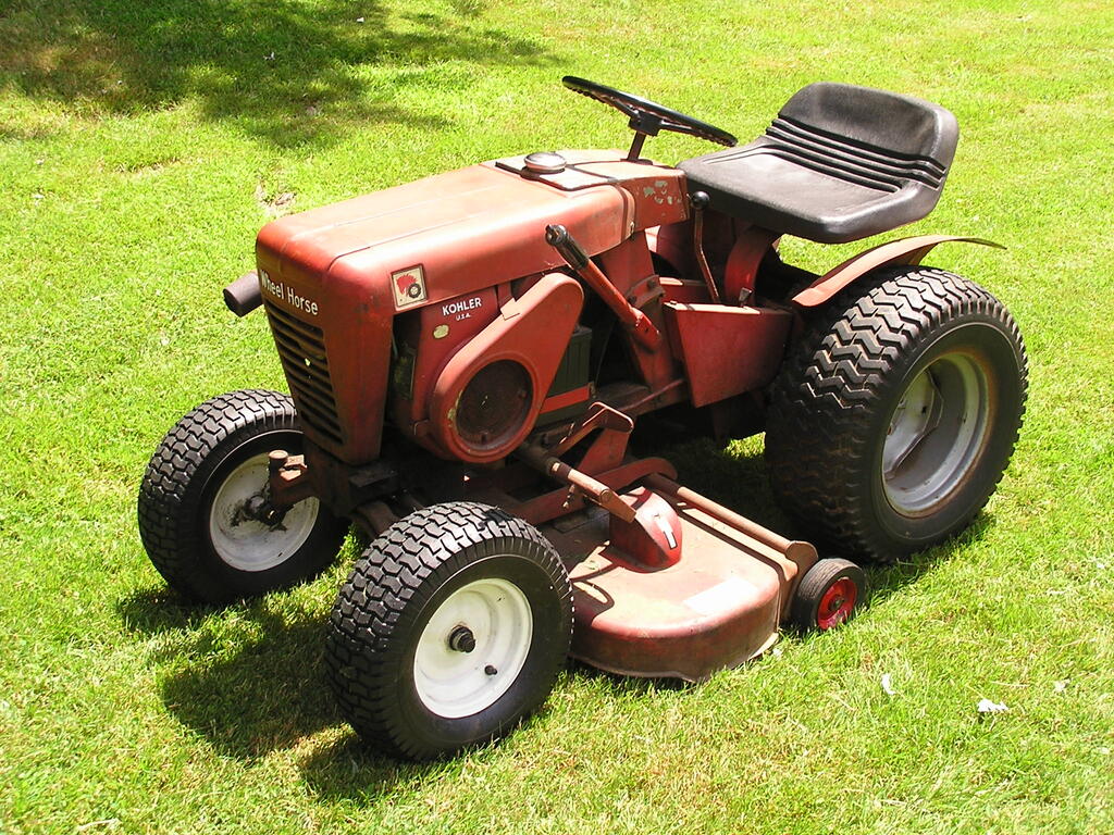

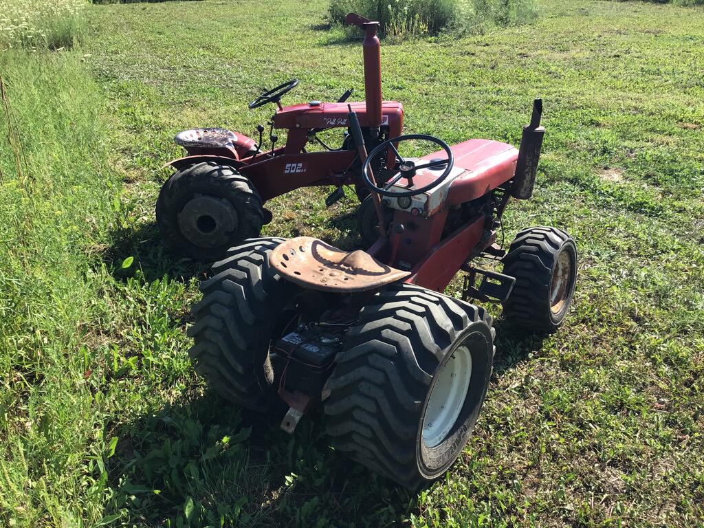

Pullstart 68,203 #7 Posted February 13, 2023 Well… there’s plenty of room for a larger tire on a round hood if that’s what you’re asking. As for fitment without modification, if the wheel doesn’t quite fit the spindle, I believe you can swap the spindles as well onto the 704. It ‘63, the “new” front axle design came out, lasting practically forever. 2 Share this post Link to post Share on other sites
