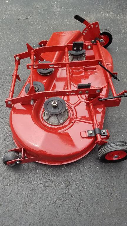

Brockport Bill 1,933 #7 Posted February 13, 2023 bought my 37 s.d. mower with my 312-8 in 1989 - - always loved using over 33 years -- great efficient cut and manuverable -- wonderful with bagger system for leaves - - never had any serious rot or rust but i reach underneath and putty knife clean grass chunks after each use and power wash every 4-5 cuts - i did choose to have it professionally sand blasted and primed and painted a year ago -- came out awesome - - Good for another 20 years !!! Occaisionally had a belt rollover and twist -- but usually happened only after belt was worn and got loose from wear - I just learned to keep pto mule properly adjusted and replace belt when worn so it rides in pulleys properly Share this post Link to post Share on other sites
